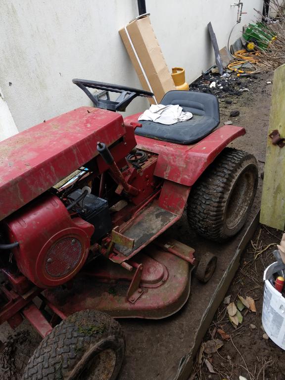

Slopes 4 #1 Posted April 14, 2018 Hi all, Picked up a wheelhorse mower. I need help with the model. Also I have got it running. Very rough but it cuts out after a couple of minutes of running. I have cleaned the carb and fitted new fuel filter. I think the choke cable and throttle is not set up right. Thanks. 2 Share this post Link to post Share on other sites
gwest_ca-(File Mod) 12,483 #2 Posted April 14, 2018 Can see the ID plate in the 2nd photo. It is on the left side below the fuel tank tray and above the lift lever. Should have the model number and serial number on it. Garry 2 Share this post Link to post Share on other sites

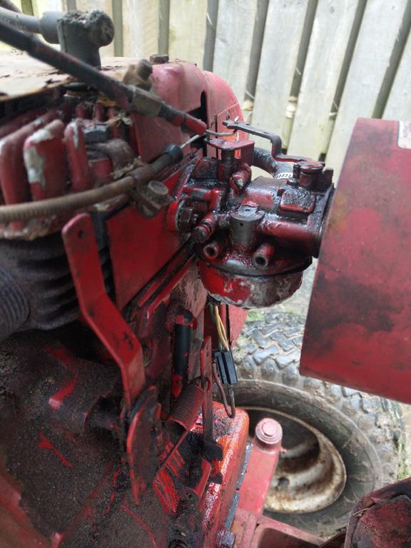

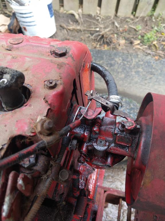

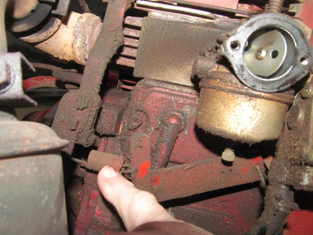

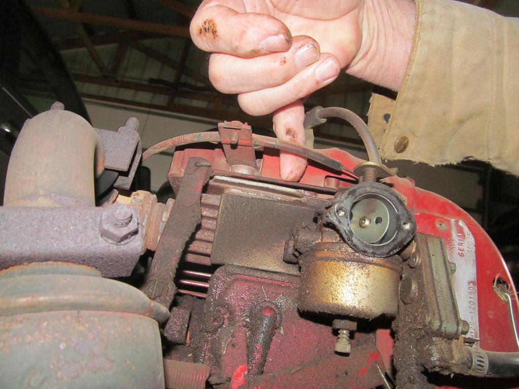

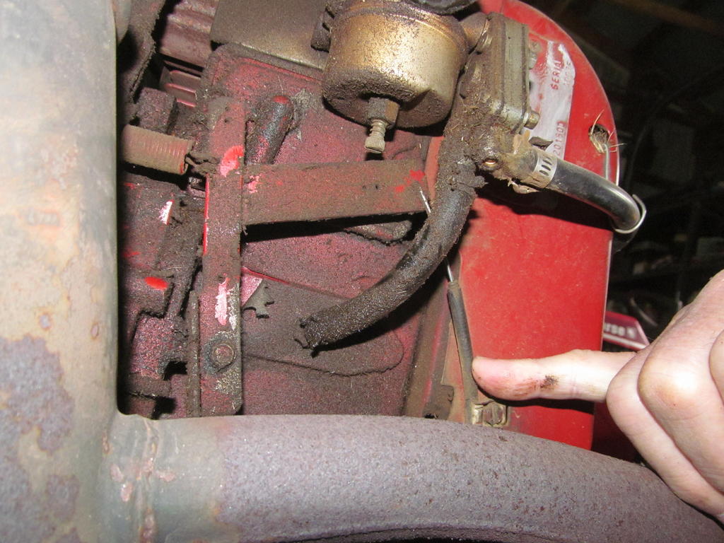

Ed Kennell 47,250 #6 Posted April 14, 2018 (edited) My guess....1968 Commando 6 4 speed w/ Tecumseh HH60 M/N 1-4631 ? Can you post a picture of the carb linkage? Oh, and to the Edited April 14, 2018 by Ed Kennell 2 Share this post Link to post Share on other sites
Slopes 4 #7 Posted April 15, 2018 Thanks for the help. Please see photos regarding choke linkage Share this post Link to post Share on other sites
Ed Kennell 47,250 #9 Posted April 15, 2018 (edited) Yes. someone has altered the throttle linkage to totally bypass the governor. I removed the air cleaner assembly to get photos of my Tecumseh HH120 linkage. The throttle cable actually is on the left side of the engine and connects to this lever. The lever is connected to the governor lever by this spring. The governor is connected to the carburetor by a solid wire link. It seems you just need to route the throttle cable to the lever on the other side of the engine as shown in my first picture and add this solid wire link from the governor to the carb throttle. The choke cable should be moved to where the throttle cable is now. Also, I do not see a fuel pump on your pictures. Is it inside where the fuel line passes through cooling shroud? Hope this helps. Edited April 15, 2018 by Ed Kennell 4 Share this post Link to post Share on other sites

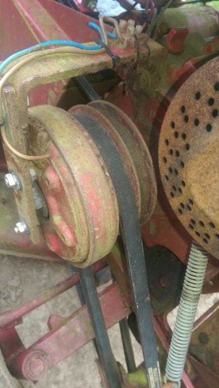

Slopes 4 #11 Posted April 28, 2018 Hi guys, Got her going OK is. My next problem the wheel to pullie that runs the deck won't spin. Any ideas Thanks again for all the help. 1 1 Share this post Link to post Share on other sites
953 nut 69,105 #12 Posted April 28, 2018 2 hours ago, Slopes said: wheel to pullie that runs the deck won't spin. Is this the pulley on the engine, the deck or the mule drive between them? Share this post Link to post Share on other sites

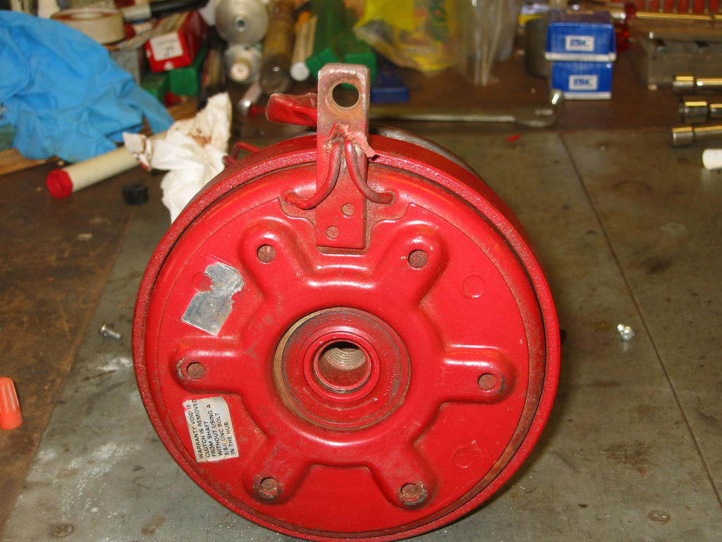

Slopes 4 #13 Posted April 28, 2018 See the image. 1 Share this post Link to post Share on other sites
pfrederi 21,145 #14 Posted April 28, 2018 That is an electric PTO. Needs 12 volts applies to work. Wiring looks a bit hacked can you give a better shot of teh wires where they go into the PTO ??? 1 Share this post Link to post Share on other sites
pfrederi 21,145 #15 Posted April 28, 2018 There should be two wires going into the PTO. One goes to ground the other to the PTO switch on the instrument panel. Figure out which goes to the switch and see if you have 12 volts with switch on. You should hear a loud click in the PTO when you turn the switch on . Share this post Link to post Share on other sites
953 nut 69,105 #16 Posted April 28, 2018 There is a 20 Amp fuse in line with the electric clutch, check it. Some ignition switches have four positions, Off, On/Accessory, On, and Start. If you have this switch it needs to be in the On/Accessory position. 1 Share this post Link to post Share on other sites
