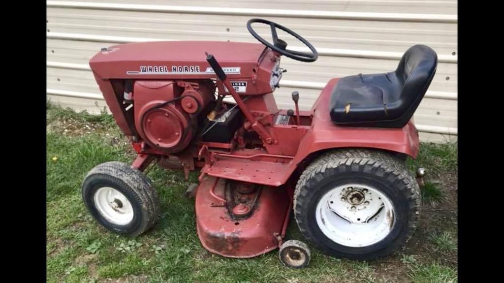

Preacher 6 #9 Posted May 9, 2018 (edited) On 4/13/2018 at 4:40 PM, gwest_ca said: Some of these models were sold in Europe where they continued to use the Raider name for a few years after 1972. Toro identifies the 1-0350 as a Raider and we have some of the serial numbers for these but totally different from the North American serials. Click on the picture I recently purchased a Raider 12. I was told that it was a 68, but I have no idea. Everything has been painted over. Can you tell me where I could find the Model #? I would like to find some parts for it. Thanks. Garry Edited May 9, 2018 by Preacher Share this post Link to post Share on other sites

gwest_ca-(File Mod) 12,535 #12 Posted May 9, 2018 Look up high on the flat panel in front of the seat just below the dash panel. The ID plates were there for many years. Garry Share this post Link to post Share on other sites
Preacher 6 #13 Posted May 10, 2018 On 5/9/2018 at 6:46 AM, gwest_ca said: Look up high on the flat panel in front of the seat just below the dash panel. The ID plates were there for many years. Garry Share this post Link to post Share on other sites
gwest_ca-(File Mod) 12,535 #14 Posted May 11, 2018 My guess is you have an early 1968 Raider 12 model 1-6231 because it has the combination starter/generator. During the 1968 model year they changed to a Bendix starter and alternator stator to charge the battery. When this happened they continued to use the same 1-6231 model number so we identify them as early 1968 production and late 1968 production. We do not have a lot on the early models. Click on the pictures. Late production so the engine and tractor wiring are different. The rest should be the same. Garry Share this post Link to post Share on other sites
