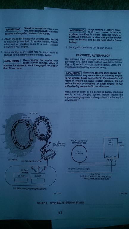

WHX?? 58,226 #3 Posted April 10, 2018 Replace the regulator for sure. They are less than 20 bucks and WILL fail. Most often will overcharge and cook a battery. Check the voltage to the regulator with the motor running at the two outside terminals. Should read 30-40 volts WOT and you will be reading AC voltage. Center term to ground you should read 13-14.5 volts DC at WOT. Corrosion on the terminals usually means a acid leak at the battery post. Very common with cheaper batteries. 3 1 Share this post Link to post Share on other sites

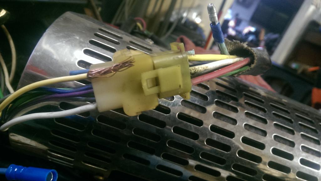

WVHillbilly520H 10,379 #6 Posted April 10, 2018 48 minutes ago, squonk said: I'm willing to bet the terminals in the 9 pin connector are either burn't up or corroded. Will look like my picture...usually I just cut it out and reterminal with "bullet" style terminals with bit of dielectric grease when snapping together, Jeff. 3 Share this post Link to post Share on other sites

WVHillbilly520H 10,379 #8 Posted April 11, 2018 6 hours ago, WHX16 said: That pic is gettin kinda old Billy.... any chance we can get can one of your beard in flames cause of an errant spark? Ok here we go IDK, but I may possibly fit in with the locals at the Big Show if by chance I make it...now back to regularly scheduled programming...sorry that was only pic I took while dismantling the '95 to fix the 9 pin, so now it's on you Jim to add pics of a severely corroded molex connection to help identify the root of most TORO/Onan electrical gremlins. 3 1 Share this post Link to post Share on other sites
