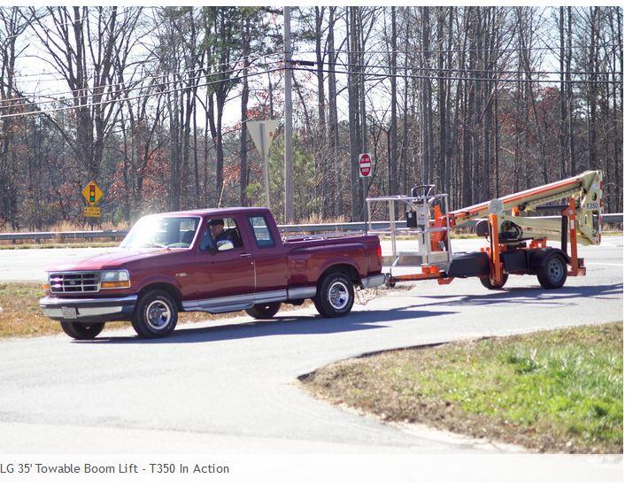

pfrederi 21,145 #8 Posted April 10, 2018 Is this the sort of thing you are talking about??? You wanted a front hitch, I believe a rule of thumb is tongue loading is about 10 % of total weight. That would be a lot on the front wheels and spindles..(300 series spindle are more prone to bending. Next that much down pressure in front of the front axle will seriously lighten your rear end depriving you of traction..... 3 2 Share this post Link to post Share on other sites

953 nut 69,104 #11 Posted April 10, 2018 A few years back I used one similar to the one Paul has pictured. It was attached to the hitch on the truck and all four outriggers down and you could see the rear of the truck moving as I changed positions with the lift. Like Eric said, don't even think about it. You may want to rent some scaffolding if you won't be able to move the lift safely. 3 1 Share this post Link to post Share on other sites
dlaw90 14 #12 Posted April 10, 2018 Thanks for the help. I'll look at other options than the tractor. The area is completely flat, but I would be driving through grass. The hill would only be in the way for trying to turn my truck around. 1 hour ago, pfrederi said: Is this the sort of thing you are talking about??? You wanted a front hitch, I believe a rule of thumb is tongue loading is about 10 % of total weight. That would be a lot on the front wheels and spindles..(300 series spindle are more prone to bending. Next that much down pressure in front of the front axle will seriously lighten your rear end depriving you of traction..... This is the manlift I was hoping to use. 1 hour ago, Tractor boy said: Could you rent a nontowbehind man lift and just drive it in the yard? I looked at renting one, but there is a big cost difference between the self-propelled and tow-behind models. Share this post Link to post Share on other sites

wallfish 20,576 #16 Posted April 10, 2018 One advantage of that thing is the distance of those trailer tires from the hitch. (At least on the one pictured). Short trailers are tougher to back up because they react so much quicker to even slighter movement. Try backing up one of those tow behind compressors into a tight space with minimal sight view like in a van. I must've jackknifed one a dozen times before getting used to it but I could put the boat trailer anywhere in a single shot. 4 Share this post Link to post Share on other sites

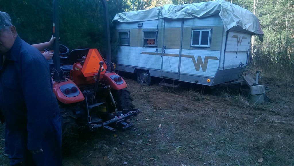

WVHillbilly520H 10,379 #19 Posted April 10, 2018 I don't even know if I would try that with my Mahindra eMax, but I did move a late 60s 14' Winnebago with the Kioti nearly a mile and they aren't that light and bit top heavy but the Kioti has way better brakes than a ... 3 Share this post Link to post Share on other sites
