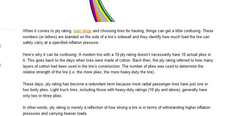

pfrederi 21,307 #2 Posted April 9, 2018 The "Ply Rating" is just a load / capacity rating. It no longer necessarily represents the number of plys. Share this post Link to post Share on other sites

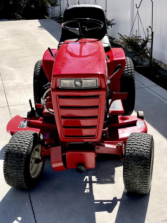

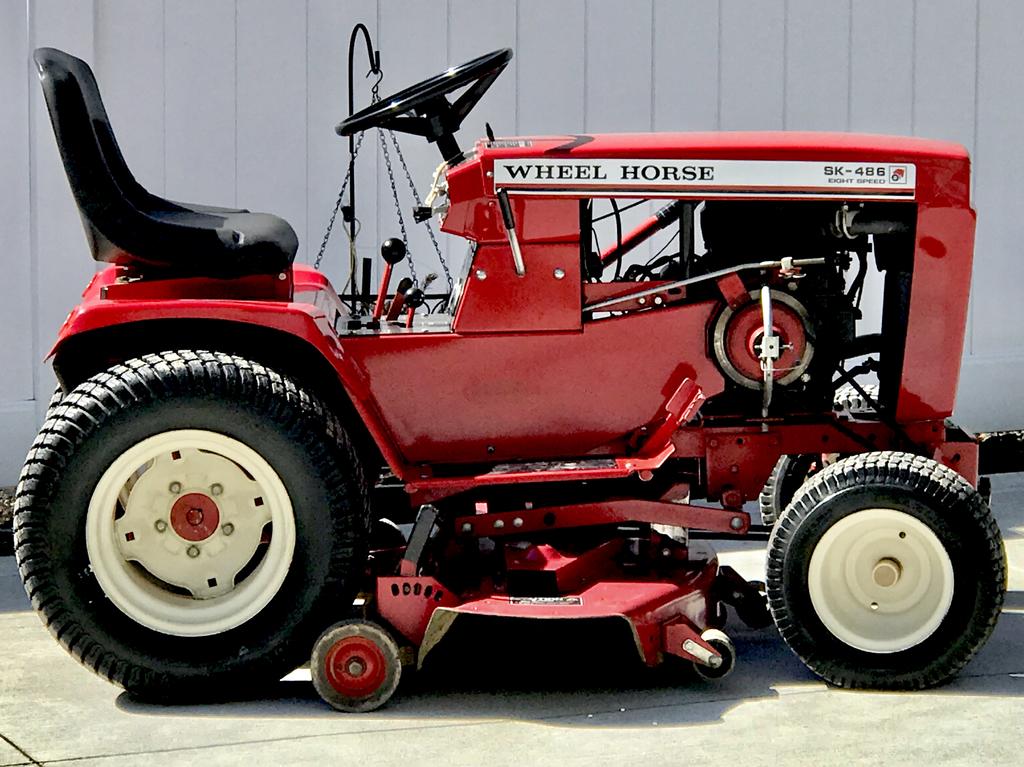

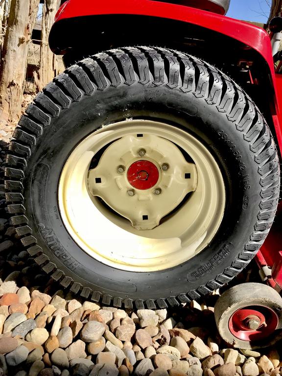

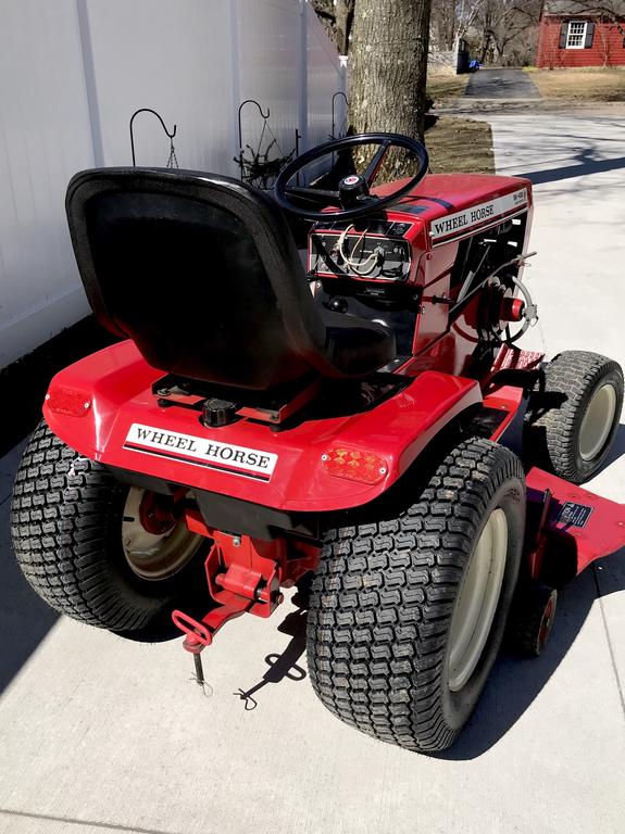

Al C. 1,480 #3 Posted April 9, 2018 I just replaced the 36 year old 22x7.5x12 on my Wheel Horse SK-486 with 23x10.5x12 Hi Run 4-Plys from Tractor Supply. They fit fine - no problem. Look great. Excellent traction. Suggestion, have your local tire shop mount them. I struggled for three hours with no results. The auto shop did both of them in a half hour for $20. 5 Share this post Link to post Share on other sites

pfrederi 21,307 #6 Posted April 9, 2018 1 hour ago, RandyLittrell said: Yes they will fit and 4 ply is a thicker tire and will resist flats better. Don't do the 6 ply, they are heavy and don't flex well on a garden tractor so they are rough riding. I always have the tire shop remove the old tires and install the new ones myself. I have a couple of tire irons and its just a matter of good lube!! Randy Exactly what do your tires say on the side 4 ply or 4 ply rating??? 1 Share this post Link to post Share on other sites
RandyLittrell 3,946 #7 Posted April 9, 2018 The tire itself will usually say 4 ply, but the ad online will be like-23x10.50x12 4P So you know the 4p means 4 ply, but I have seen some that didn't say, and if they are too cheap they are probably 6 ply's. Randy Share this post Link to post Share on other sites
pfrederi 21,307 #8 Posted April 9, 2018 The key here is it is a rating not a reflection of the tactful number of layers. merely the load carrying capability 1 Share this post Link to post Share on other sites
RandyLittrell 3,946 #9 Posted April 10, 2018 59 minutes ago, pfrederi said: The key here is it is a rating not a reflection of the tactful number of layers. merely the load carrying capability Yes, but on tractor tires, more "ply's" equal thicker rubber, heavier, and stiffer. The 6 and 8 ply's were made for trenchers and such that are much heavier. . They are like having a solid tire on a lightweight garden tractor. They don't mold to the ground as well either, so less traction. Just giving my .02! Randy 2 Share this post Link to post Share on other sites

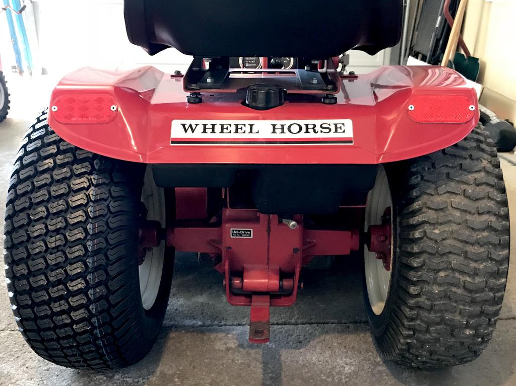

Al C. 1,480 #12 Posted April 10, 2018 5 hours ago, rwmastel said: Thanks for the ply education, guys! Al - Those 10.5 tires look like a natural fit for those wheels. The old tires must have looked silly skinny. I'll get 4 ply 10.5 wide. We'll see if I get Hi Run or something else. Here is the comparison. 7.5 inch on the right, 10.5 inch on the left - both on the same size Wheel. 2 Share this post Link to post Share on other sites
Skipper 1,792 #13 Posted April 10, 2018 the wider the better It looks gooooood! 1 Share this post Link to post Share on other sites

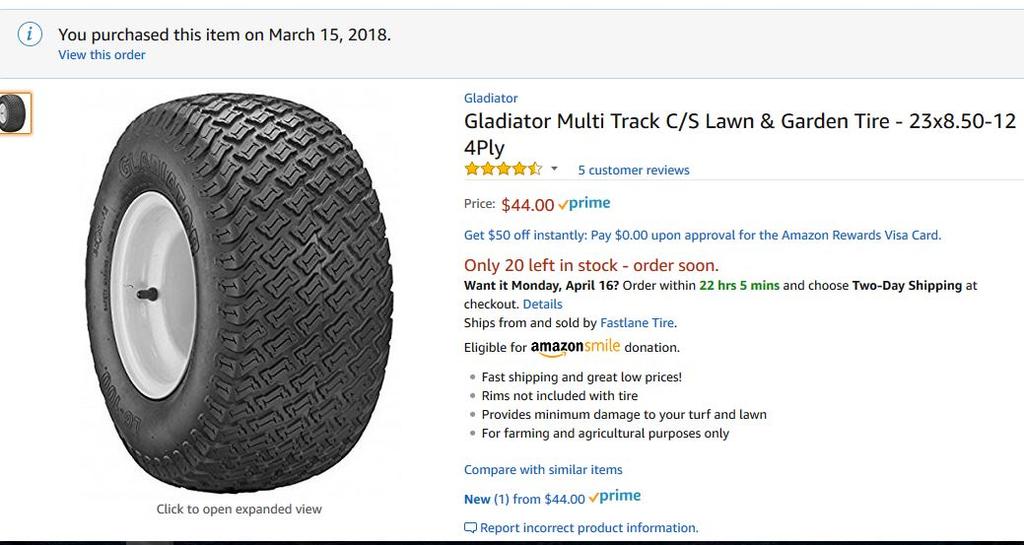

pfrederi 21,307 #18 Posted April 11, 2018 (edited) They are all made on China these days and it isn't like am driving the family at 70 mph on the interstate with garden tractor tires. (anyone remember firestone tires and Ford Explorers??? so much for name brand quality) No specifies special torque for bolts Standard for gr5 7/16-20 is 75ft lbs The were round, they fit, and held air 44 bucks free shipping Edited April 11, 2018 by pfrederi Share this post Link to post Share on other sites
