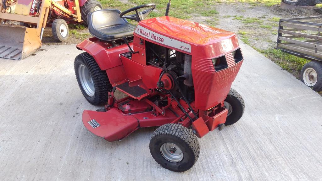

RandyLittrell 3,944 #2 Posted April 8, 2018 Here is my Horse. 4 Share this post Link to post Share on other sites
