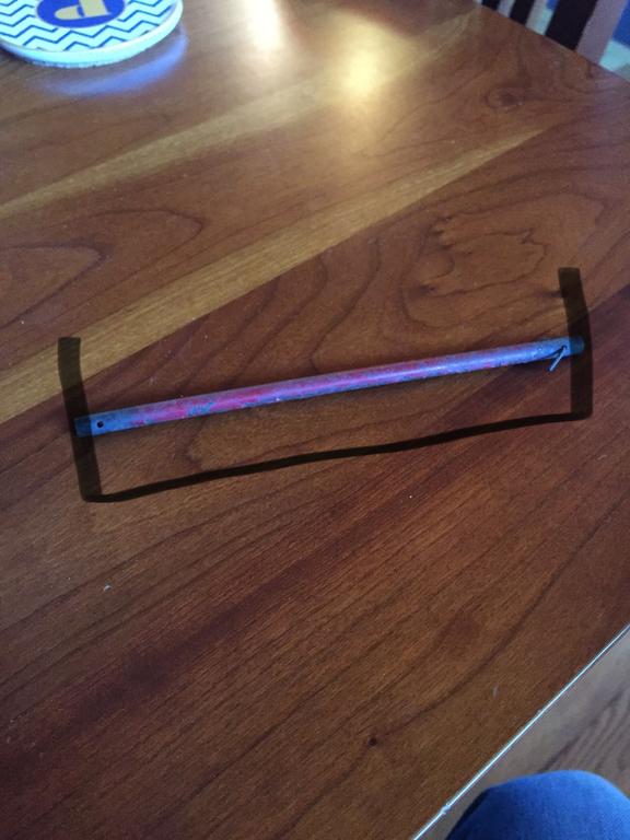

spark949 24 #1 Posted April 7, 2018 I found this on the driveway after the snowed cleared. I know it come from one of my tractors......but where. Anyone recognize it? It’s about 6 1/2 inches long. Thanks Share this post Link to post Share on other sites

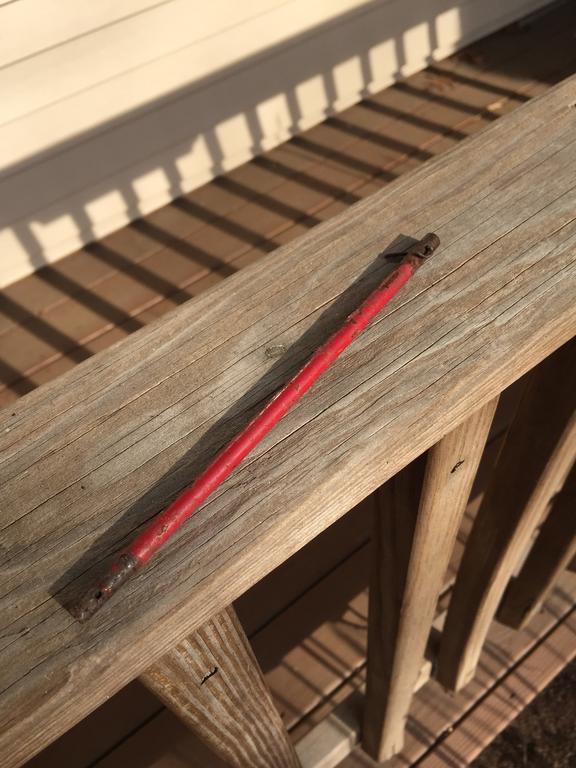

ol550 879 #3 Posted April 7, 2018 Hood stop rod. ? 5 Share this post Link to post Share on other sites

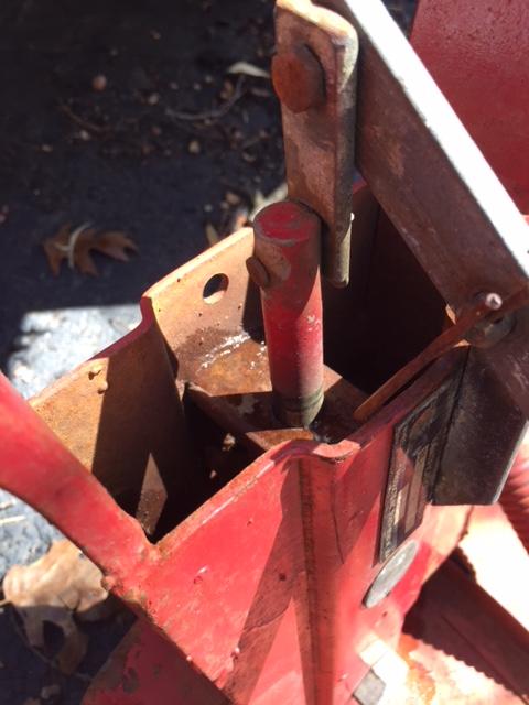

Ed Kennell 47,820 #4 Posted April 7, 2018 Check your front Attach-a-matic. 6 1 Share this post Link to post Share on other sites
squonk 48,328 #5 Posted April 7, 2018 Ed Dog got it. Had the same thing happen to me a few yrs. back. 3 Share this post Link to post Share on other sites

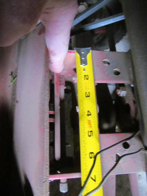

spark949 24 #6 Posted April 8, 2018 Sorry it took so long to check....Not on my attachamatic...all the rods are still there....dont see where it would come off on my plow either. Share this post Link to post Share on other sites
c-series don 12,656 #7 Posted April 8, 2018 I think ol550 nailed it. Check the hood stop rod thats what it looks like to me. Is it about 3/16-1/4" diameter? The hood hinge pin is more like 3/8" Share this post Link to post Share on other sites
Ed Kennell 47,820 #8 Posted April 8, 2018 Yeah, I woulda bet the farm it was this hood stop bar in the front attach-a-matic. Maybe you have a prowler tractor in the neighborhood. 1 Share this post Link to post Share on other sites
pfrederi 21,307 #9 Posted April 8, 2018 What is the diameter of the rod??? Share this post Link to post Share on other sites
spark949 24 #10 Posted April 8, 2018 I just looked again...this time at the place where a hood stop pin should be. Neither the 5620 or the 160 has them. Could be from either. but what threw me is the the cotter pins would be inside the support not outside. That would mean it probably had two washers, one on the inside of both ends. Its 1/4 inch. 1 Share this post Link to post Share on other sites
Ed Kennell 47,820 #11 Posted April 8, 2018 There are no washers on any of mine. Just the two cotter pins inside each of the side plates. If one pin rusts off or falls out, the rod slides over and falls out. 2 Share this post Link to post Share on other sites
spark949 24 #12 Posted April 8, 2018 44 minutes ago, Ed Kennell said: There are no washers on any of mine. Just the two cotter pins inside each of the side plates. If one pin rusts off or falls out, the rod slides over and falls out. Exactly what must have happened to mine....thanks to all here, I knew I could get the answer. 1 Share this post Link to post Share on other sites
