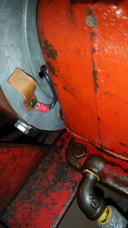

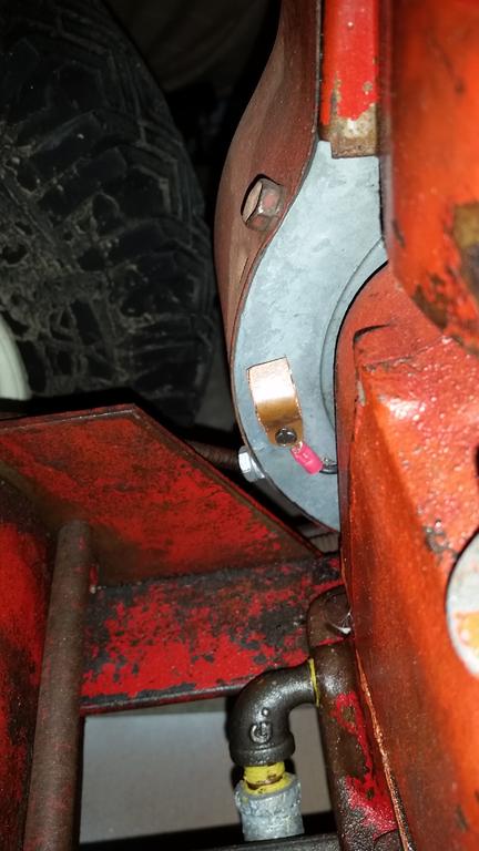

WHX?? 56,076 #2 Posted April 4, 2018 On the back side of the bearing plate there should be a small nylon block with a wire on it coming from the points under the flywheel. If you ground that wire out it will kill the engine. You can run that wire to a kill switch somewhere or as I did make a small piece of spring clip like thingy mounted on the nylon block to push to ground points much like a Kohler. Kinda hard to describe but don't have a pic but will get one. Not sure how the original kill button was. 1 Share this post Link to post Share on other sites

WHX?? 56,076 #4 Posted April 4, 2018 No problem ..will get one when I get home tonite..... that pic will speak a thousand words. 1 Share this post Link to post Share on other sites
WHX?? 56,076 #5 Posted April 5, 2018 Couple of pics here buddy on what I did for a kill switch. Switch thingy is just a piece of copper trimmed to form a spring. This is on a Clinton B1290 on a very eary 1960 Suburban .....May not be correct but worked. Hope this helps. Share this post Link to post Share on other sites

wallfish 19,738 #7 Posted April 6, 2018 There's a hole in the hood below the throttle lever for a switch.(if the hood wasn't cut off) Run that wire from the coil to a switch which grounds the connection to the hood. They can be found on epay as chainsaw switch. 2 Share this post Link to post Share on other sites
WHX?? 56,076 #8 Posted April 6, 2018 54 minutes ago, wallfish said: found on epay as chainsaw switch. Thanks 'fish was looking for one of those.... would have never guessed for a saw. Share this post Link to post Share on other sites
