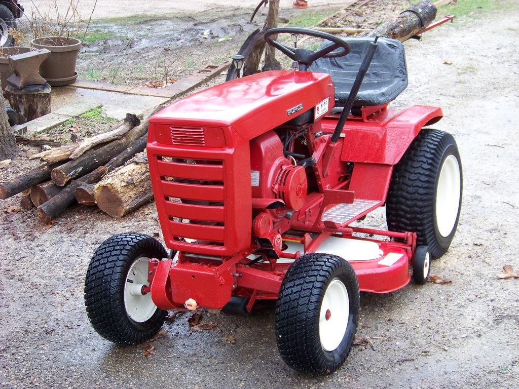

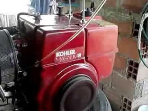

OneHorse 18 #8 Posted April 8, 2018 Hey, Thanks Guys ! So, I'm thinking about drilling and tapping the snap-ring side to 3/8"-16. The bolt/washer side just fits better (less wheel slop). And maybe I'm confused about the blower housings. Correct me if I'm wrong, The Magnums had the squared-off looking housings but the K-181 and 161 never did change shape... My '76 B-60 Share this post Link to post Share on other sites
pfrederi 21,307 #9 Posted April 8, 2018 3/4" shims of differing thicknesses will get your front wheels on in good shape. You do not want drag when the bolt is tightened nor do you want a lot of in/out play Share this post Link to post Share on other sites
OneHorse 18 #10 Posted April 14, 2018 Hey Thanks, Since that post, I found the correct washer for behind the snap-ring. Oh, and the Force emblem is coming off next week. I ordered decals from Terry. 1 Share this post Link to post Share on other sites
Racinbob 13,286 #11 Posted April 14, 2018 On 4/8/2018 at 4:59 PM, OneHorse said: Hey, Thanks Guys ! So, I'm thinking about drilling and tapping the snap-ring side to 3/8"-16. The bolt/washer side just fits better (less wheel slop). And maybe I'm confused about the blower housings. Correct me if I'm wrong, The Magnums had the squared-off looking housings but the K-181 and 161 never did change shape... My '76 B-60 Yea, Magnum 8's are squared off too. 1 Share this post Link to post Share on other sites
