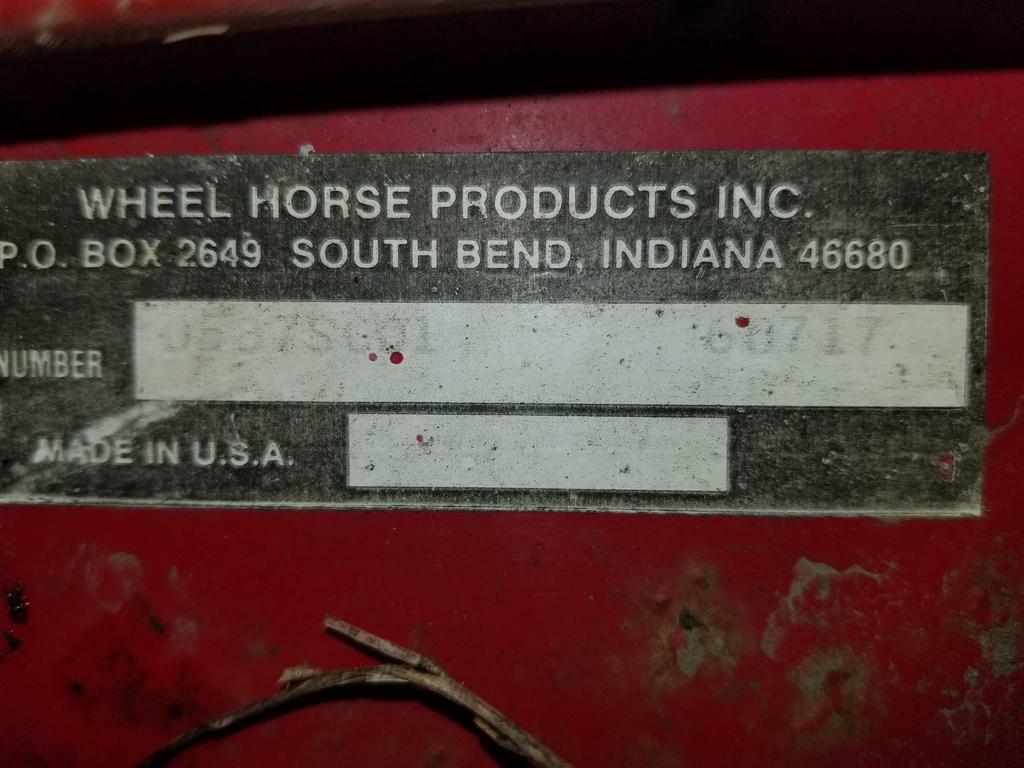

Justin compton 0 #7 Posted April 3, 2018 Hard to see but that's the deck.. Share this post Link to post Share on other sites
gwest_ca-(File Mod) 12,533 #8 Posted April 3, 2018 Suspect your deck is a 1987 model year. The model number is 05-37SC01. Click on the pictures Now look at the idler pulleys inside the deck. If they are both for V-belts you need the idler assembly that has 2 v-pulleys as illustrated in the parts list. Reason for mentioning this is many decks have had their idlers replaced so they match the later 4-sided belt design. You don't want to be purchasing the wrong ones. This is a good service bulletin to print out and have with you when installing the six sided belt. Do it wrong and you will be needing another belt. Garry 3 Share this post Link to post Share on other sites
Justin compton 0 #9 Posted April 3, 2018 Yea there v style Share this post Link to post Share on other sites
