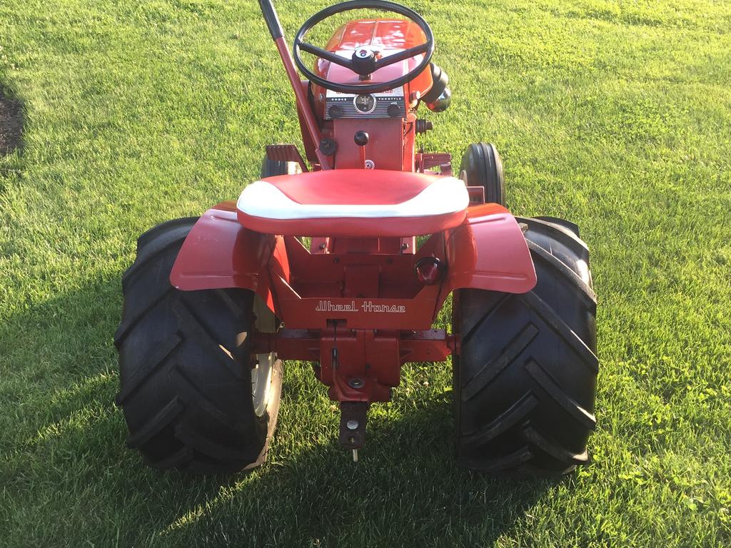

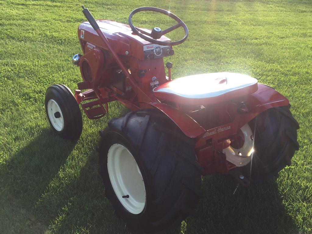

stevebo-(Moderator) 8,541 #2 Posted April 2, 2018 I passed this machine onto another member here but here was my 854 with big tires out back. I loved the look! 6 1 Share this post Link to post Share on other sites
bmsgaffer 2,053 #3 Posted April 2, 2018 @stevebo I agree. I love the look! With tires that wide it will be softer than walkin on the grass. Now if I can just figure out the fronts! I can decide if I am going with Turfs or another set of my TerraTrac K502s that I am running on my 522xi. Share this post Link to post Share on other sites
stevebo-(Moderator) 8,541 #4 Posted April 2, 2018 Brandon- The rears are off a 520 with 10.50's. The fronts I love the look of the tri ribs. I have 4.80 and 3.50's on other machines. I like the look of the 3.50's 1 Share this post Link to post Share on other sites

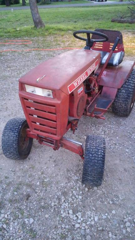

RandyLittrell 3,906 #7 Posted April 2, 2018 Here is a pic of my C-120 for example. 1 Share this post Link to post Share on other sites
RandyLittrell 3,906 #8 Posted April 2, 2018 4 minutes ago, bmsgaffer said: I had not yet measured, so I wasn't sure if the spindles were longer or not on the later models. That is helpful, thank you! I believe they may attach in a different manner, but the hub of the wheel itself, should be the same. The wheels from my cub cadet will even work. Randy Share this post Link to post Share on other sites
