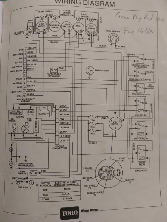

leachy 0 #12 Posted April 11, 2018 Gents Can do you have the wiring for the regulator as I have one wire going into the main block before the fuse box and it terminates there and isn't connected to anything. Share this post Link to post Share on other sites

WVHillbilly520H 10,379 #14 Posted April 11, 2018 1 hour ago, leachy said: Gents Can do you have the wiring for the regulator as I have one wire going into the main block before the fuse box and it terminates there and isn't connected to anything. Try this all the manuals and demystification guide are here on free to download, but here's a quick pic of the wiring diagram from my owners manual, Jeff. Share this post Link to post Share on other sites
Ed Kennell 46,798 #15 Posted April 11, 2018 That is probably the trigger wire for the tach. It uses one of the AC terminals on the RR. Share this post Link to post Share on other sites
