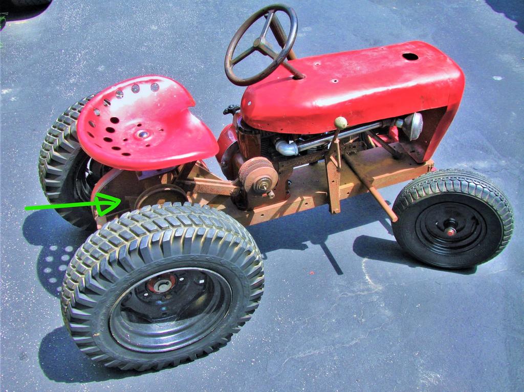

tims tractors 119 #1 Posted March 31, 2018 I have tried everything heat alot of spray some of the mixes I've read about. And after all of that the 7 inch pulley on my 55 RJ will not move. Is there some kind of pullers I'm missing? I was changing clutchs rearends and transmissions when I was 13 so I am not new to this kind of work. Help. Thanks. Tim Share this post Link to post Share on other sites

tims tractors 119 #5 Posted March 31, 2018 Pull up any picture of a 55-56-57 and just below the seat is the pulley on a 55 it's a 7 inch the other 2 are 6 inch. Small shaft big pulley need to get clear around and in close. Thanks Tim. Early RJ jack pulley Share this post Link to post Share on other sites

AMC RULES 37,260 #7 Posted March 31, 2018 This the one you're referring to? Share this post Link to post Share on other sites

tims tractors 119 #9 Posted April 1, 2018 1 hour ago, rmaynard said: Other people's pictures are okay, but a picture of your pulley will be more helpful. How would it be more helpful. I would have to take picture get it on there. In 30 seconds you could be looking at one? Share this post Link to post Share on other sites
tims tractors 119 #10 Posted April 1, 2018 53 minutes ago, AMC RULES said: This the one you're referring to? Yes Share this post Link to post Share on other sites
rmaynard 17,644 #11 Posted April 1, 2018 5 minutes ago, tims tractors said: How would it be more helpful. I would have to take picture get it on there. In 30 seconds you could be looking at one? Share this post Link to post Share on other sites
