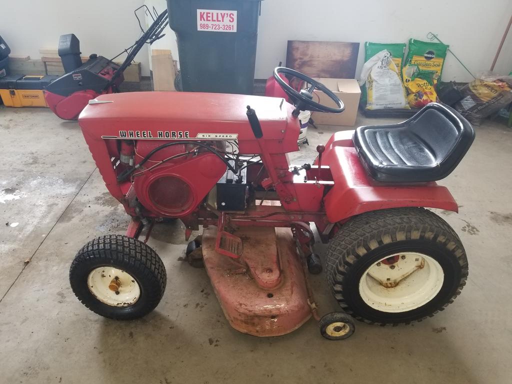

Stealth126 54 #1 Posted March 30, 2018 Hello everyone, first time horse owner here. I have a lot of questions, but I'll start with this one. Is there a such thing as a bracket or hook to attach to the rear of your mower deck to hold it off the ground? So I could haul my wagon without dragging the wheels on my deck? Thanks. 1 Share this post Link to post Share on other sites
953 nut 69,840 #2 Posted March 30, 2018 The rear of the mower will attach to the lift via a chain. Share this post Link to post Share on other sites
Stealth126 54 #3 Posted March 30, 2018 Is that the way it is supposed to work? Because when I lift the deck only the front comes up. Am I missing something on my setup? Share this post Link to post Share on other sites
Stealth126 54 #4 Posted March 30, 2018 Or would that be a custom setup? Share this post Link to post Share on other sites

Stealth126 54 #7 Posted March 30, 2018 This is the deck I have. Thank you very much. I'll have to climb under it and check my setup and see if anything needs to be adjusted. Share this post Link to post Share on other sites

Stealth126 54 #11 Posted March 30, 2018 (edited) I did a little digging around today and found the problem. I didn't have the height adjustment lever nut tightened enough. The deck was pulling up high enough to touch the stopper, but that was it. After I tightened it more, it pulled the deck to the stopper and then the lever action of the engaged stopper pulled the back of the deck 1/2 inch off the ground. Probably doesn't make any sense the way I worded it, but problem solved. Thanks again everyone. Edited March 30, 2018 by Stealth126 Share this post Link to post Share on other sites
