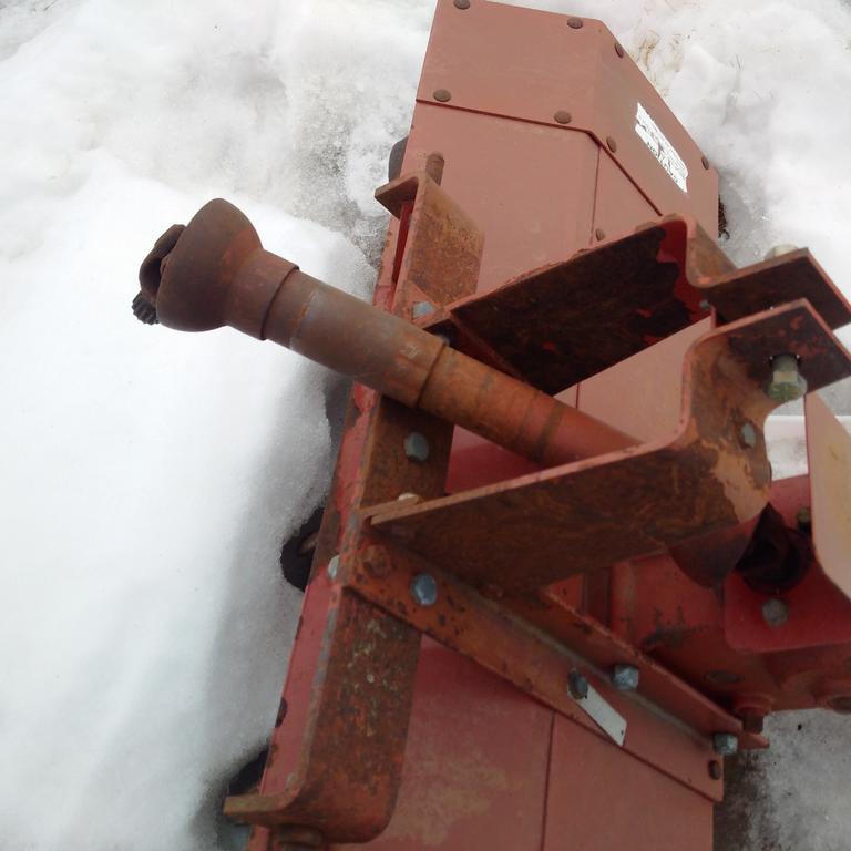

trevor 12 #1 Posted March 27, 2018 Hello, I have a tiller and the pto shaft does not move. I was told their should be movement in it to make putting tiller on hitch easier. Is this correct? I have tried to remove shaft but can not Budge it is their a trick to removing it? Share this post Link to post Share on other sites
Skipper 1,792 #2 Posted March 27, 2018 (edited) The PTO shaft is made from two pieces that slides together. Yes it is supposed to slide, making it longer or shorter. That is also essential when going up and down in the 3pt. if it does not move, you can/will break something. On your picture you can see markings to where it has been pushed together previously. You should be able to pull it apart easily and lube it up. Be careful not to bash on it, as it is connected to the tillers internals. Edited March 27, 2018 by Skipper 4 Share this post Link to post Share on other sites

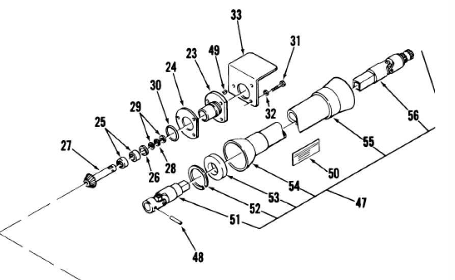

gwest_ca-(File Mod) 12,511 #7 Posted April 5, 2018 Item 51 must fit inside 56. It might not be fully collapsed. Try slamming the end of it down on a block of wood to see if you can shorten it. Even a few thousandths would mean it moved. Garry 2 Share this post Link to post Share on other sites

Sarge 3,473 #9 Posted April 6, 2018 Take the thing to any welding shop that works on ag equipment - they will have it apart in no time, these guys deal with splne coupling heads all the time and know what to heat and what not to heat to pull it apart. Might want to take a copy of the drawing with you - it will show them how the sleeve works since they are opposite of other types of equipment. Most times it's either hardened grease or some of the splines are notched from wear. He might have to run a bead around the outside to expand it , but it won't hurt anything. Sarge 3 Share this post Link to post Share on other sites

pgiro 38 #12 Posted April 6, 2018 It almost looks like someone crimped the two pieces together but I could be wrong. Share this post Link to post Share on other sites

"Manic-Mechanic" 1,486 #15 Posted April 7, 2018 (edited) Hello, I have this issue with mine as well, and I have not tried to deal with it off of the tractor, so it's a trial and error thing. I found just installing the tiller and adjusting the center link to align the tiller & shaft then running the tiller the shaft usually loosens up at that juncture. This year while putting the tiller on the shaft did not want to slide and I had to "make it fit" accordingly. This is because I failed to grease the two parts (51) & (56) after I was done. The tiller is kept out of the weather so it's always a puzzle to figure out why, perhaps old grease build up? Edited April 7, 2018 by Oldman Share this post Link to post Share on other sites
