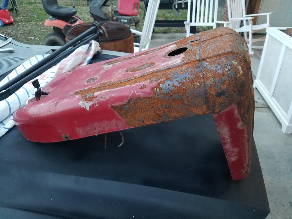

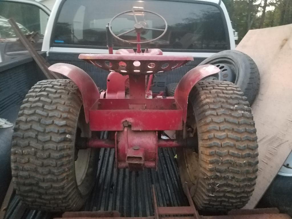

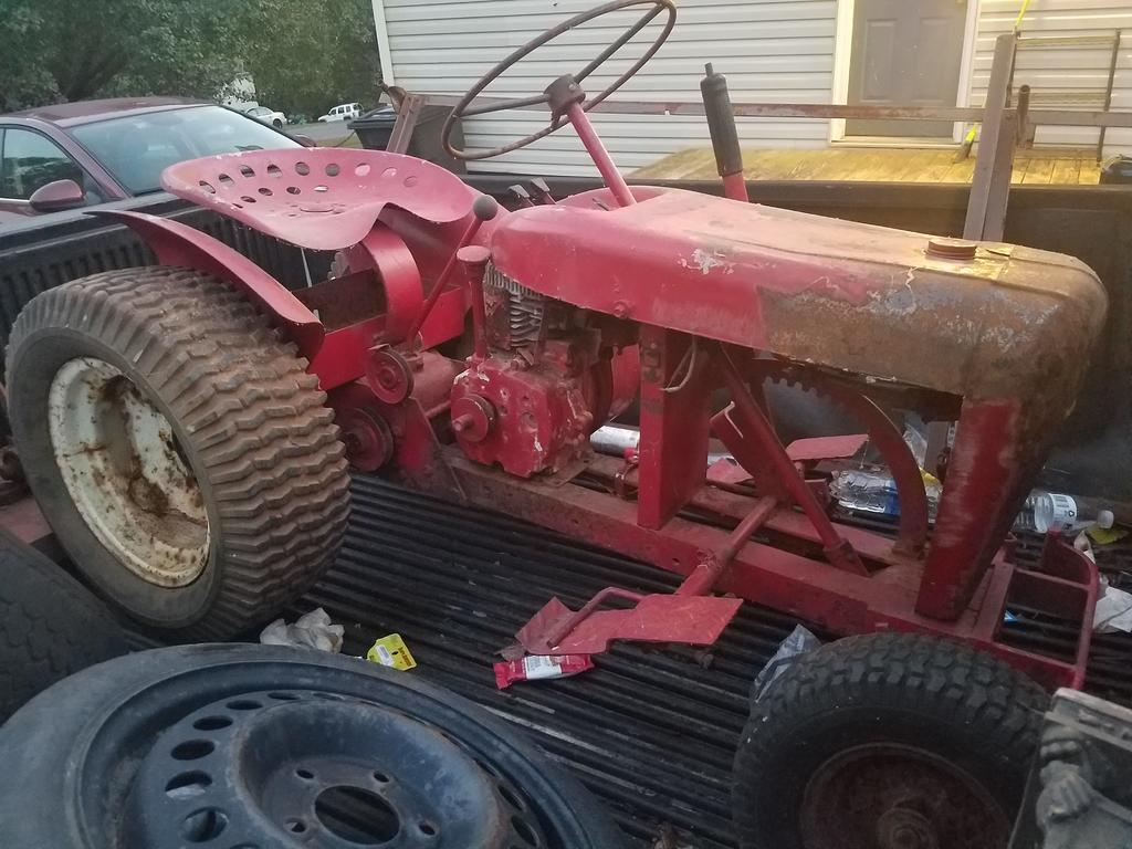

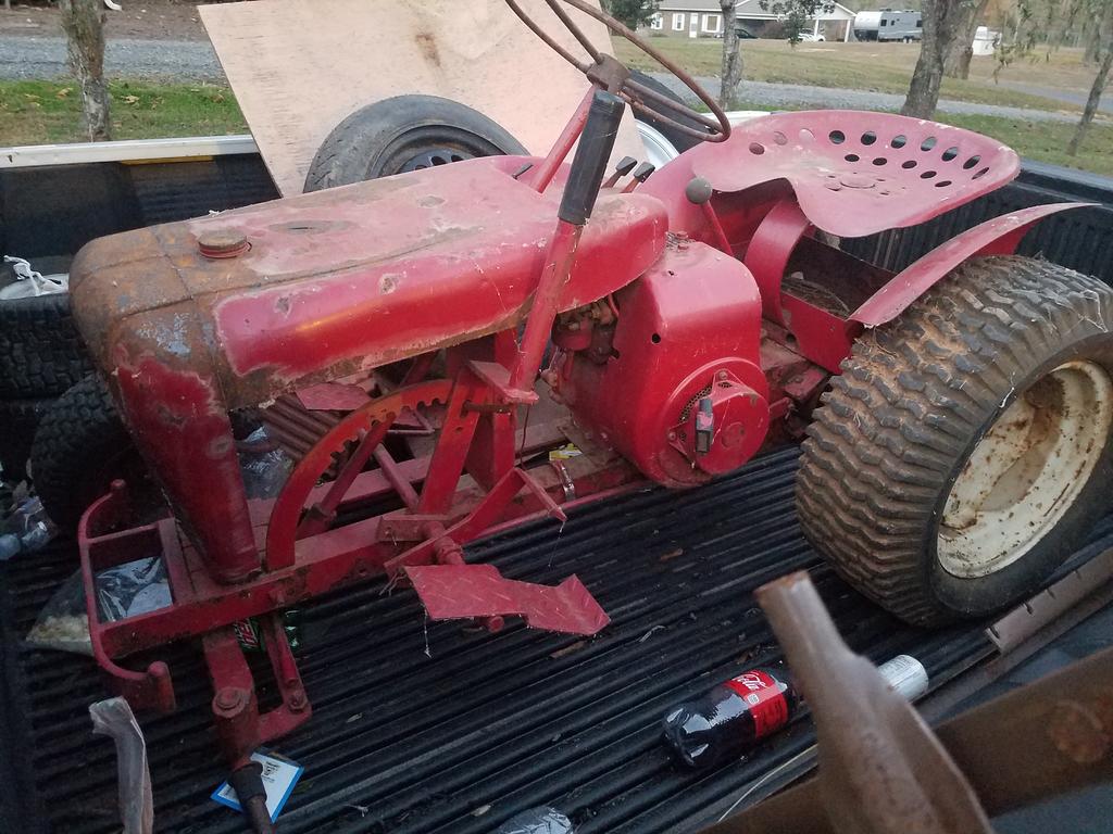

Jerry Boger 14 #1 Posted March 27, 2018 Recently bought this lil gem and need some help Identifying possible year, make and such. I have already started getting it apart and having no issues but will possibly be needing some different parts but 99 percent of it is restorable. Engine is only thing shot Any help would be greatly appreciated 6 1 Share this post Link to post Share on other sites
WHX?? 53,752 #2 Posted March 27, 2018 Jerry What you have there is a nice 1960 Suburban model 400. Not the worst shape from what we've seen either. Engine would have been a Clinton 1290B in early production followed by a Kohler K91, both 4 HP. Others will be along to welcome you and add. 1 Share this post Link to post Share on other sites
Chris G 3,363 #3 Posted March 27, 2018 (edited) I would say you got a 1960 suburban 550 or a 400. Motor is not original so that would be the main deciding factor in my opinion. Edited March 27, 2018 by Chris G Share this post Link to post Share on other sites

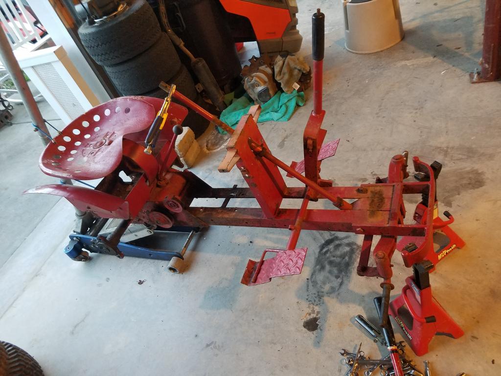

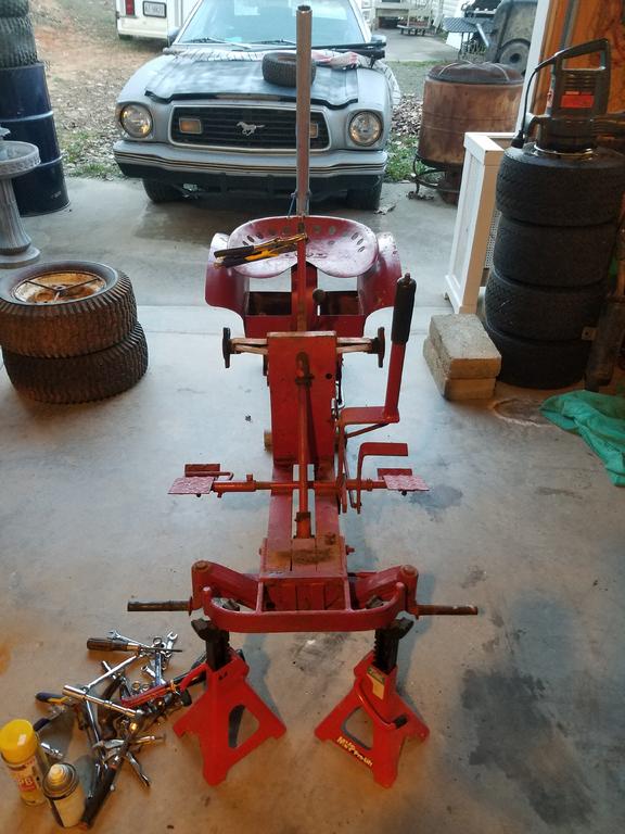

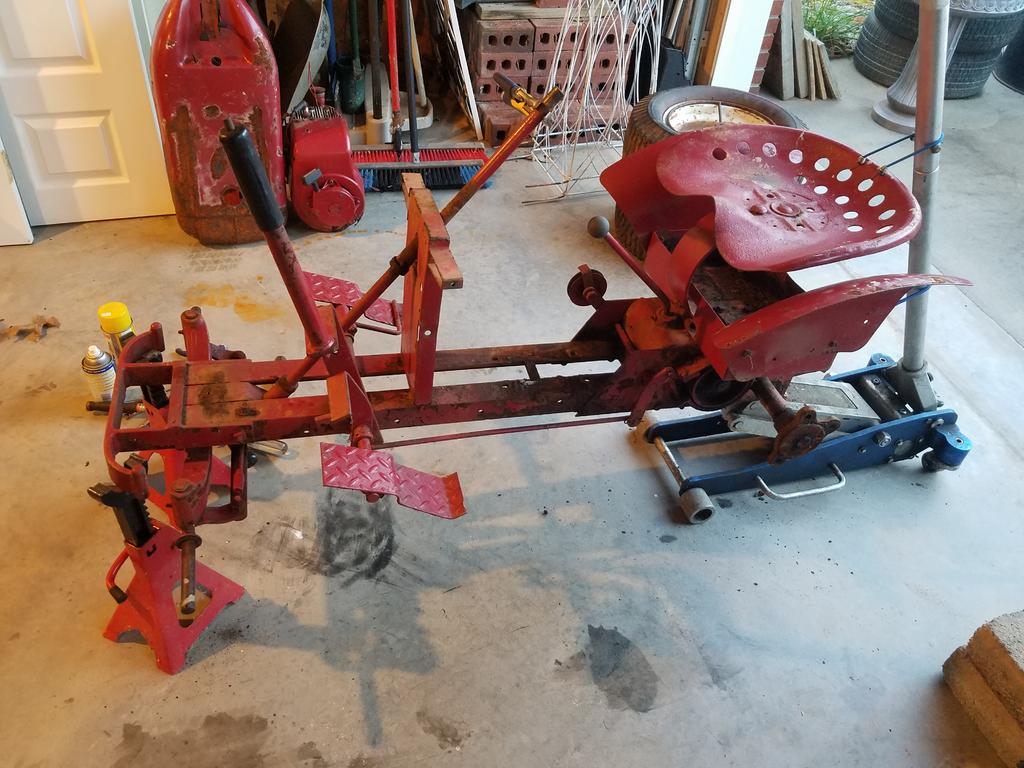

Jerry Boger 14 #4 Posted March 27, 2018 Thanks for the info, knew the motor wasnt original and its no good anyways (locked up) but here is how she sits now except ive removed the seat and fenders. Dont feel I did too bad only gave $100 for it just wanna make a good lil rider for my son. I have the original deck as well but dont intend to put it back on. Any good places to look if parts are needed, will def need a steering wheel and do you by chance know what the lug pattern would be it seems from a cpl pics and videos ive seen that you can put 15 inch wheels on it 1 1 Share this post Link to post Share on other sites

953 nut 63,569 #8 Posted March 27, 2018 The bolt pattern on the wheels is 4.5" five bolt just like a Ford. Be aware that the front end on these is very very light. If you plan to have your son drive it be sure to add weight to the front and a set of wheelie bars would be a good idea too. I bought a Suburban 400 for my wife a few years back and the first time she drove it was her last! When the front end went up a couple feet in the air she shut it off and never got on again. 8 Share this post Link to post Share on other sites
Jerry Boger 14 #9 Posted March 27, 2018 (edited) Thanks for the bolt pattern info, im already working on a set of weights to use on the front bumper similar to a pulling tractor, now just to find a set of 15 in wheels for the back, any worries on backside spacing of wheel? will it need any spacer? Edited March 27, 2018 by Jerry Boger Share this post Link to post Share on other sites
Ed Kennell 44,095 #10 Posted March 27, 2018 I'm likin that custom front bumper. 4 Share this post Link to post Share on other sites
953 nut 63,569 #11 Posted March 27, 2018 1 hour ago, Jerry Boger said: any worries on backside spacing of wheel? Best bet would be to hit the friendly local auto salvage yard and see what looks like a winner. One of mine has a pair of front wheel drive van rims turned around backward. Had to think outside the box a little but it worked. 1 1 Share this post Link to post Share on other sites

Jerry Boger 14 #17 Posted March 28, 2018 @Ed Kennell, the front bumper is what was throwing me off because I couldnt find another pic of one with it 1 Share this post Link to post Share on other sites
Ed Kennell 44,095 #18 Posted March 28, 2018 I'm guessing the PO that built it was inspired by his daily driver. 1 1 Share this post Link to post Share on other sites
