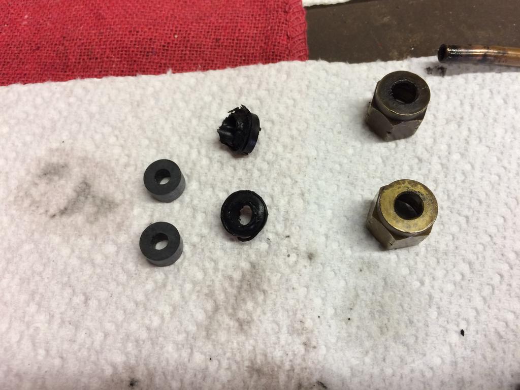

squonk 48,163 #1 Posted March 25, 2018 Looking for the Kohler # for the little rubber fuel line seals that go into the brass nuts on the steel line from the fuel pump to the carb on a 701. I was certain I had some spare ones but they evaporated! Wanted to take the tractor on it's first cruise of the year but gas was a runnin on the floor. 1 Share this post Link to post Share on other sites

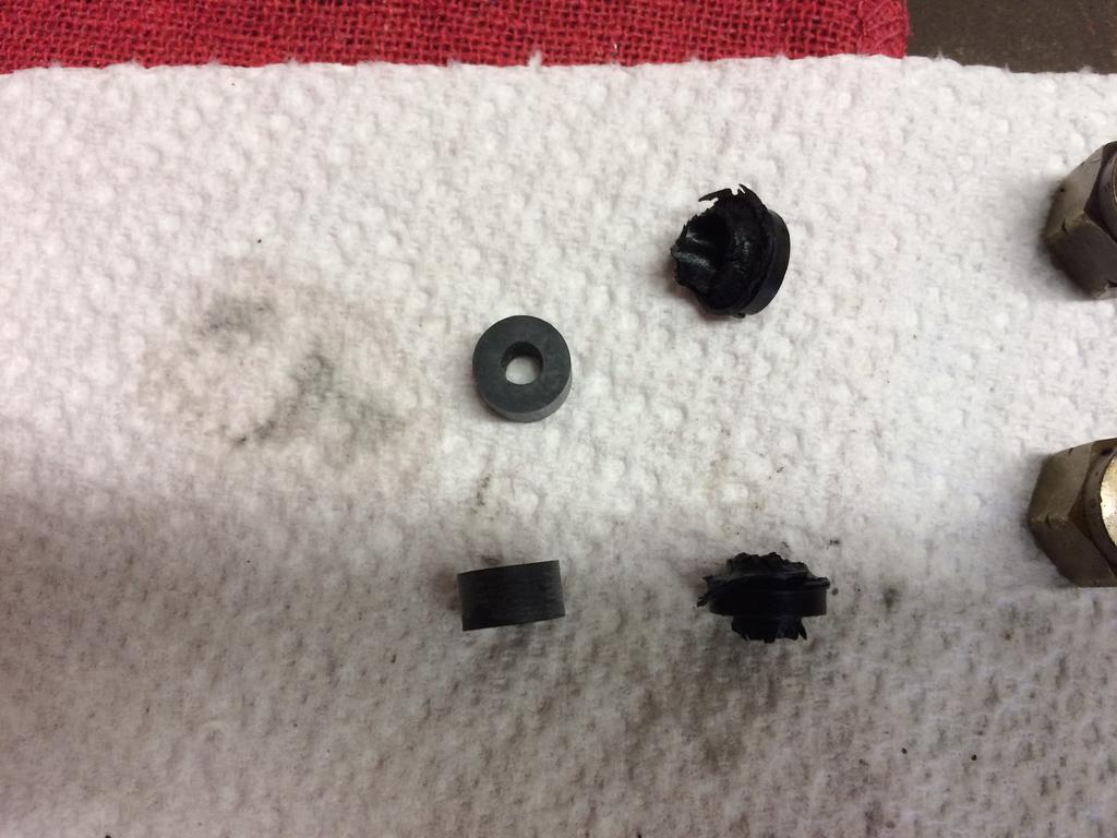

squonk 48,163 #8 Posted March 30, 2018 (edited) Called my OPE guy and gave him the # . He says I am the only guy who ever bought one and they don't stock it. Tried McMaster-Carr. They had them for $10. I call them and ask is that for a pack. He says no only 1. Tried Grainger They had a 10 pack for $11.80 I went that route as I have an acct. with them and 2 day shipping. Gotta believe McMaster was a pack price too they just didn't know it. I guess the seals really were shot! Edited March 30, 2018 by squonk 3 1 Share this post Link to post Share on other sites

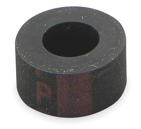

953 nut 69,558 #9 Posted March 30, 2018 Zoro has them too. $ 7.36 a 10 pack. 3/16" COMPRESSION VITON SLEEVE 10PK PARKER| Zoro #: G2130703| Mfr #: 60VLV-3 0.0 No ReviewsWrite the First Review Pipe and Fittings Size Guide DETAILS: Item: SleeVe Temp. Range: -15 Degrees to 450 Degrees F Tube Size: 3/16" View Full Product Details Orders over $50.00 ship FREE. DetailsStandard ground shipping Limited Stock Item ships from Zoro in 1 business day. $7.36/PK 1 2 Share this post Link to post Share on other sites
