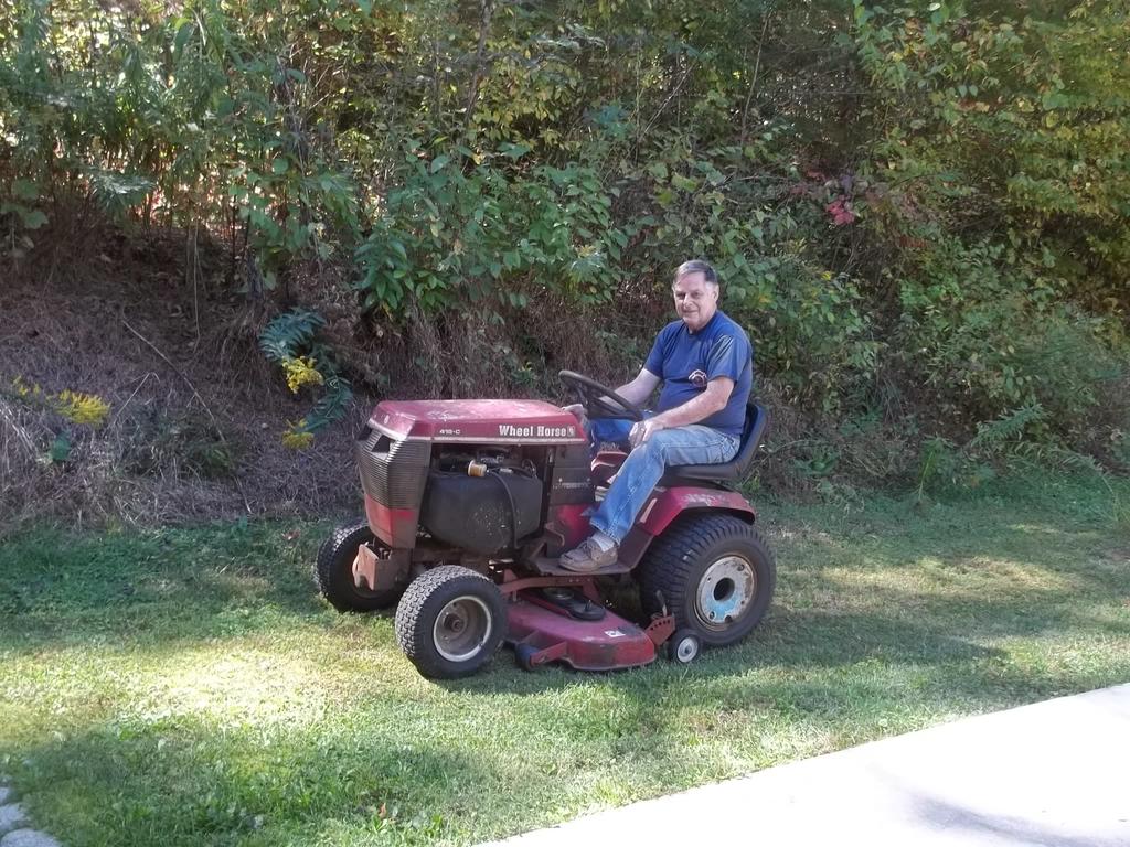

953 nut 70,298 #3 Posted March 24, 2018 It will fit right into the 314 fine. There will need to be a little rewiring done but you should be able to pull it off with no problem. Any questions feel free to post them and we will help. There are lots of twin cylinder Kohlers in . This is my 418-C which isn't pretty but runs great. 1 Share this post Link to post Share on other sites
