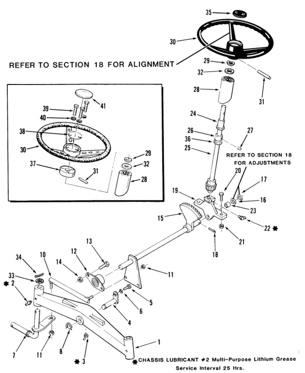

darren 49 #5 Posted March 25, 2018 (edited) I had excessive steering play in a project tractor I picked up - it turned out to be a fracture in the rear mounting block for the steering shafts: not easy to spot unless you knew it was there! I ended up tracking that down by slowly and methodically working my way through the steering system, checking everything. I think this is an unlikely failure mode - the previous owner must've dealt the steering a serious whack on mine to achieve this. Worth checking though. The mount lies on top of the horizontal chassis members and is at the end of the steering wheel shaft(19 in the pic). It kind of fits your first instinct in the post. It could also be that the mount has come loose. The second time I saw excessive play that was easily solvable was when the front support mount (part 12 in the pic) for the horizontal steering shaft was loose: both nuts had backed off and moving the steering wheel allowed the end of the steering rod to float about. My fault for forgetting to torque them! Nipping those up instantly restored everything. It's worth checking for a quick win. The nuts can be quite difficult to get to - it's a little easier with the hood off. To be honest, as pullstart says, there aren't too many places in the system to check so it should be quite easy to find - start at one end and watch the system with a torch, whilst you or a helper apply some rocking input to the steering wheel. Good luck! Edited March 25, 2018 by darren Share this post Link to post Share on other sites
pfrederi 20,653 #6 Posted March 25, 2018 Pull the cotter pin from the steering shaft (#34) and add a 3/4 " machinery bushing in where 35 and 36 are located ...(or a thin washer) and replace cotter pin you do not want front to rear play in the shaft. Share this post Link to post Share on other sites
