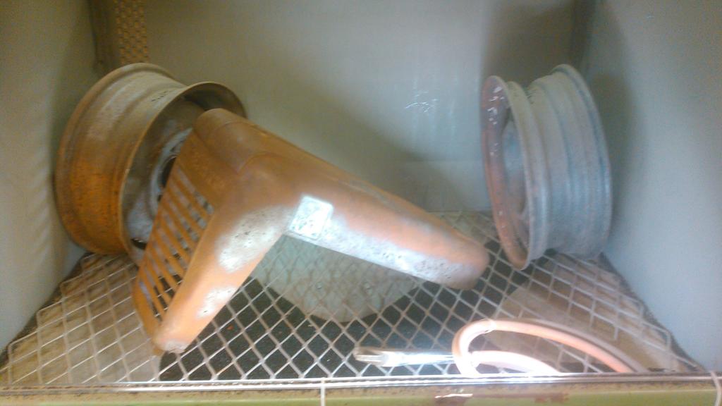

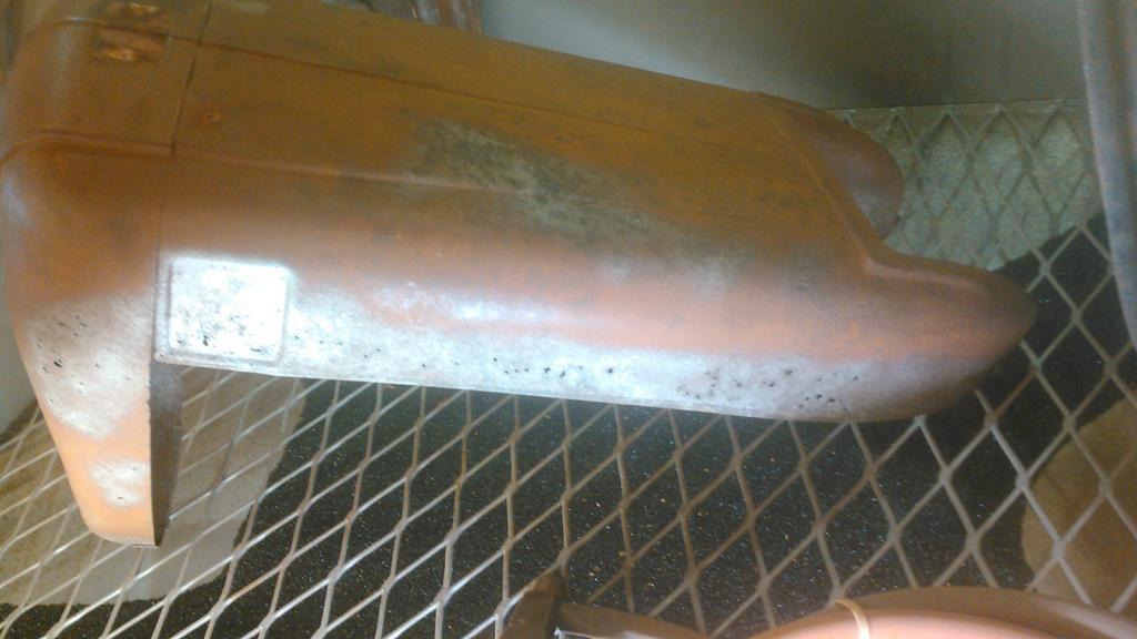

JPWH 6,544 #1 Posted March 21, 2018 I figured I would start a thread on this tractor now I have all the parts and will be working on it between other projects. I blasted the worst spots of the hood to see what I had to work with. I have a little welding to do. 18 Share this post Link to post Share on other sites
Aldon 4,832 #2 Posted March 21, 2018 Awesome. Love the size of that blast cabinet! 4 1 Share this post Link to post Share on other sites

Achto 31,898 #10 Posted March 21, 2018 (edited) Chiming in so I can come along for the ride. Your big blast cabinet is awesome! Looks like you have a little Swiss cheese issue on the hood, definitely repairable though. Edited March 21, 2018 by Achto 2 Share this post Link to post Share on other sites
JPWH 6,544 #11 Posted March 21, 2018 Thanks for the kind comments. I built the blast cabinet when I did my first 854. I knew I was going to build the custom 12 so I made it big enough for that hood and frame as well. I picked this 854 6 speed up at the Big show last year with the intent to go through it like I did the first one. 2 Share this post Link to post Share on other sites

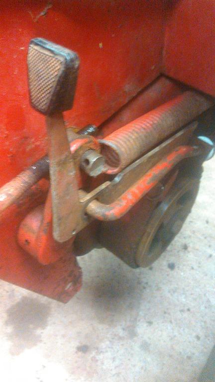

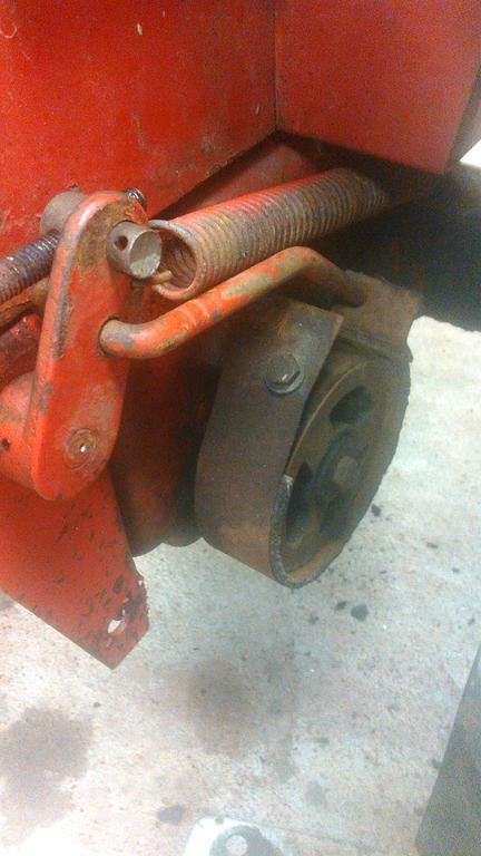

JPWH 6,544 #12 Posted March 22, 2018 I went down to the shop to get pictures of the parking brake but discovered I didn't have one. It won't be hard to do. I changed the brake band and will have to make a brake lever and modify the brake rod a little. Before After 1 3 Share this post Link to post Share on other sites
JPWH 6,544 #13 Posted March 23, 2018 I have decided to make a custom brake rod and save the original with the brake band I removed. 3 Share this post Link to post Share on other sites

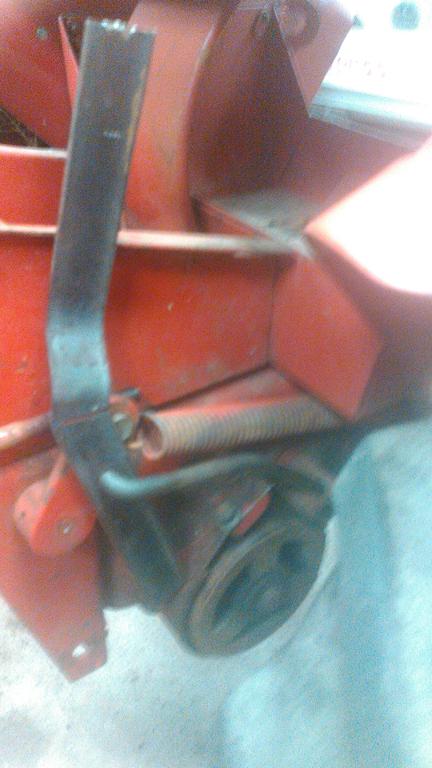

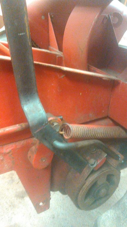

JPWH 6,544 #14 Posted April 7, 2018 I made a little progress today with the parking brake. This is what I came up with. Still need to trim the handle and make a little adjustment. 4 2 1 Share this post Link to post Share on other sites
Chris G 3,373 #16 Posted April 7, 2018 I have to do a similar project myself on my custom 702. I will be using your photo for a little bit of brainstorming on my project. But good job so far 2 1 Share this post Link to post Share on other sites
