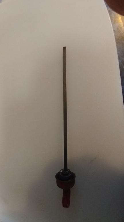

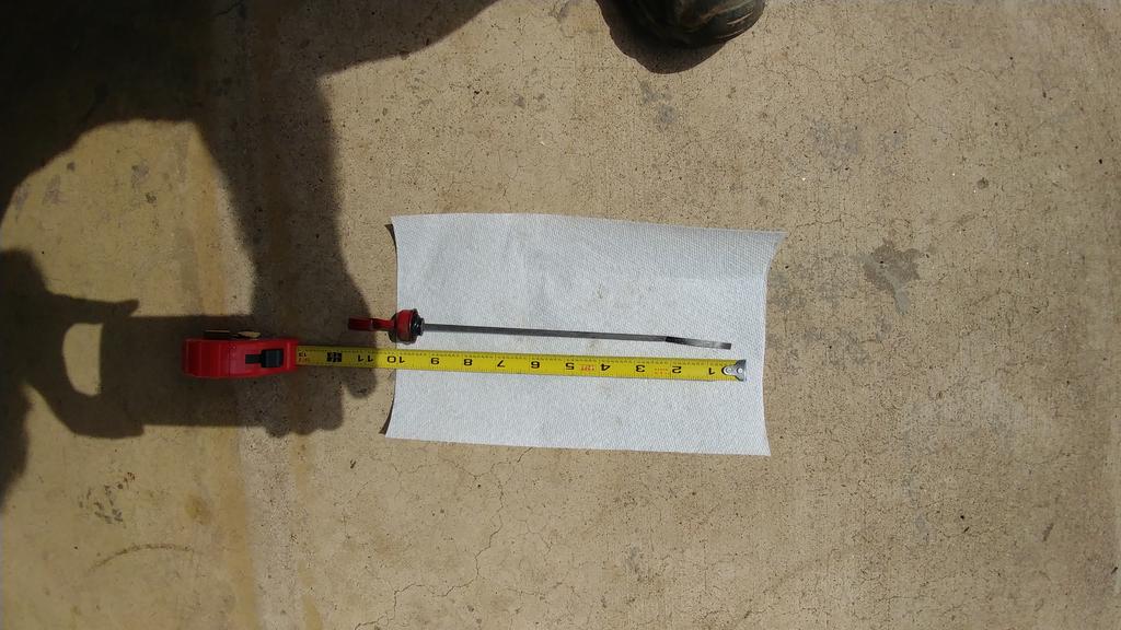

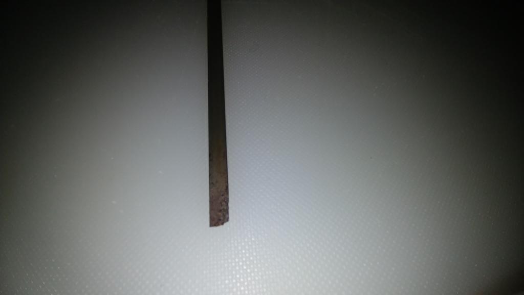

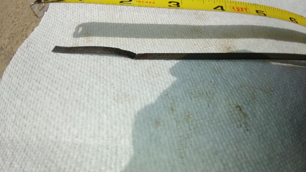

pyroplegic 55 #1 Posted March 19, 2018 I went to check the gear oil in the 310-8 & the dipstick is dry, but the tip is jagged as if broke off.there's also no high or low marks on it. Is it shorter than normal ? I'll be changing or flushing the oil this week to update you all. Share this post Link to post Share on other sites

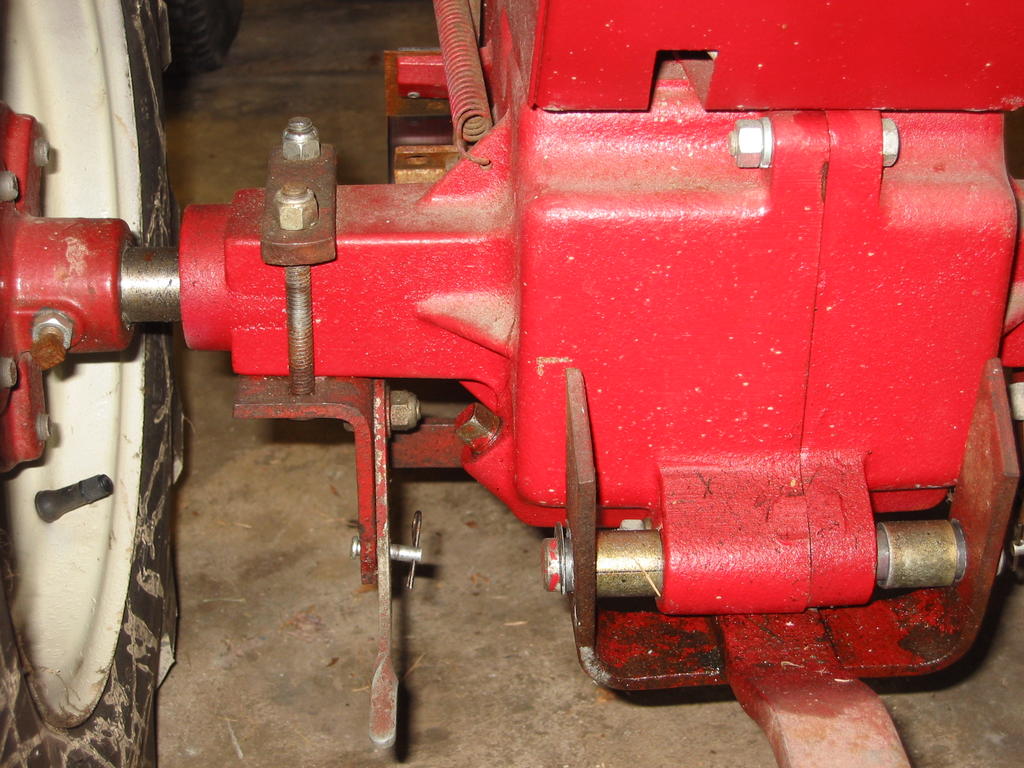

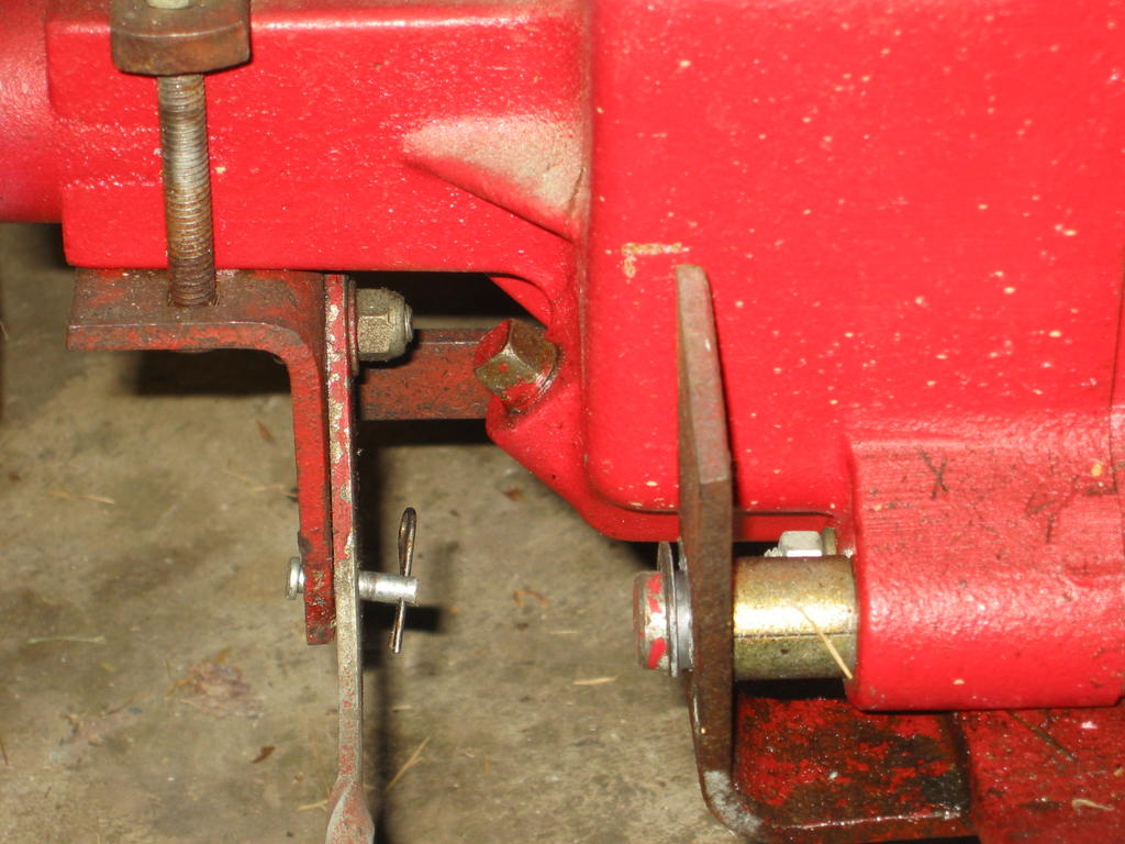

pfrederi 21,151 #2 Posted March 19, 2018 Looks Broken to me. Save yourself some money open the diagonal plug on the transmission rear left side add oil though dipstick till it runs out plug. That is full. 3 1 Share this post Link to post Share on other sites

stevasaurus 23,856 #4 Posted March 19, 2018 You do not need a dipstick if you use the method that Paul showed you. I'd cut off a little more and use what is left to plug the hole. Just remember the piece that if cut off is in the case somewhere. You might get lucky with a magnet through the drain hole, but more likely, you would need to separate the halves to get it out of there. 2 1 Share this post Link to post Share on other sites

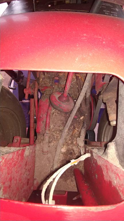

red192126 2 #5 Posted March 19, 2018 If trans.oil is milkey looking or white tint transmission has water in it . The lower part of dip stick is rusted of at oil level. Check rubber boot around gear shifter for loose fit splitting 1 1 Share this post Link to post Share on other sites

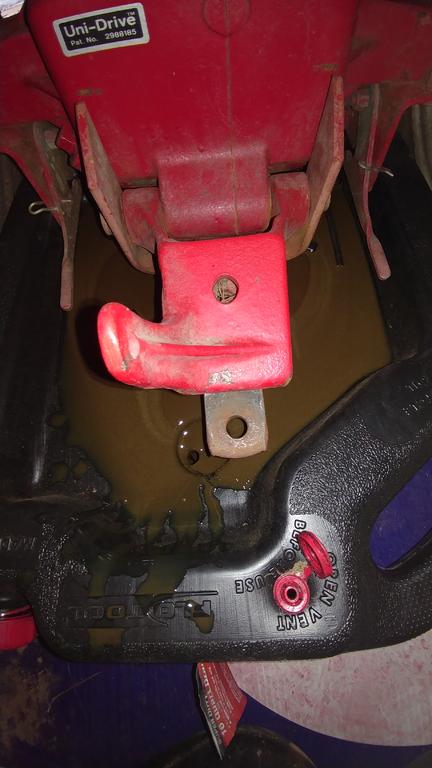

pyroplegic 55 #18 Posted March 20, 2018 (edited) Why do I wait till the snow is bearing down on us to do this. Today I warmed up the horse, added about a cup of diesel to thin out the old gear oil and ran it in 3rd gear on jack stands for about 20 minutes, I found the drain plug under the axle and drained out what was in there. jacked the front way up to get that last bit of oil out, Yup it looked like milk chocolate, I do have have a bad boot, but it's got a covered run-in so it rarely sees rain. may just be the color of diesel & gear oil. Next added about 2-3 cups of more diesel I got chilled & took a brake and here we are. I'll run it again before draining the fuel oil out, and attempt to blindly magnet fish out that dipstick tip. Edited March 20, 2018 by pyroplegic 1 Share this post Link to post Share on other sites
wallfish 20,618 #19 Posted March 20, 2018 If you get the measurement of a good dip stick, then measure your broken stick. Cut the plastic tube down exactly the difference between the two sticks you measured. Your broken stick will now sit at the same spot as a good stick does. BUT, you will need to taper the inside of the plastic tube just like the top of it is before you cut it off. I just use a drill bit to do it but can't remember the size. This taper will allow the rubber stopper on the dip stick to sit inside the tube and seal it. 1 1 Share this post Link to post Share on other sites

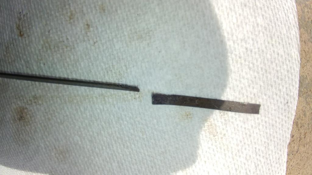

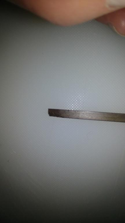

pyroplegic 55 #23 Posted March 29, 2018 (edited) Update: Got a piece out! I'm not sure if there's more, the piece I fished out is squared off unfinished & it's not the hashmarked segment of the end indicating H/L. but collectively the dipstick is now closer to 9-10" Edited March 29, 2018 by pyroplegic 2 Share this post Link to post Share on other sites
stevasaurus 23,856 #24 Posted March 29, 2018 WOW !!! That is lucky. How did you do it and how long did it take. Curious. Share this post Link to post Share on other sites
pyroplegic 55 #25 Posted March 29, 2018 (edited) magnet stick blindly fiishhing for about 10 minutes while doing an oil change Edited March 29, 2018 by pyroplegic 1 2 Share this post Link to post Share on other sites
