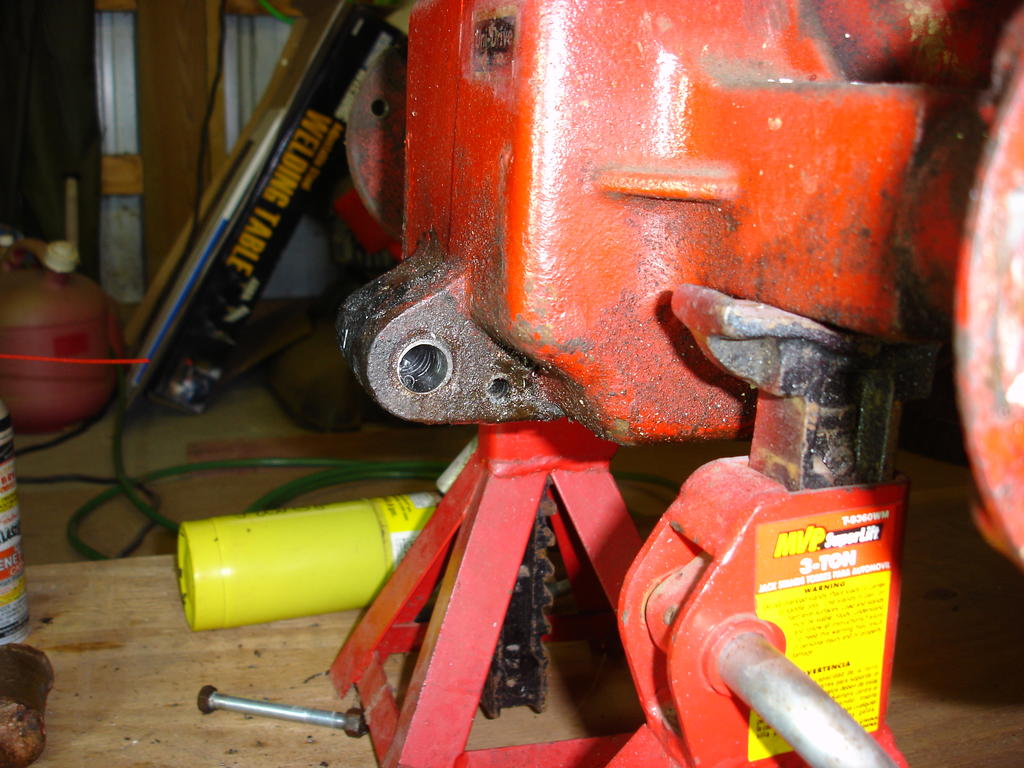

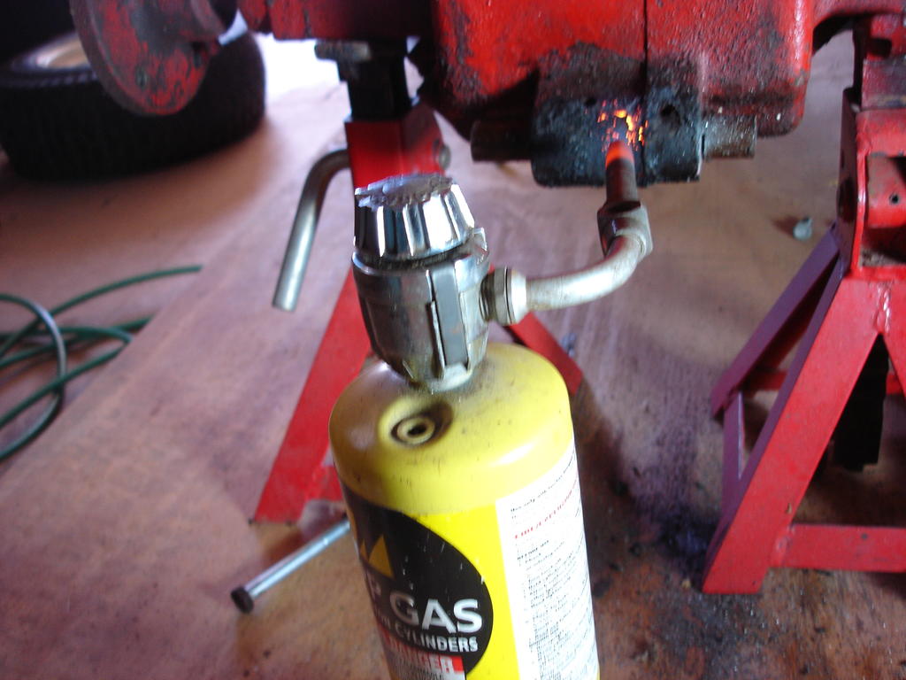

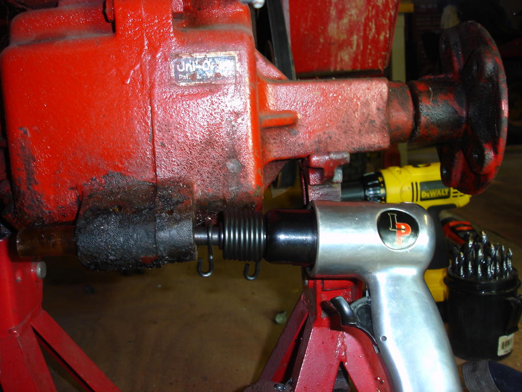

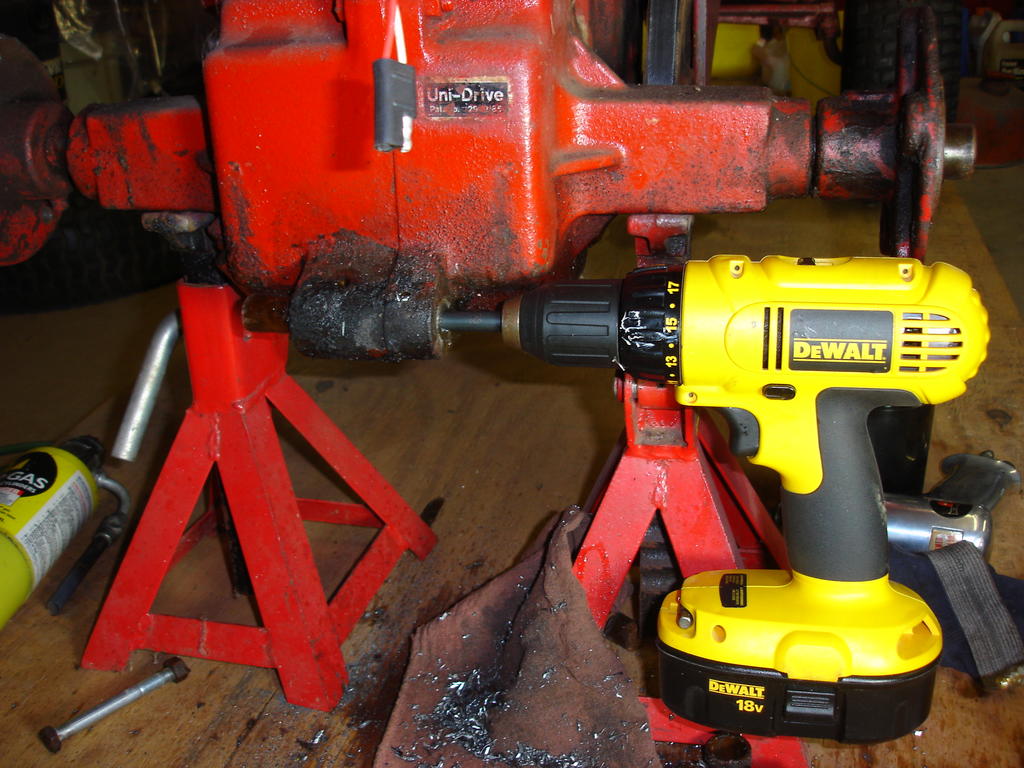

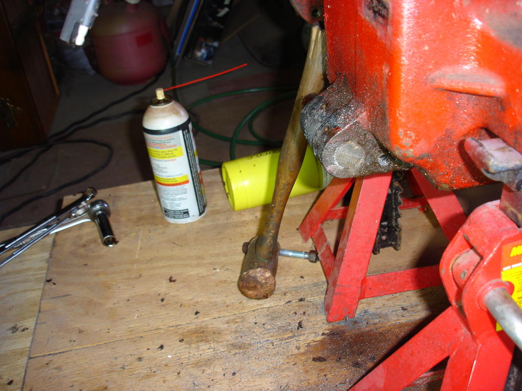

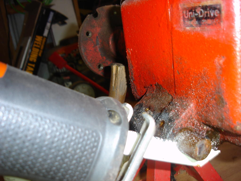

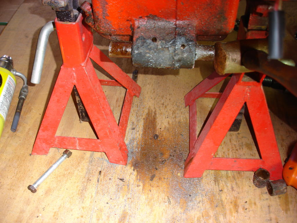

Marv 994 #1 Posted March 17, 2018 (edited) I have had this C100 for quite a while. I don't use it much. Based on the mushroom on the pin, someone had tried to remove it. The draw bar had been modified and I wanted to return it to original. So, a year or so ago I started working on it. I applied penetrant and tapped it with my small tapping hammer to set up vibration. Didn't work so I drilled the boss to allow for penetrant to get to the pin. Frequently, during that time until now I would add penetrant and tap, tap, tap. Then I struck it with a bigger hammer. Didn't move. Decided to give it a little heat to suck the penetrant in. Still didn't move. I decided to take drastic measures and cut the pin. I cut it flush with the boss (note that I removed the rear bottom bolt from the transmission case to allow clearance for the blade). Started drilling. I started off with a 7/32 drill bit and stepped it up in 32nds all the way to 5/8. I did not drill all the way through the boss I stopped short to be sure the pin would not break off inside the boss (that would be a bummer). I worked from the right side because I am right handed AND TO PROTECT THE NARROWER BOSS ON THE RIGHT SIDE. Ok, now I am ready. Impact hammer here we go. Rat a Tat Tat Tat, it is out. Ruler shows depth of the drill. Edited March 18, 2018 by Marv 3 5 Share this post Link to post Share on other sites

classiccat 548 #5 Posted March 17, 2018 War of attrition. Good thing for you that an air hammer (along with a steel will) was in your arsenal! I lost count of the # of times mine bailed me out! 3 Share this post Link to post Share on other sites

DennisThornton 4,773 #7 Posted March 18, 2018 Oh my! I had one that I thought wasn't coming out. I had to heat it more than I wanted but an oxy/acet will put a lot more BTUs on it in a hurry. It came out. Looking at what you had to do makes me real glad that it did! 1 Share this post Link to post Share on other sites
Ed Kennell 45,031 #8 Posted March 18, 2018 (edited) Good documentation. That is the exact process I had to resort to remove one of my pins. I used a 4.5 X 1/32" cutoff wheel instead of a sawsall. I am left handed, but I drilled from the right side also so I would be driving the pin toward the larger side of the lug with less risk of breaking the case. Edited March 18, 2018 by Ed Kennell 4 Share this post Link to post Share on other sites
Marv 994 #9 Posted March 18, 2018 11 hours ago, Ed Kennell said: I am left handed, but I drilled from the right side also so I would be driving the pin toward the larger side of the lug with less risk of breaking the case. Thanks Ed, I had intended to include that in my description. Old minds forget! I edited the post today. Marv 1 Share this post Link to post Share on other sites

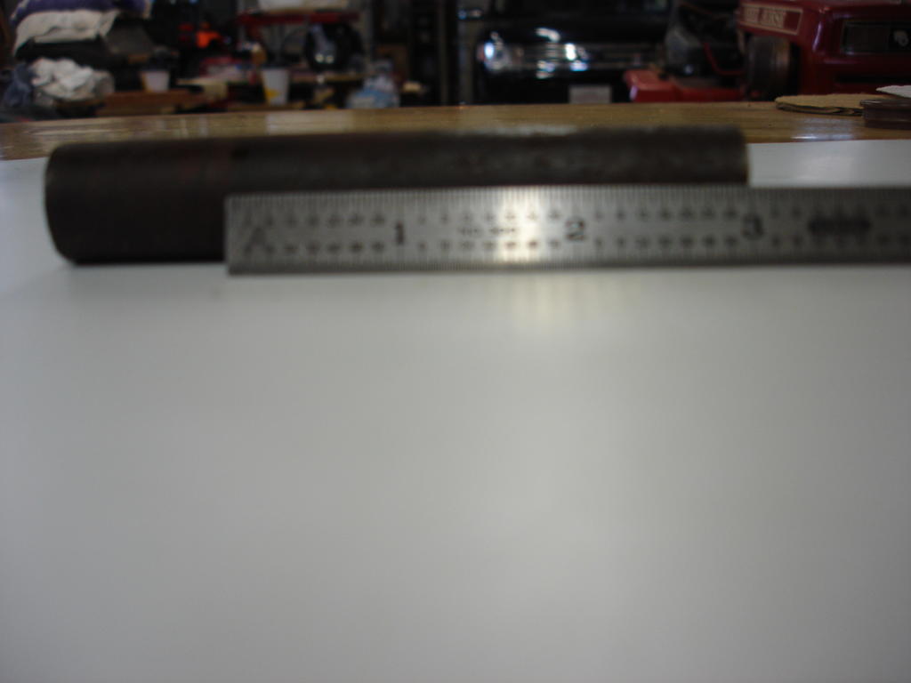

Lee1977 7,571 #12 Posted August 22, 2019 (edited) I change all my tractors to this type of hitch pin.The Wheel Horse pins measure 74.95". The three point tractor pin measure 74.75" .002 thousands smaller plus they are plated. Edited August 22, 2019 by Lee1977 Share this post Link to post Share on other sites
