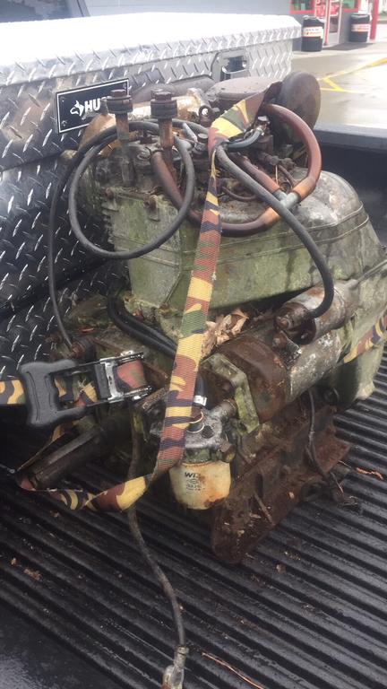

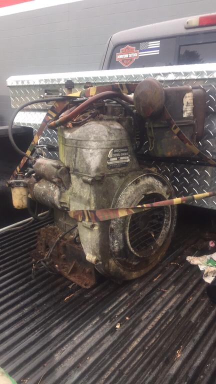

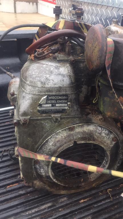

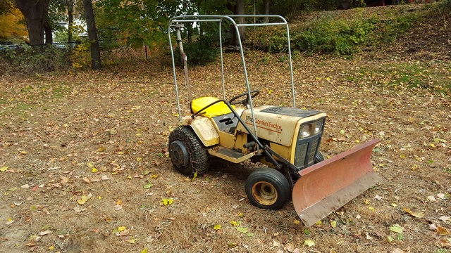

Nathanielperz 150 #1 Posted March 17, 2018 This'll be my first post in a while but I picked up a Wisconsin 2 cylinder diesel engine about a year ago and I was wondering if any of you guys have heard of them. Most people I talk to about it I usually get "I never knew Wisconsin made diesels" so I guess they're pretty rare. I'm currently looking for gaskets for it. Im also looking for ideas from all of you guys about how I could convert the 1276 to a transmission with a driveshaft rather than a belt. I'd also need to reroute my steering mechanism. Looking forward to hearing you guys' solutions and ideas! thanks, Nate 2 Share this post Link to post Share on other sites
pfrederi 20,665 #2 Posted March 17, 2018 Wow 20 hp and torque to die for. Might be easier to put this baby on D series...May destroy the pump coupling however.... http://classic-engines.com/engines-2/wisconsin/2/ Share this post Link to post Share on other sites
Nathanielperz 150 #3 Posted March 17, 2018 I think I was leaning more towards a Cub Cadet transaxle. Gear driven, driveshaft, and it has a granny gear so it'd pull like a champ. I'd really like to stay away from hydrostatic because like you said it might destroy the pump coupling. Unfortunately however, I haven't been able to find any parts for this engine. All it really need is a gasket set which i could probably make but some of them are really oddly shaped. Thanks, Nate Share this post Link to post Share on other sites
