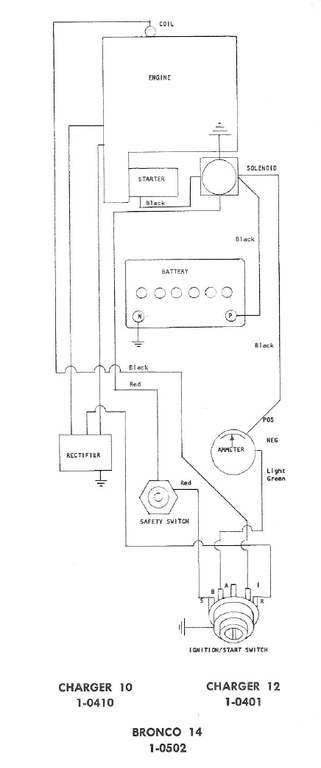

rmaynard 17,219 #10 Posted March 20, 2018 What year is your Charger 10? On the 1972, it's only in the start circuit. Share this post Link to post Share on other sites

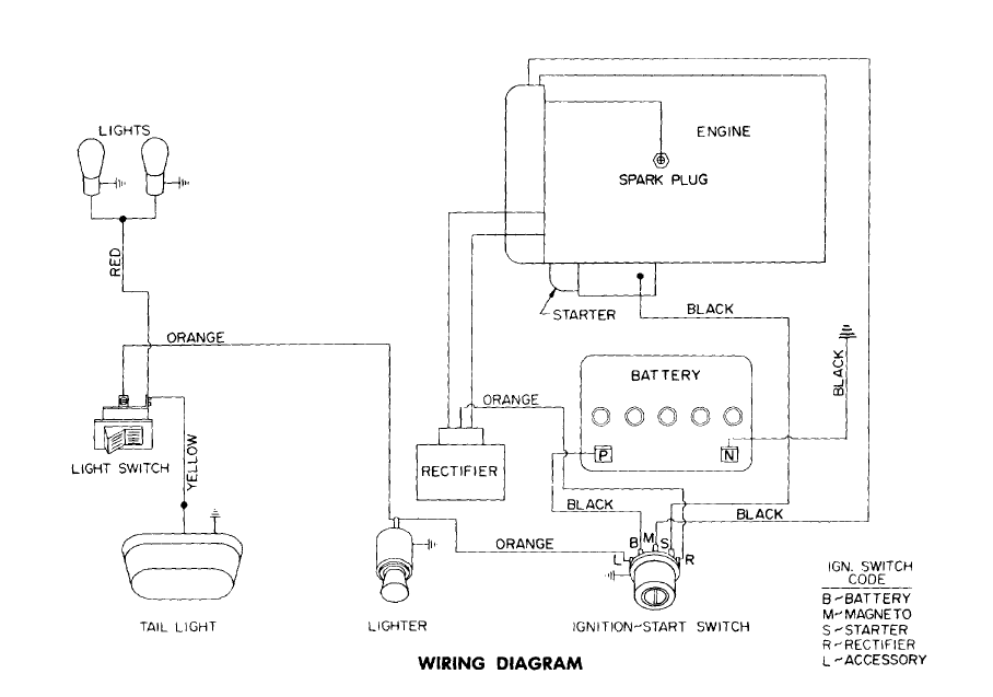

rmaynard 17,219 #11 Posted March 20, 2018 (edited) 1972 with Kohler Engine 1969 with Tecumseh Engine Edited March 21, 2018 by rmaynard added 1969 wiring diagram Share this post Link to post Share on other sites

rmaynard 17,219 #15 Posted March 21, 2018 The 1969 has a Tecumseh engine with no solenoid. The starter circuit goes directly from the battery through a high amperage switch to the starter. The 1972 has a Kohler engine with a solenoid to power the starter. Neither engine has a oil level switch. Share this post Link to post Share on other sites
