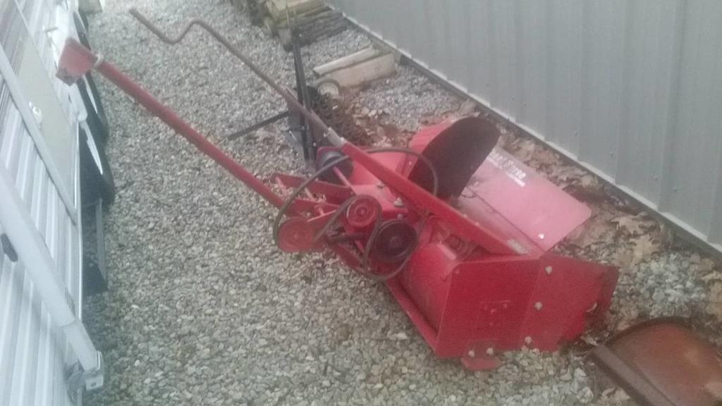

rwmastel 47 #1 Posted March 16, 2018 (edited) This snow thrower (pic) and a WH push blade are for sale in my local area and I have a Toro/WH 314-8 I'd like to use them with. I looked in the manual section of this site and found something for a 1980's 06-42ST04. Manual doesn't say what tractor models it fits. Is there a implements/attachments cross reference to tractor models? Edited March 16, 2018 by rwmastel Share this post Link to post Share on other sites

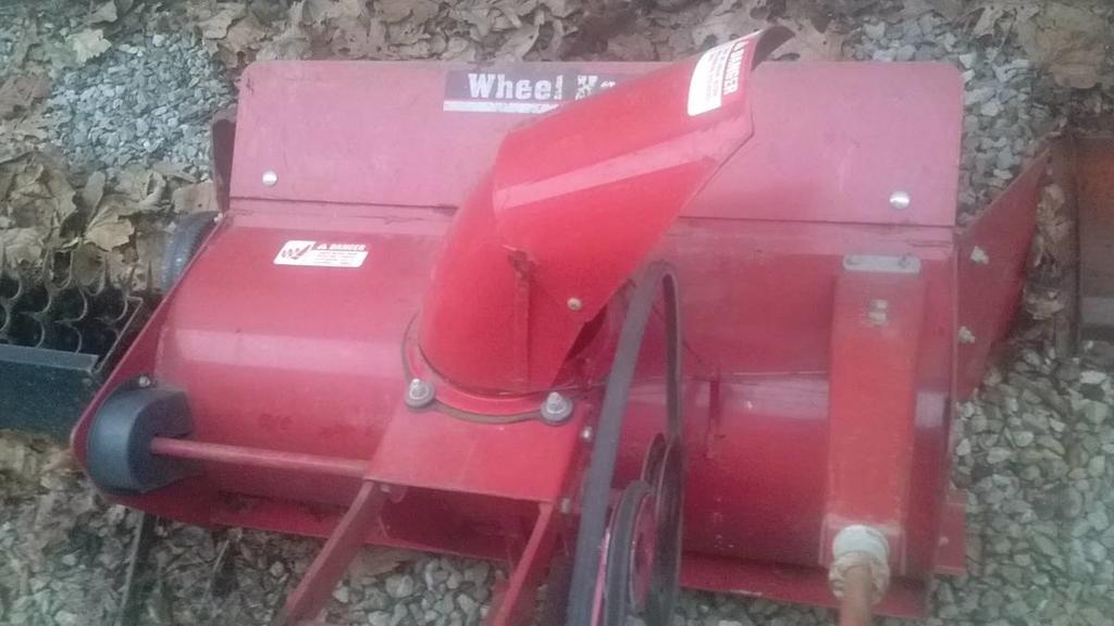

rwmastel 47 #3 Posted March 16, 2018 (edited) Another two pics. I have the manuals for the exploded parts views printed out. Nice to see this has a lift tube and belt included. Looks like the chute rotation cable might even be intact. I've never had one of these before. Only had my 314 for just over a year, and it's my first riding mower/tractor ever. So, if any one has any suggestions on how I evaluate this with regards to it all being there and it being functional, let me know! Thanks! Edited March 16, 2018 by rwmastel Share this post Link to post Share on other sites

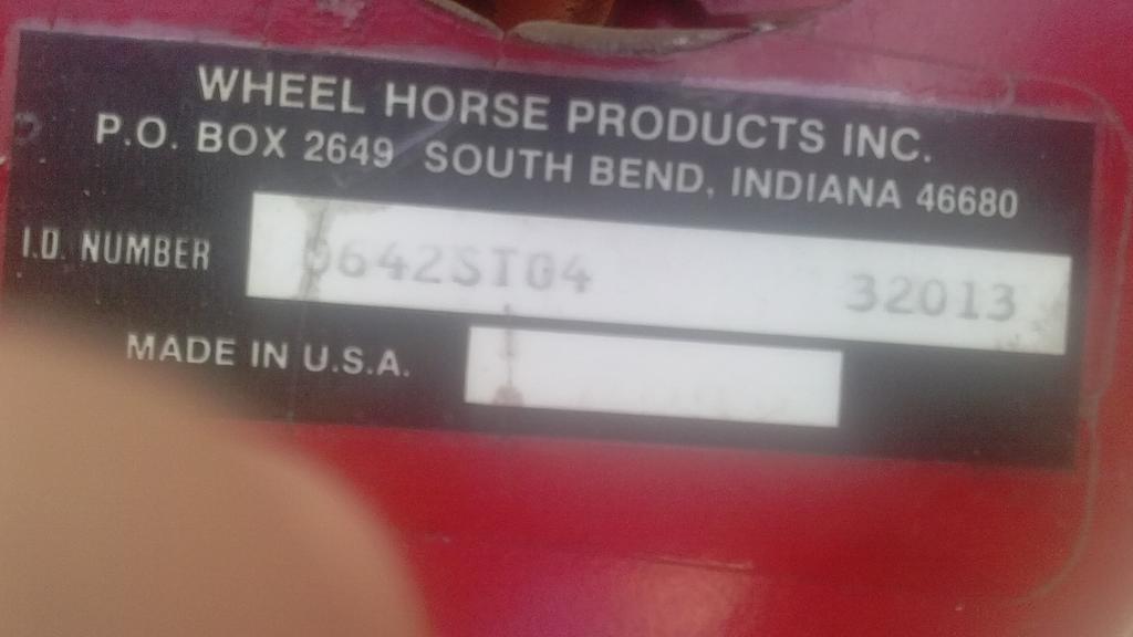

rwmastel 47 #5 Posted March 16, 2018 Oh, and what is the 32013 on the ID tag? The serial number? Share this post Link to post Share on other sites
WHX?? 55,214 #6 Posted March 16, 2018 Yes that is the S/N. this blower will fit just about any late model tractor. You will need the front attach bracket which you already have if you have a deck. 46 minutes ago, rwmastel said: how I evaluate Check all the bearings and chain. These are easily replaced the and plenty of parts around for. Big thing is the auger....check for straightness and carefully check the teeth on the auger driven sprocket for a hooked or very pointed appearance. Check the drive sprocket for the same but not as big a deal as hat can be replaced....auger not so much so. Share this post Link to post Share on other sites

Ed Kennell 45,029 #8 Posted March 16, 2018 (edited) That blower appears to be in excellent condition with everything you need including the lift rod, flag, drive belt and properly installed side wings. There is a lift assist spring available if you find the blower is hard to lift. Make sure you get the lift flag pin in the correct hole in the rock shaft lever as shown on the assembly drawing. And both idler/tension pulleys go on the bottom loop of the belt as they are now on the picture. If the auger is in as good a condition as the paint and decals, you have a slightly used blower. Edited March 16, 2018 by Ed Kennell 1 Share this post Link to post Share on other sites

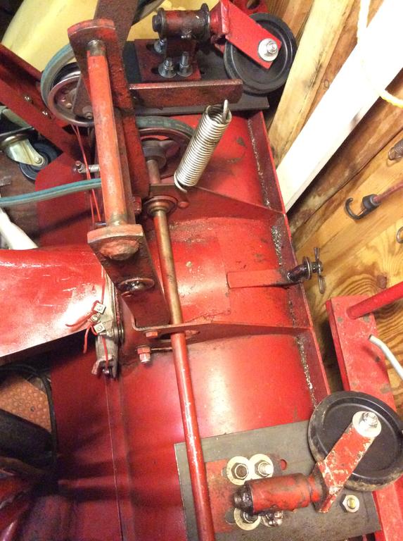

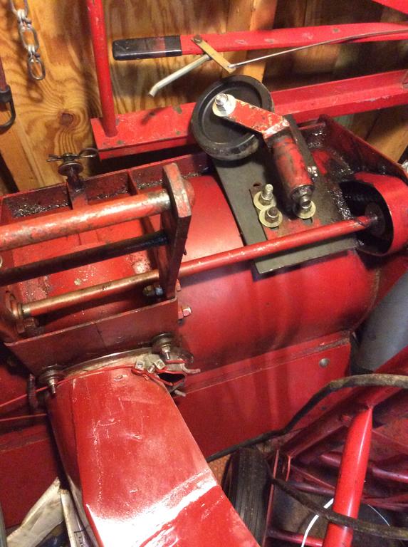

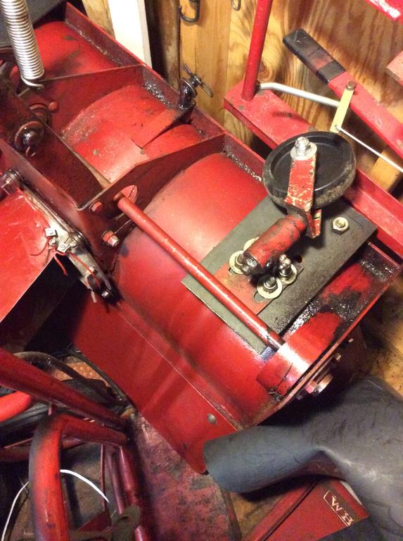

peter lena 9,779 #18 Posted April 16, 2018 retired1946@att.net hi ed, found a way on pictures. found a set of gravely snow blower swivel wheels, I think 1982, welded 4 bolt studs to back of blower housing, 2 on each side. then cut some 1/4" steel plate for backing mount, that way the plate squared off against the studs and lower angle brackets bolted to lower blower frame rail, very solid , no flexing. Only issue was grinding vertical slots for swivel adjustments. I have to pick up blower to back up, but that's the only penalty . blower just cruises from lawn to paved driveway. I wanted to stay inside of the forward " wing " width for ease of swivel wheel. on blower chute, I changed over to 1/4" electrical lugs to replace the screw type cable clamps, drill out the pop rivet , bolt on the lugs, simple and bombproof, also use 100lb nylon weed cutting line, very smooth and no binding, use silicone grease. Kevlar belt. as usual ,I find tweaking the original design with a number of " what if " ideas corrects a problem and makes for very easy use. also bolted electrical lug to battery post, simple go to power site. pete Share this post Link to post Share on other sites
Ed Kennell 45,029 #19 Posted April 16, 2018 for the photos and the write up. I have fixed wheels on my blower and they work great to keep the auger up out of the stones on my gravel road. The problem is ,when the blower is down, it steers the tractor. Those swivel wheels would solve that problem. Share this post Link to post Share on other sites
