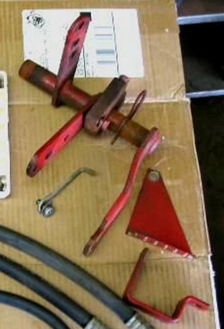

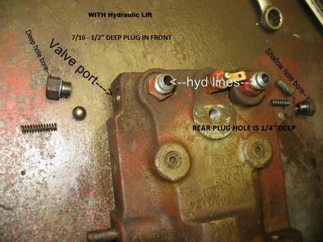

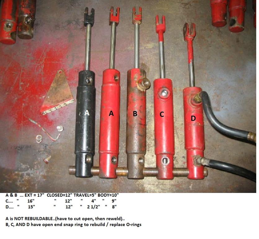

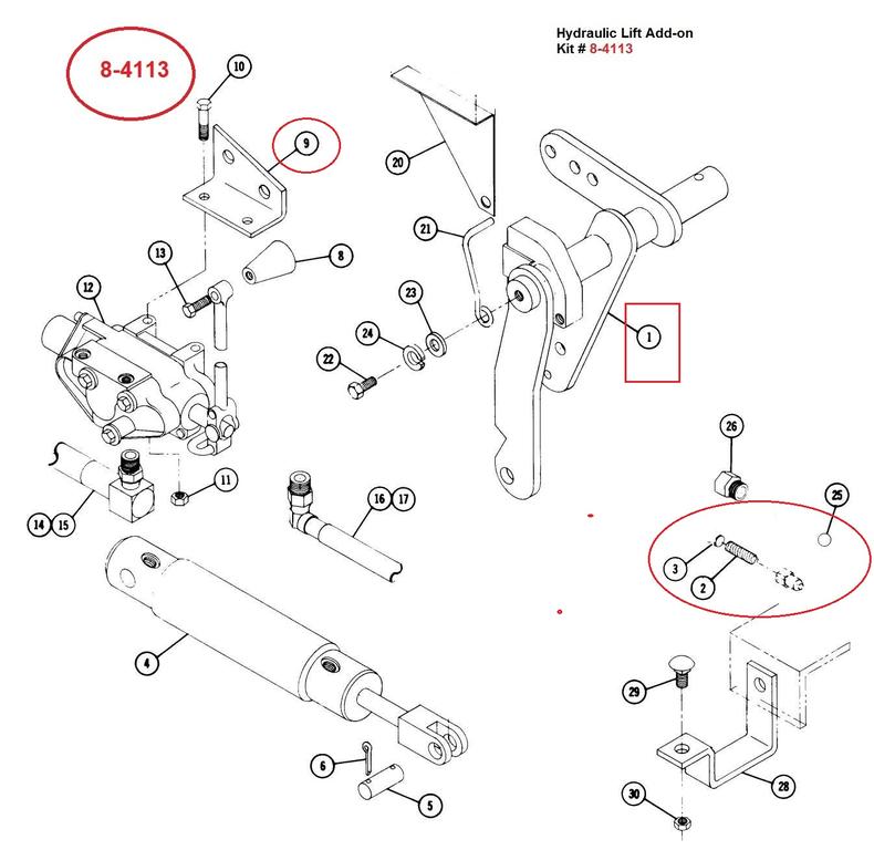

daveoman1966 3,884 #3 Posted March 16, 2018 (edited) I also hae a '76 C-160 with hydr lift...love it. You can add the lift package and here is the kit, NLA from wheelhorse. I can provide red-circled items the cone ,spring, and valve (# 2, 3, & 25) for the hyd pump and the control valve. You need to find # 1 as it replaces the manual lift handle. I am not sure if the RAM from the C-125 is long enough to accommodate the lift mechanism hardware of the C-160 though. You would need cyl A or B in this pic....others MAY be too short. Edited March 16, 2018 by daveoman1966 2 Share this post Link to post Share on other sites
Sarge 3,473 #4 Posted March 17, 2018 I do believe the earlier cylinders used on Sundstrand-equipped C series were the longer ones, same as the pre-'73 tractors. I remember trying to use a newer cylinder on the old 1277 and it was too short in it's stroke, replaced it with an early C cylinder as it was the same length as my welded original that blew the stem seals. Piston rod was scored badly, so no weld/repair on that one without machining a new shaft completely. Excellent pics/description of those parts Dave - that should be in a book somewhere as it's hard to find side by side descriptions with dimensions on these parts. Sarge Share this post Link to post Share on other sites
