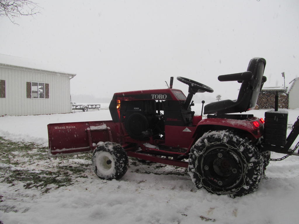

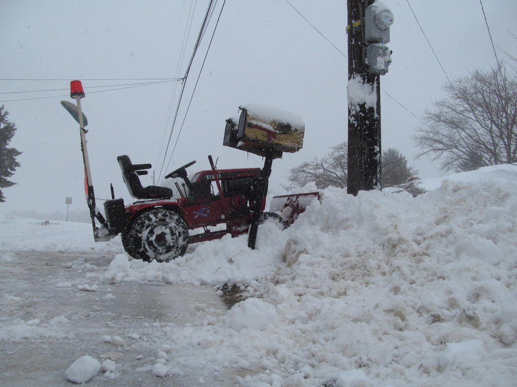

Ed Kennell 47,618 #29 Posted March 30, 2018 (edited) I did notice the 6" front wheels have been changed to 8". I made the same change to my 312.....mainly to increase the clearance under the front axle to get more plow lift for stacking snow. It does change the stance of the tractor and you will have to do some tweaking to get the deck to sit properly. I have never had a 48" deck on mine, so I don't know if the larger wheels would create a clearance problem, but it is something to consider when selecting a deck. Edited March 30, 2018 by Ed Kennell 1 Share this post Link to post Share on other sites
