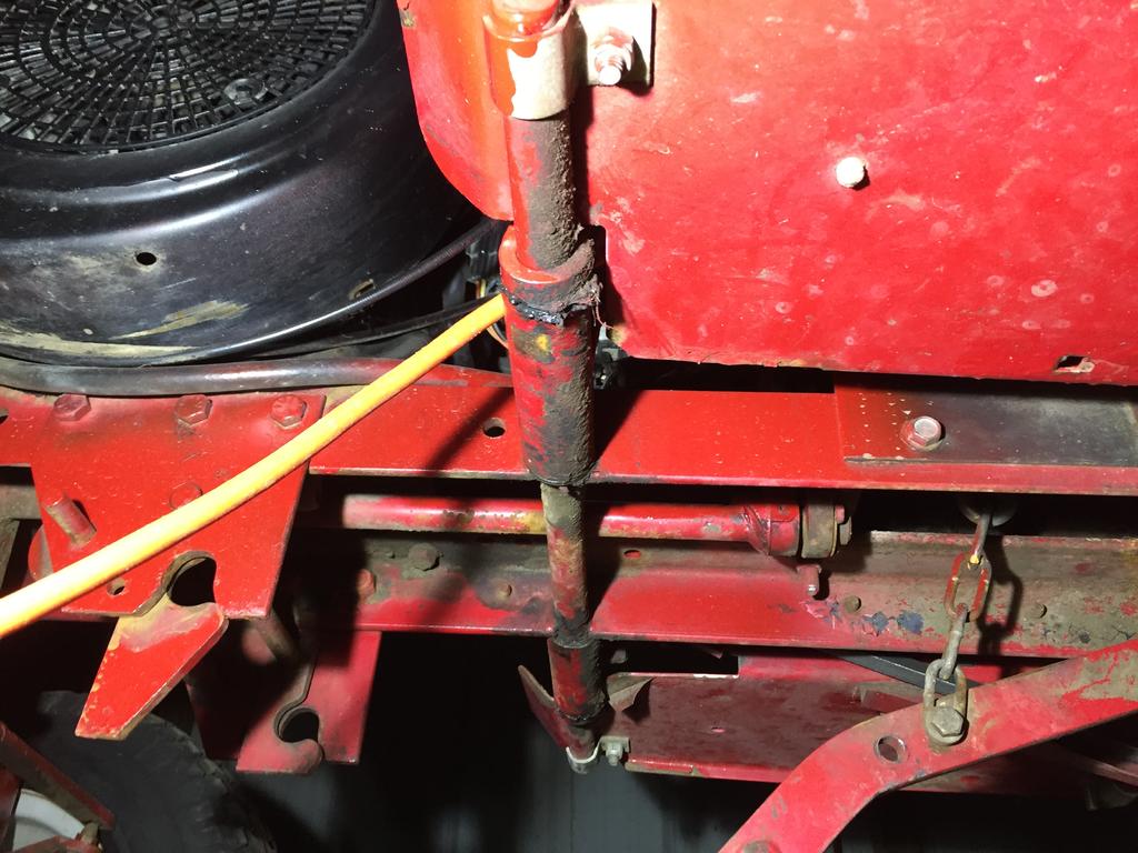

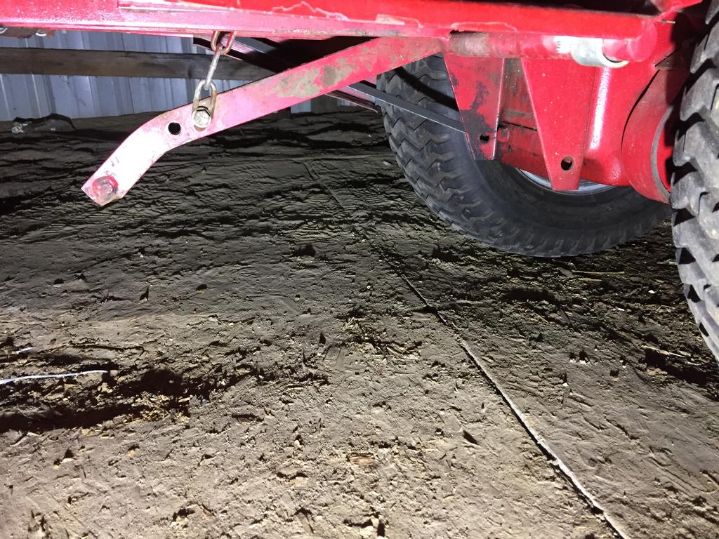

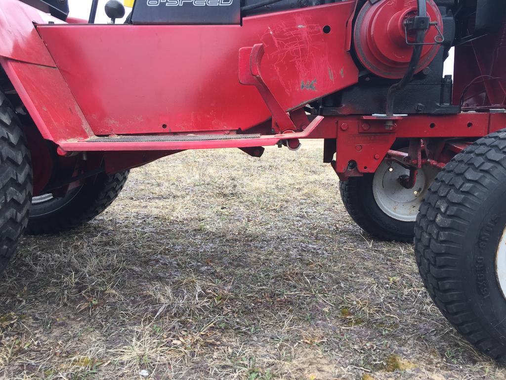

Picks. I swore I would never buy a garden tractor again, but I have fallen in love with the Wheel Horse. True to what I have heard, It took me all of 15 minutes to remove chains, wheel weights and snow plow. If we get anymore snow here in West Michigan, it won't be enough to require plowing, so thought I would get her ready for spring. Going to try to pick up a mowing deck before 2nd rotator cuff surgery in a couple of weeks. Picking up a mule drive tomorrow, not sure if I need another atach o matic for the under belly or not? Any help would be appreciated.
Edited by Jake0030

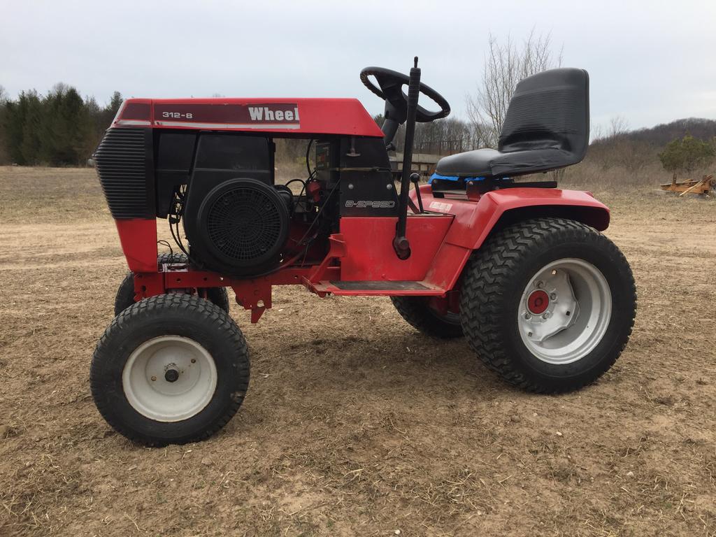

Jake0030
Battle damage from being a newb and not pinning or bolting the back clamps to the plow. I'll get her fixed up.

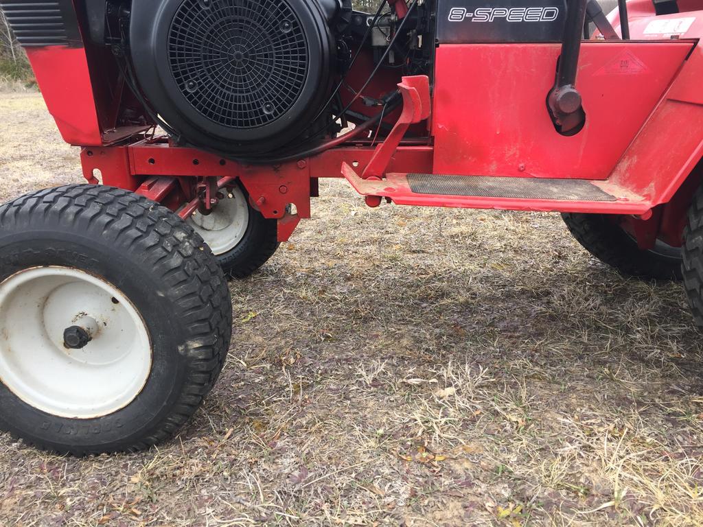

Jake0030
Front and Engine Kohler 12 magnum :
Ed Kennell
No, you don't need another attach-a-matic . The deck will mount to the mid and the mule drive to the front. You will need the deck lift bar.  I don't see one in the pics, unless it is tied up to clear the plow frame.
  • Like 1

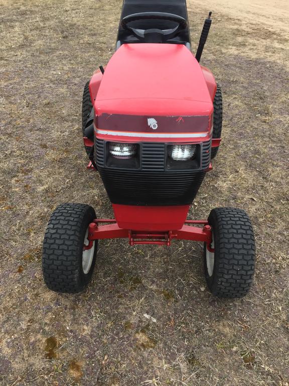

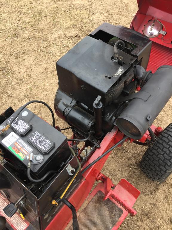

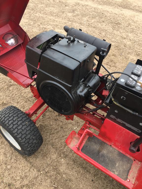

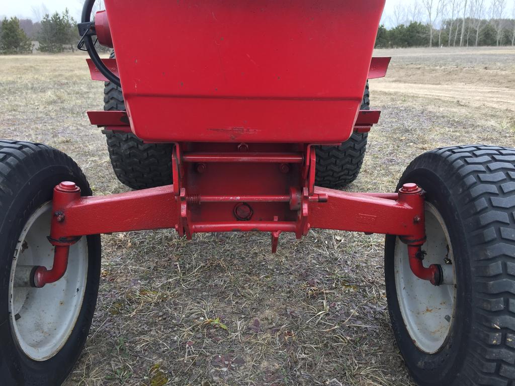

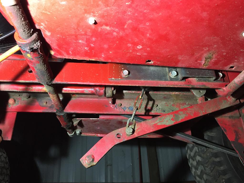

Jake0030
Here is what I have. Hope this helps. And thanks for the help- Ornage/yellow cord is extension chord hooked up to battery tender.
Ed Kennell
You have what you need Jake.   I just couldn't see it  in the pics.
  • Like 1
