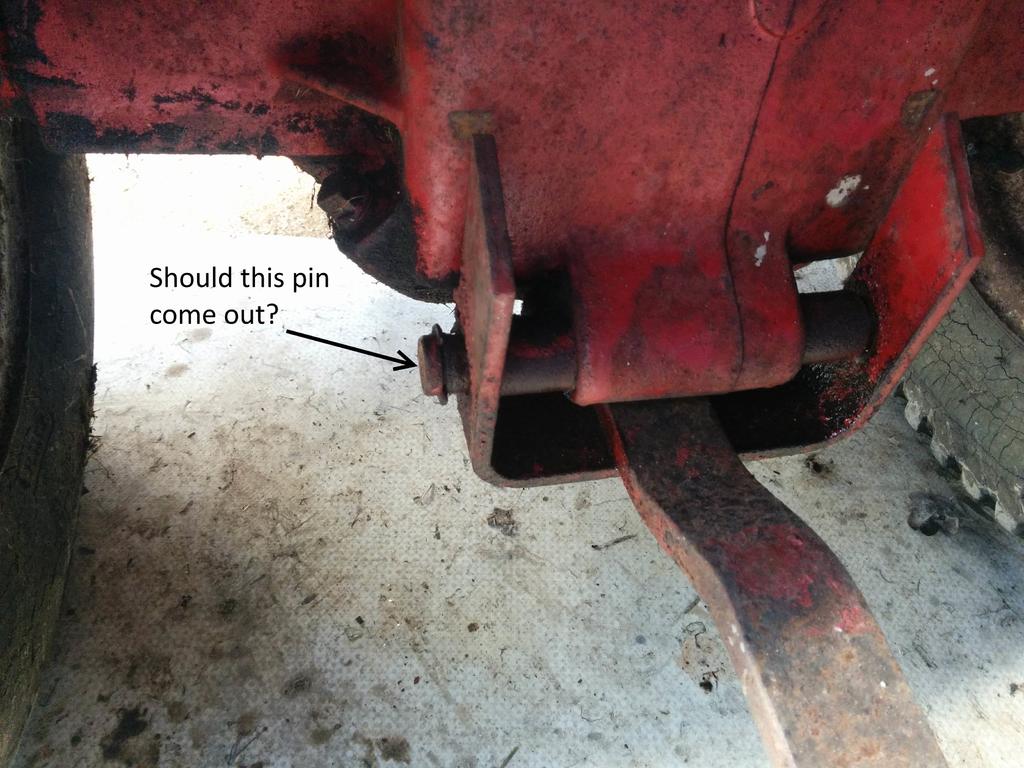

ChrisJordan 46 #1 Posted March 13, 2018 (edited) I have recenty bought a 312-8 which is scruffy but running quite well. I want to make a 'wheelie bin' (garbage bin) carrier to fit on the back to take the bin down our 400yd long track, but cant figure out how to remove the existing towing hitch. Should the pin supporting it tap out after removing the circlips? I have tried penetrating oil and warming it to free it, but it seems jammed solid. Any advice welcome! Edited March 13, 2018 by ChrisJordan Spelling! Share this post Link to post Share on other sites
WVHillbilly520H 10,379 #2 Posted March 13, 2018 (edited) Yes it does come out, need to remove 1 cir clip so it can pass through, most likely rusted/painted fast, that's also the pin that holds the clevis hitch when installed, Jeff. Edited March 13, 2018 by WVHillbilly520H Share this post Link to post Share on other sites
pfrederi 21,055 #3 Posted March 13, 2018 Yes it should and along with Steering Wheel removal and rear hub removal it can be one of the more difficult things to do. There get corroded in there . Big hammers, air chisels are a start. Share this post Link to post Share on other sites

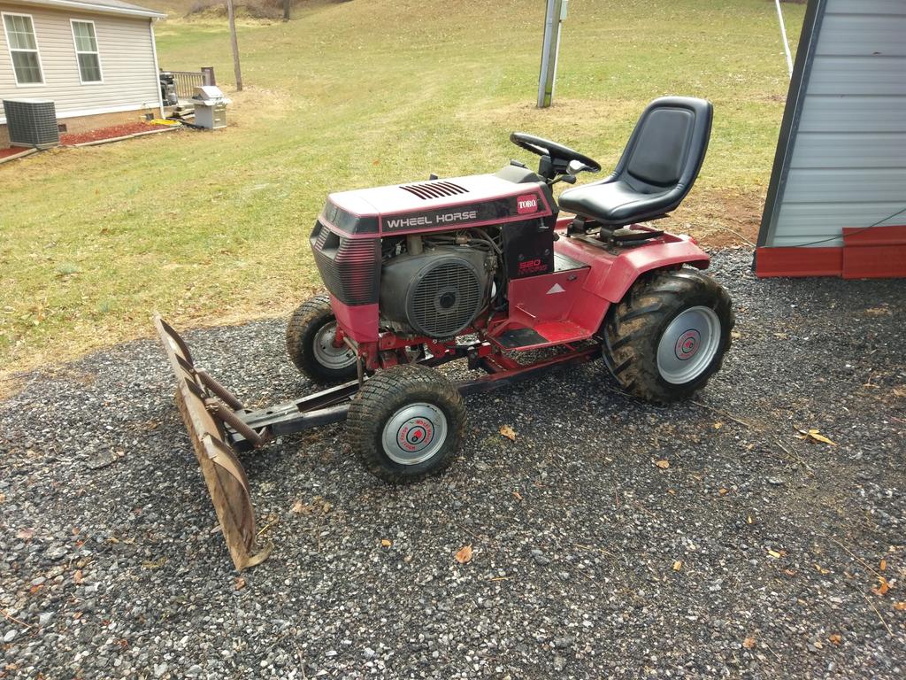

ChrisJordan 46 #4 Posted March 13, 2018 Thanks for the info, I guessed that was the case, it's probably never been out from new! I don't want to use too much force in case of damaging the casing, so will be patient and use alternate penetrating oil and heating to see if I can free it. Very interested in what looks like a front blade you have fitted Jeff, any chance of a photo oor two? Chris Share this post Link to post Share on other sites
Tankman 3,528 #5 Posted March 13, 2018 Penetrating oil, I like PB Blaster. Using a brass drift; spray lube, tap, ta, tap. Some today, more PB Blaster and tap, tap, tap;; tomorrow. The brass drift won't disfigure the steel pin. Be patient. Took me a few days but eventually the pin came out. Clean all, emery cloth shine! Polished! New clips. Never-Seez before reinstalling the pin. Add "Lube, Hitch Pin" to your PM (preventative maintenance) routines. 2 1 Share this post Link to post Share on other sites
lynnmor 9,013 #6 Posted March 13, 2018 Go easy with the heat, you have a gasket right there and to replace it would not be fun. That pin was completely loose when new and that is what you want when done. 2 Share this post Link to post Share on other sites
ChrisJordan 46 #7 Posted March 13, 2018 Good point there lynnmor, I'll go easy on the heat, just a hot air paint stripper not a torch! Will take your advice Tankman there's no rush, I'll let it soak between attempts. Thanks again for all the info. 2 Share this post Link to post Share on other sites
Ed Kennell 47,013 #8 Posted March 13, 2018 There are many posts on here describing the many techniques used to remove these stubborn pins. They include penetrating liquids, drilling small holes in each half of the casing lug to get the penetrant to the pin, heat and candle wax, drilling the pin nearly thru and driving the pin out using a drift inside the drilled pin, cutting the pin in three pieces with a radiac wheel to remove the hitch and then press the pieces out on a press and drill the center piece out of the tranny. Just search "frozen hitch Pins or hitch pin removal" and you will find the horror stories. GOOD LUCK 3 4 Share this post Link to post Share on other sites
KC9KAS 4,746 #9 Posted March 13, 2018 @ChrisJordan As you tap the pin with the brass drift....work it one way...penetrant....work it the opposite direction....penetrant,,,etc, etc. It will soon drive all the way out. 3 Share this post Link to post Share on other sites
stevasaurus 23,805 #10 Posted March 13, 2018 Nobody has said yet to run a file on the ends to clean that up. You don't want it to start moving and then the end is mushroomed. Work the hitch up and down to loosen that part. Don't be afraid to use some torch heat and then some candle wax. An air hammer with a blunt end bit can get things started also. In the end...a sawz-all gets it done...drill it out and be done with it. It is a 1/2" rod you can get at ACE, TSC, ETC and either set it up for a "C" clip or a Carter Key. 2 1 1 Share this post Link to post Share on other sites
pfrederi 21,055 #11 Posted March 13, 2018 7 minutes ago, stevasaurus said: Nobody has said yet to run a file on the ends to clean that up. You don't want it to start moving and the the end is mushroomed. Work the hitch up and down to loosen that part. Don't be afraid to use some torch heat and then some candle wax. An air hammer with a blunt end bit can get things started also. In the end...a sawz-all gets it done...drill it out and be done with it. It is a 1/2" rod you can get at ACE, TSC, ETC and either set it up for a "C" clip or a Carter Key. I think it is 3/4" 4 1 Share this post Link to post Share on other sites
stevasaurus 23,805 #12 Posted March 13, 2018 Sorry Paul...my older ones from the 60's are 1/2"...the newer ones are probably 3/4" don't know...but a sawz-all still works. Share this post Link to post Share on other sites

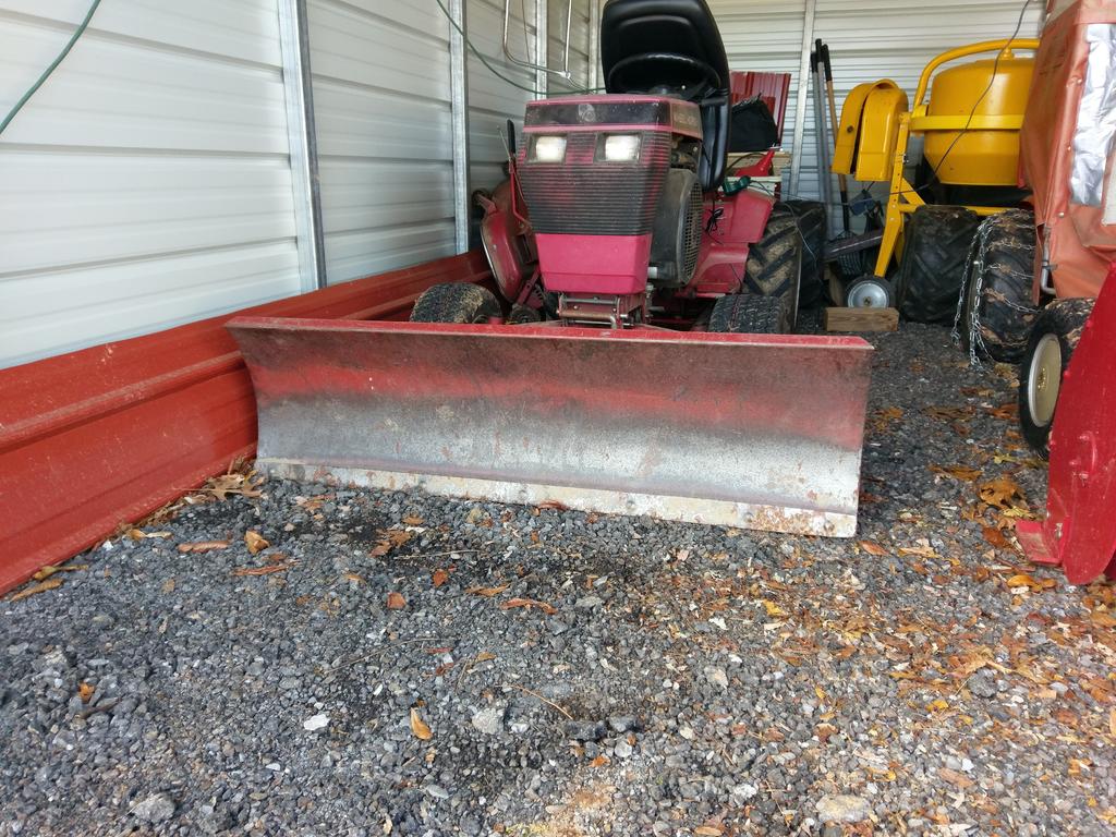

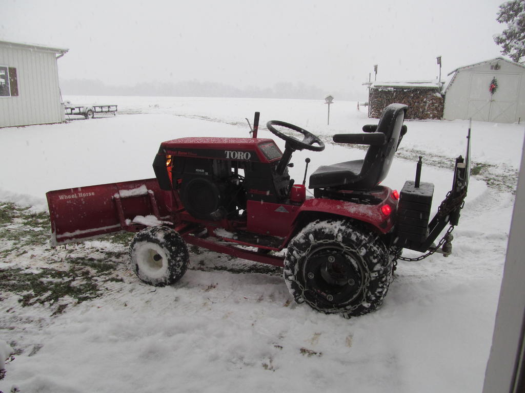

Ed Kennell 47,013 #14 Posted March 14, 2018 You asked Jeff for a pic if his dozer blade Chris. Here is the 48" blade on my 312H. 4 Share this post Link to post Share on other sites

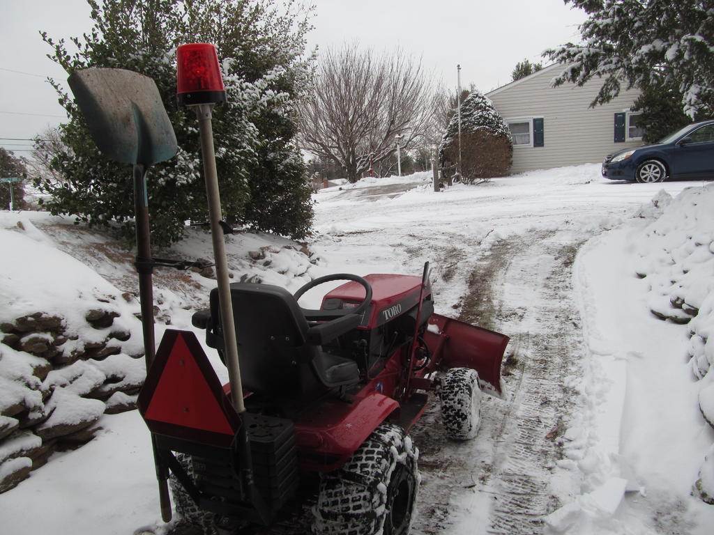

WVHillbilly520H 10,379 #18 Posted March 14, 2018 Looks like this after pushing a bit of slushy snow... 1 Share this post Link to post Share on other sites

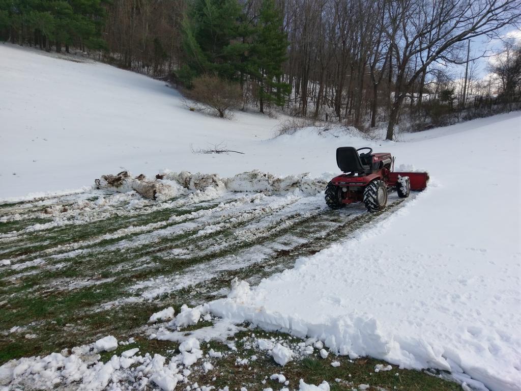

ChrisJordan 46 #19 Posted March 16, 2018 'Morning everybody, thanks for all the info. I am going to taking the slow and gentle method to get the pin out; heat/wd40/tap one way then the other. I'll give this a week or so as there is no rush, hopefully it will work if not I can borrow a hydraulic gear puller that might be persuaded to push it out. Great photos of the snow plough/dozer, it's amazing what pushing power these tractors have! How do you think a blade like these would handle grading our track? I will be using stone a little coarser than in Jeff's photos. I can get the delivery truck driver to draw the pile out as he tips it, but it will still need a lot of pushing around to fill the potholes. Share this post Link to post Share on other sites
cleat 9,230 #20 Posted March 16, 2018 WD40 is not penetrating oil. get some kroil or other real penetrating oil and you will stand a better chance. 2 Share this post Link to post Share on other sites
WVHillbilly520H 10,379 #21 Posted March 16, 2018 2 hours ago, ChrisJordan said: How do you think a blade like these would handle grading our track? I will be using stone a little coarser than in Jeff's photos. I can get the delivery truck driver to draw the pile out as he tips it, but it will still need a lot of pushing around to fill the potholes. Slow and easy and these little snow/dozers earn their keep no matter was substance they are pushing/grading, Jeff. Share this post Link to post Share on other sites

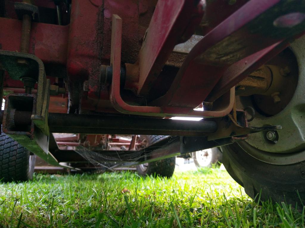

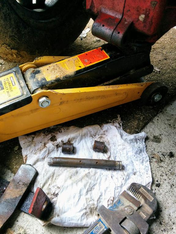

ChrisJordan 46 #22 Posted April 9, 2018 It's out at last!!! A combination of penetrating oil (ATF + Acetone), tapping one way then the other, drilling oil holes in the casting, heating it up, and finally what shifted it... A large pair of stilsons on the left hand end and twisting hard! You can see the teeth marks on the left hand end of the pin. The stilsons had to go on so that I pulled up to turn the pin, no room the other way round. I put the jack under the handle of the stilsons and raised it so that it was lifting the back of the tractor, then I jumped onto the seat, that shifted it! Next jobs; get a new pin from our local agricultural supplier, ream the casting out and fit grease nipples, then I can get on with making the bin carrier at last. Annoyingly I missed a fairly complete snow plough/grader add-on that was on ebay last week, so I think I am going to have to make one from scratch they are very rare here in the UK. Plenty of drawings around though so I should be able to copy a tried and tested design. Thanks to all for the suggestions and photos, they were a great help. Share this post Link to post Share on other sites
