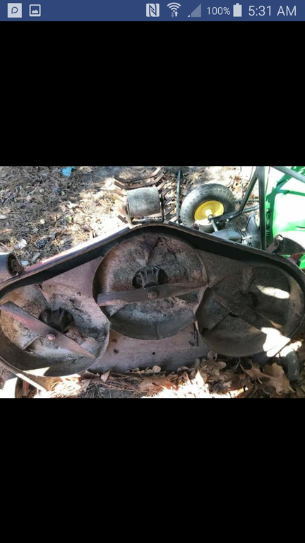

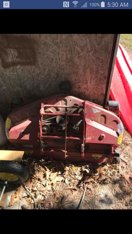

SteveK440 30 #1 Posted March 13, 2018 Found a rear discharge deck for $100 about 60 miles from my house I was thinking of buying but want to know a couple of questions from experienced users. How do these perform with tall grass wet and dry? Have you noticed if they sling grass clippings down below the shifter plate? Also, does the attached photos appear to look like a 42 in.? 2 Share this post Link to post Share on other sites
Lane Ranger 12,151 #2 Posted March 13, 2018 (edited) Yes that is a 42 inch deck. They work well and I prefer the rear discharge for safety . If you cut your grass regularly and not let it get too tall they work fine. Tall grass wet or dry will leave irregular cut and windrows. Edited March 13, 2018 by Lane Ranger 3 1 Share this post Link to post Share on other sites

lynnmor 9,051 #6 Posted March 13, 2018 Apparently that is a recycler deck with the round baffles and the bumps above the blades. High grass might choke it up with all those baffles keeping the debris inside. I have the open deck without any baffles that I use with a sweeper for fall cleanup.. Without the sweeper it lets some real ugly rows, but I would bet that the recycler would have less of that effect as long as it doesn't choke up. 2 Share this post Link to post Share on other sites
peter lena 10,091 #7 Posted March 13, 2018 been using r/d decks for years, most important is the change over of drive belt, a s/d deck drive belt is about 6" longer than the r/d belt .if you cannot tighten up your drive belt, the deck will never get up to speed. depending on what model and year you have they are different. another thing, the bottom side of that looked " starved " for lubrication and cleaning. both vital for long rot free life . check for spider cracks near spindles , indicating impacts with rocks or stumps. if you are lucky maybe the guy has been using the wrong belt and is selling it , because it never cut right. I recently picked up a near new 42 r/d that had belt burn marks on the top of deck indicating a loose sloppy drive belt. I use lubriplate chain and cable spray on the underside of my decks to feed the metal and kill of the grunge, along with regular scrap down 2 times a year. if the deck is not cracked or rotted out, it could be a good deal. spindles should be smooth and free. remember, the drive belt is the heart of this deck, mine spins up like its supposed to. Pete. 2 Share this post Link to post Share on other sites

Lane Ranger 12,151 #9 Posted March 13, 2018 Yes as lynnmor says it does appear to be a recycler deck which is also one I have used and they are great. A more expensive deck when first purchased! 1 Share this post Link to post Share on other sites

SteveK440 30 #12 Posted March 14, 2018 Thanks for all your replys. Texted the seller and they claim spindles spin free and no fracture cracks in the deck. They claim they sold the tractor but the buyer didn't want the deck, Go figure... Anyway, I figure the only thing I'm risking is 120 miles of gas and wear on my truck to look at it Sunday. 1 Share this post Link to post Share on other sites

Forest Road 595 #14 Posted March 19, 2018 (edited) You’d be a fool to pass on that deck. I removed the recycler insert from mine. Weighs 1/2 as much now. As long as the deck isn’t cracked or rotted through that’s a steel!!!! Used spindles are easy to come by should you need one. I have a bucket full of deck parts. Hope I never need to use them. I prefer an RD over SD. You can get close to the edges of your lawn on either side. Scrub mine annually down to bare metal. Then spray it down w WD-40. Stand it up for the winter in the shed. No rust to speak of and it’s 24 years old. Edited March 23, 2018 by Forest Road 1 Share this post Link to post Share on other sites
squonk 48,231 #15 Posted March 19, 2018 I have a recycler deck and love it. The only thing is you have to keep it clean. That means occasionally removing the insert and getting all the grass out that gets behind it. Also remove all the triangles and clean behind them. More work but I used to have to sweep after every mow but not anymore. Share this post Link to post Share on other sites
