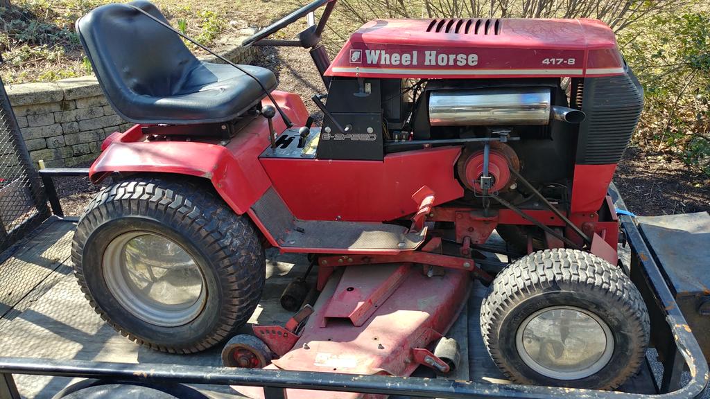

Big_Red_Fred 1,548 #1 Posted March 12, 2018 Hey Men, Its Fred, Question, Having a Brain Fart due to Old Age & to much on the Brain ! As some of you know i Purchased that 417-8, i need a Fuel Pump yet & a New Battery this Friday coming. My Concern is i rebuilt the Carb, i backed both screws out a turn & a Half, is that the correct way or just 1 full turn ? How do you all do it. Thanks for your help. Share this post Link to post Share on other sites
pfrederi 21,183 #2 Posted March 12, 2018 (edited) It would be best to download the Kohler manual from here to see carb adjustments. Edit: as you should also check float setting both level and drop Edited March 12, 2018 by pfrederi 3 Share this post Link to post Share on other sites
WHX?? 58,226 #3 Posted March 12, 2018 That's probably close enough for the women we go out with..... maybe a 'nother half turn out. Should get the motor running and tweak from there. I prefer to turn out a little farther than book and find the sweet spots from there. Carburator adjustments.docx Carburator Reference Manual TP-2377-E.pdf 3 1 Share this post Link to post Share on other sites
Big_Red_Fred 1,548 #4 Posted March 12, 2018 I thought so too Jim, Long day working on Mack Trucks, i do the same, turn out till it rumbles, turn in till smooths out 1 Share this post Link to post Share on other sites
Big_Red_Fred 1,548 #5 Posted March 12, 2018 3 hours ago, pfrederi said: It would be best to download the Kohler manual from here to see carb adjustments. Edit: as you should also check float setting both level and drop Thanks, i got it now , i was off some on adjust ment Share this post Link to post Share on other sites
