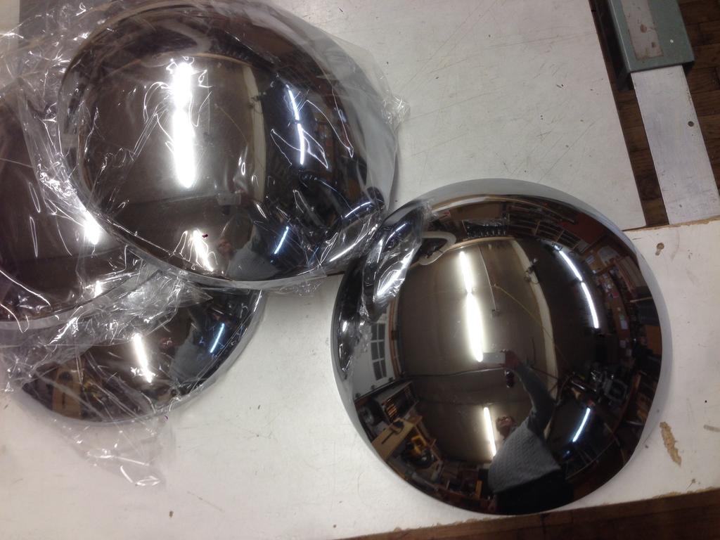

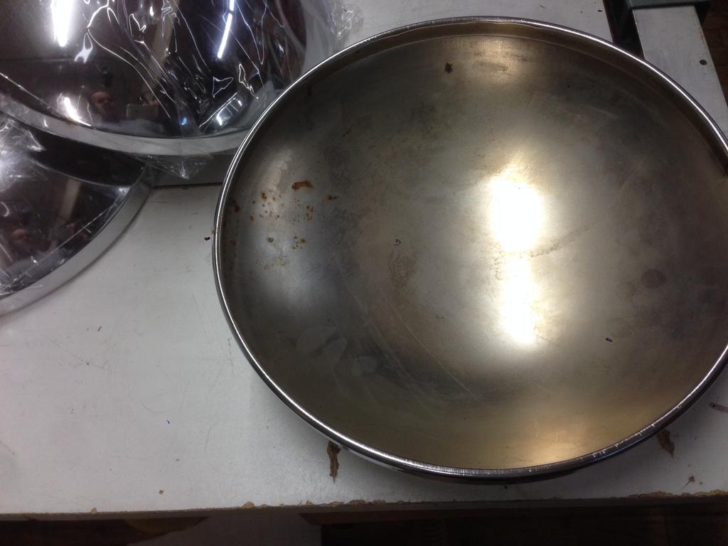

formariz 12,381 #1 Posted March 12, 2018 Found these hubcaps today brand new for $16.00. I don't know what they were for but they fit a 12" wheel nicely. There is no way however for them to "clip" on wheel. They are 10-1/4" in diameter. Is there some type of clip I can use on them or on wheel? They are stainless steel. Share this post Link to post Share on other sites

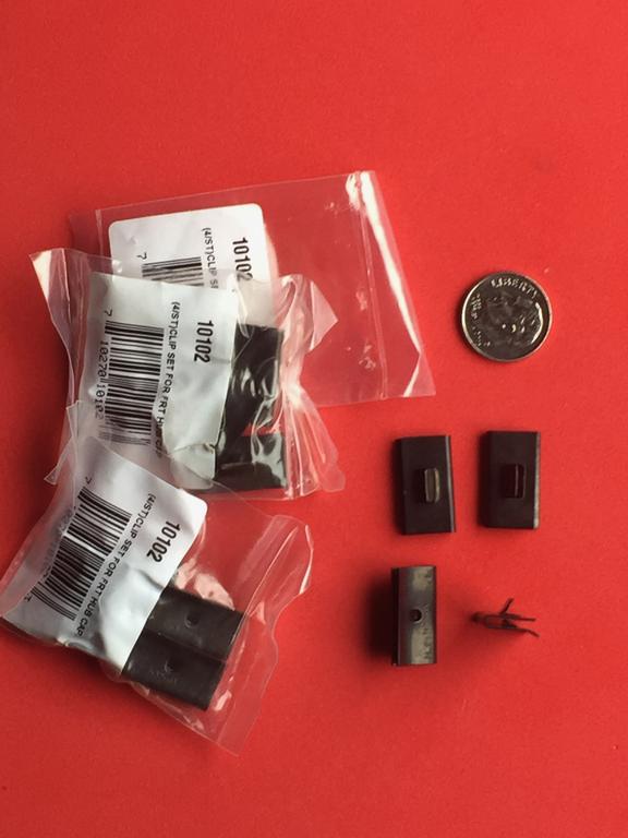

GlenPettit 1,719 #7 Posted March 12, 2018 (edited) Here's a quick photo of the Front Hub Cap CLIPS, each Hub Cap needs four clips to hold itself on. They will dig into the painted wheel and leave little marks under the cap, and these clips can be found at many large truck stop supply stores, also most Auto Stores can special order them for you (but don't rush a special order, have them come in on their regular schedule delivery to save a $5-10 shipping fee). We also have these for $3 for a 4-pack (+$3.50 ship > 4oz) -- [listed under Venders]. Caution: If using just 3 clips, the clips must be spaced exactly to hold the cap on, two clips will not hold the cap on in use, three clips may hold, but four clips will hold the Hub Caps on. If the caps ever fall off, you will very likely not notice it missing until you hear it crunch. Edited March 12, 2018 by GlenPettit 3 2 Share this post Link to post Share on other sites
Retired Wrencher 7,037 #8 Posted March 12, 2018 2 hours ago, GlenPettit said: Here's a quick photo of the Front Hub Cap CLIPS, each Hub Cap needs four clips to hold itself on. They will dig into the painted wheel and leave little marks under the cap, and these clips can be found at many large truck stop supply stores, also most Auto Stores can special order them for you (but don't rush a special order, have them come in on their regular schedule delivery to save a $5-10 shipping fee). We also have these for $3 for a 4-pack (+$3.50 ship > 4oz) -- [listed under Venders]. Caution: If using just 3 clips, the clips must be spaced exactly to hold the cap on, two clips will not hold the cap on in use, three clips may hold, but four clips will hold the Hub Caps on. If the caps ever fall off, you will very likely not notice it missing until you hear it crunch. Well done Glen that is good to know. 1 Share this post Link to post Share on other sites

TDF5G 2,074 #11 Posted March 15, 2018 I'm not sure you can make those caps fit your wheels with the clips, the edges are rolled over on these, there is no provision for clips. The caps that take clips are designed differently. See attached pic. The caps you have are made to pop on over bumps on a wheel or axle bolt heads on a truck. Not trying to be discouraging, just giving you my perspective on it. The silicone idea may work, if these caps fit inside the wheel rim, or perhaps a few layers of duct tape or foil tape. 1 Share this post Link to post Share on other sites
