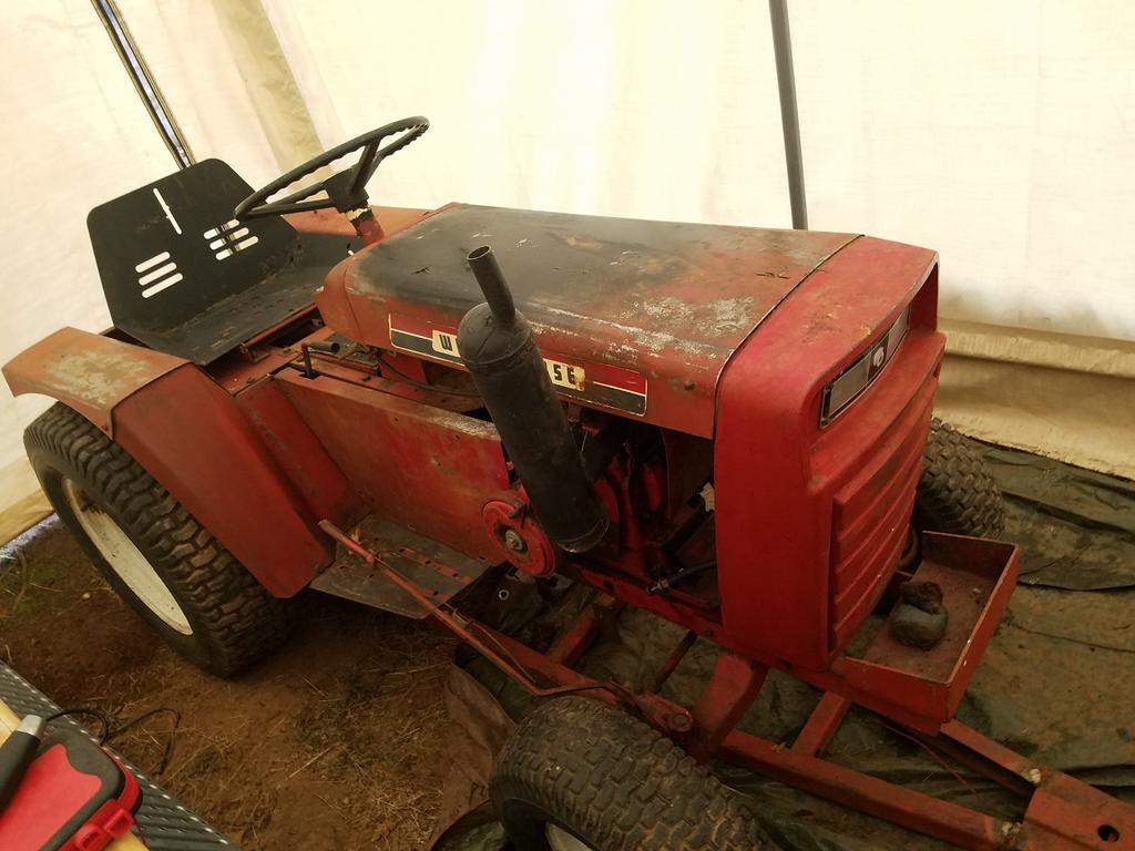

WCL400 39 #1 Posted March 11, 2018 Can anyone tell me what size belt I need and where to get one for my GT -14? I am also looking for a gas tank. Thank you Share this post Link to post Share on other sites
953 nut 69,104 #2 Posted March 11, 2018 Your drive belt is a 5L-850 which crosses to a B-82. I use a Kevlar K5L-850 on my GT-14 from tractor supply. You could place a wanted ad in our classified section for the gas tank search. http://www.wheelhorseforum.com/classifieds/wanted/?do=form&d=2 1 1 Share this post Link to post Share on other sites
Aldon 4,832 #3 Posted March 11, 2018 I’ve responded to you on the gas tank by PM. However, if you have a tank with cracked outlet, I posted a repair / fix for that and you should be able do a Forum search and locate it. 2 Share this post Link to post Share on other sites
