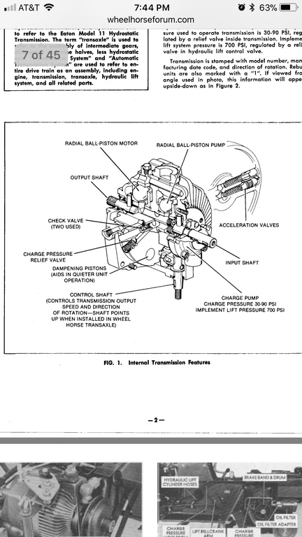

19richie66 17,937 #3 Posted March 11, 2018 (edited) Its the balls in the hydro that pump the oil. Here is the manual for the trans. Edited March 11, 2018 by 19richie66 1 1 Share this post Link to post Share on other sites
