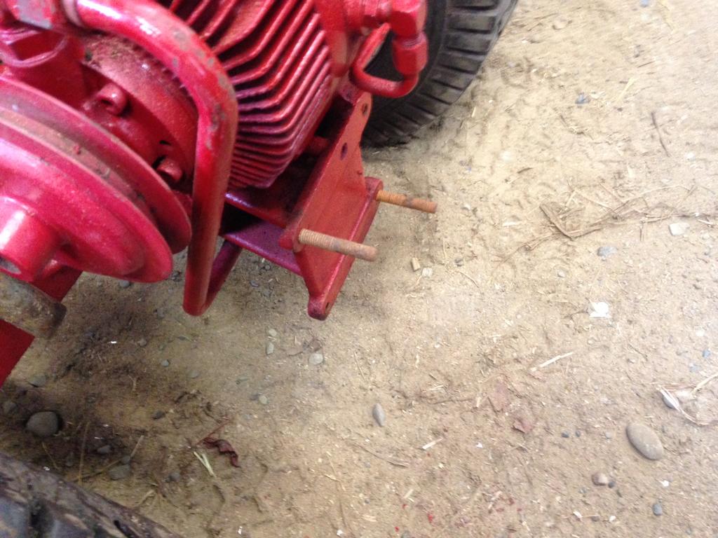

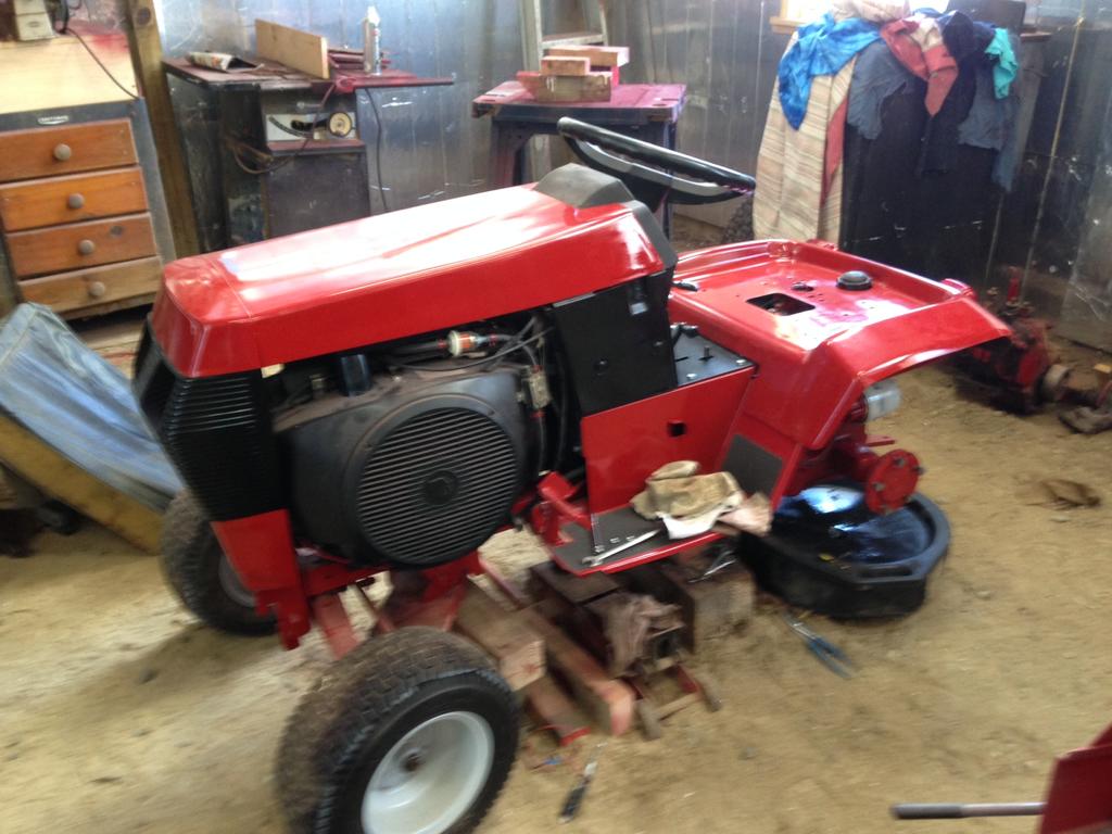

Evil Archer 300 76 #1 Posted March 9, 2018 This Site is great. So many helpful members. I'm going to give back. As far as the Lift rock Shaft I cut 4 1/4" pieces of plate and put them next to the lift mechanism, It gave me somewhere solid to drive against, Using a 1" Brass rod it drove out fairly easy. Next I removed the New Eaton 1100 from the donor Tractor and left the wheels on. Using a 2ft Pipe wrench over the Axle it was very easy to move it around. I put 2 old studs I had in 2 of the Transaxle mounting holes and with my Floor jack under the tractor pretty much rolled it into position, A drop of thread lock on each bolt and it's in there. wheel horse tranny wheel horse 3 Share this post Link to post Share on other sites

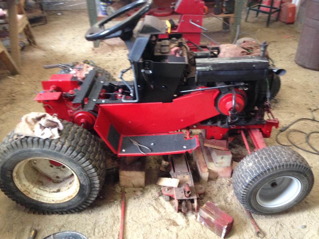

Evil Archer 300 76 #6 Posted March 19, 2018 I'm getting close to a test run. After filling the Transaxle and running it I found the oil very milky. Drained and refilled looked better. A couple more changes and it should clean up nicely. I'm not sure on which set of Decals I want Stock or maybe something custom 1 Share this post Link to post Share on other sites
