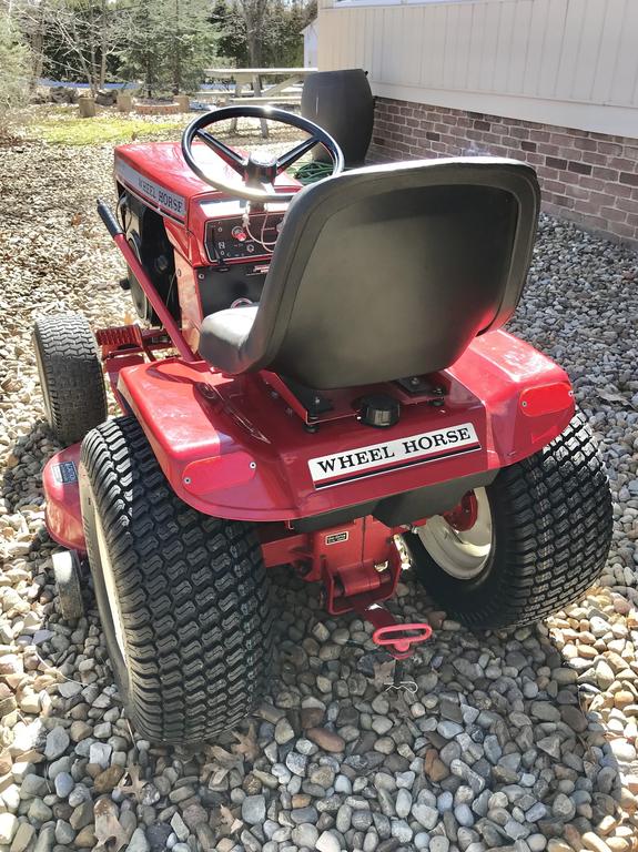

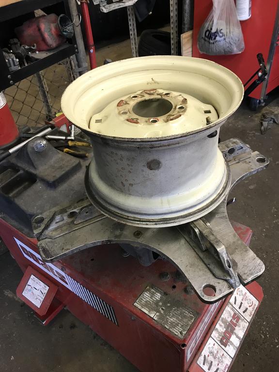

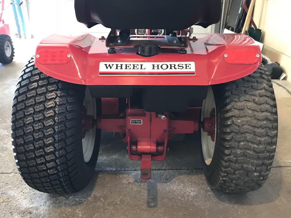

Al C. 1,474 #30 Posted March 25, 2018 Well, a month has gone by - a lot of research and shopping. I settled on a pair of Hi-Run 4-ply Turf Tires 23.5x10.5-12 from Tractor Supply. They were a little pricey - $95/per - but I’m really happy with them. The old tires were 36 year old originals 22.5x7.5-12. Worked a couple hours to change them myself - couldn’t even break the bead. Took them to our local tire place. They did them both in 30 minutes for $20. I want to thank everyone for the advice. Like I said, I am really happy with the outcome! 3 Share this post Link to post Share on other sites
