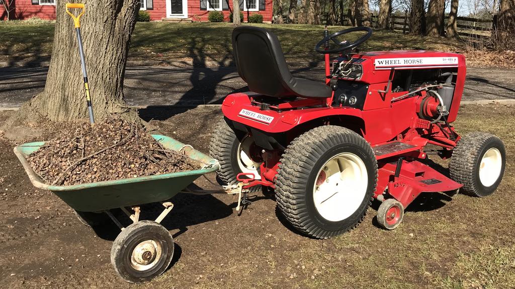

Al C. 1,474 #1 Posted March 1, 2018 Our property is boardered by a hedge of old OSage Orange trees. These trees have thorns that are easily 3/4 inch long and as sharp as needles. Even though I keep the yard clean, every year I manage to pickup one or two of the penetrating menaces in my tractor tires. It’s time for me to replace the 35 year old rear tires on my SK486. The original tires are 22x9.5. I want to move up to 23x10.5. I’m also interested in tires that are more resistant to the Osage Orange thorns. Are there any ideas of what I should be looking at? Thanks! 8 Share this post Link to post Share on other sites

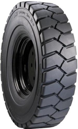

Al C. 1,474 #7 Posted March 1, 2018 Looks like it will do the trick! Very thick because of the wide tread. Who is the Brand/Manufacturer? Share this post Link to post Share on other sites
littleredrider 409 #8 Posted March 1, 2018 That’s a fork lift tire lol, don’t make that in our sizes.... 1 Share this post Link to post Share on other sites
Mike'sHorseBarn 3,683 #9 Posted March 1, 2018 They're pricey, but here is a set of 6ply ags. I definitely like ags better than turf, but it is your personal decision. No right or wrong answer Share this post Link to post Share on other sites

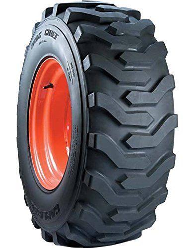

ol550 879 #10 Posted March 1, 2018 (edited) 3 hours ago, Al C. said: Looks like it will do the trick! Very thick because of the wide tread. Who is the Brand/Manufacturer? Carlyle IND TRAX and can get in 23 1050 12 B rating Sorry my tire source had the forklift tire picture instead of the IND TRAX Edited March 1, 2018 by ol550 1 Share this post Link to post Share on other sites
oliver2-44 11,758 #11 Posted March 1, 2018 (edited) checkout "Compact Tractor tires. On the Miller tire site they have a Kendra 23x8.5x12 6ply for $93 this tire style has lugs that extend square to the edges and a wider lug which might protect the edge of the tire a little more I believe this lug design is called an "R4" which is an industrial front end loader style. Edited March 1, 2018 by oliver2-44 Share this post Link to post Share on other sites
ol550 879 #12 Posted March 1, 2018 (edited) This one can be had in 23 850 12 TRAC CHIEF Edited March 1, 2018 by ol550 2 Share this post Link to post Share on other sites
