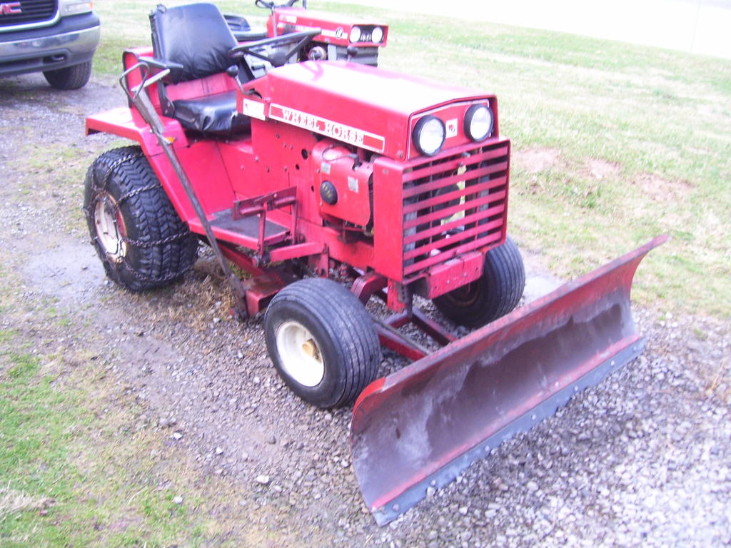

wildbill59 43 #1 Posted February 26, 2018 So I picked up my new-to-me D200s today - what awesome big garden tractors! I've got some general maintenance to do, but after that - the first on my list is to install the belt that runs from the engine to the rear PTO. Problem #1 - from what I can tell, the part # is 103084. When I look it up, I find two different sizes, and from many different sources. Tulsa Engine, Gardner, Ebay, Amazon (I know, the last two aren't great sources of info, but I was surprised to see that they all list two different sizes) - they all say it's 5/8", but they list both 34" and 38". I'm going to put a string around the pulleys to measure, but it seems like 34 is even a bit too long. Any thoughts? Second - these are my first D200s, how do I get that belt on? The PTO clutch has two pulleys, the outboard groove is for the deck - the belt goes from the PTO to the mule drive to the deck. I can figure out how to remove the deck (I mean, I'm a mechanic, I gotta be able to figure that out), and I'll have to remove that belt first, but what about the clutch to rear PTO shaft belt? I don't see an idler, and there's got to take a lot of tension to drive that rear PTO - how do I get that belt on? The tractor that needs the belt is the one in the first pic - it's a 1974, model # 1-0630. Lastly, I found an online owners manual, but it seems pretty generic - it tells me how to change light bulbs and adjust the seat (really?), but not how to remove the deck and replace the belts. I went to the Manuals section, but couldn't find anything - any help would be greatly appreciated! 2 2 1 Share this post Link to post Share on other sites

pacer 3,181 #5 Posted February 26, 2018 DANG!! how you find 2/TWO1 nice looking D's like that -- wow those look sweet! ---- (love my D's) 1 Share this post Link to post Share on other sites
wildbill59 43 #6 Posted February 27, 2018 Qwest, D-man and Sarge - thanks so much for the advice. I talked to the original owner today, he still had the belt, so that took care of that hassle. He says that I should be able to loosen up that front mounted bracket and just roll the belt over the pulley, and then tighten that adjusting nut to tension it back up. We'll see, but if that doesn't work, I'm armed with great diagrams and ideas. And thanks, Pacer - I got 'em from an older gentleman that used them in his orchard for 30-some years. He sold his orchard, and sold me the rest of his equipment! Those big Ds are awesome pieces of equipment. Thanks to you all! 1 Share this post Link to post Share on other sites
