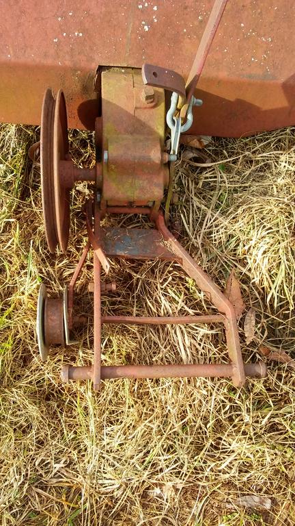

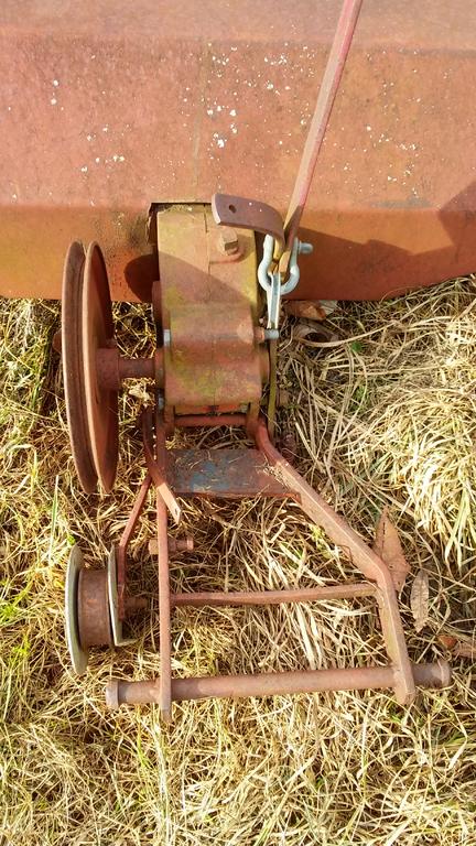

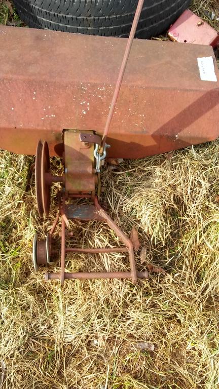

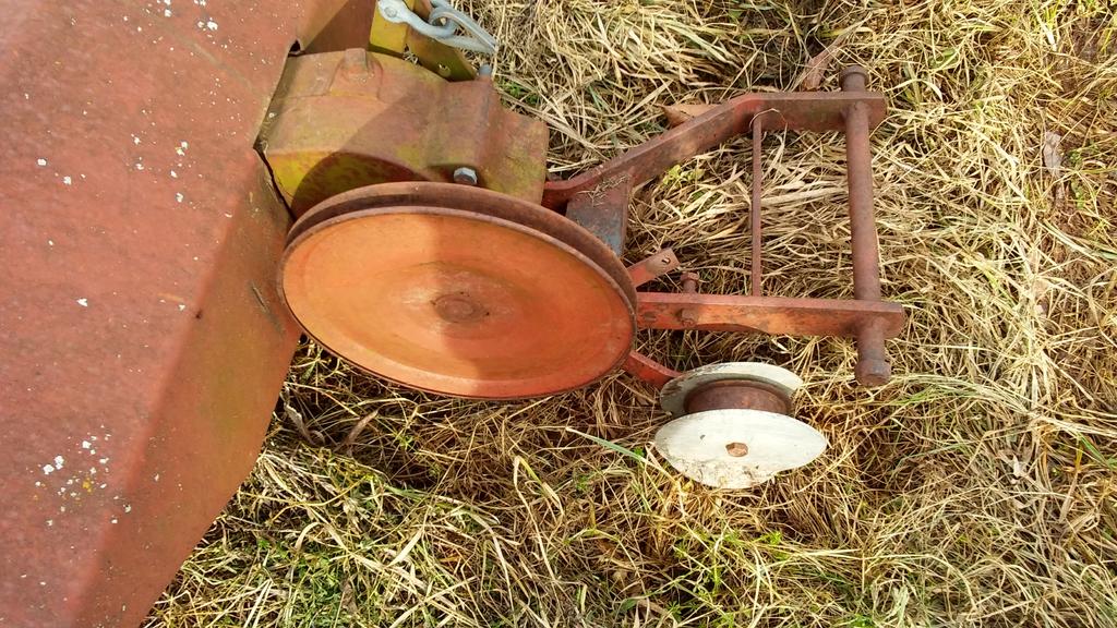

mbn32166 5 #1 Posted February 21, 2018 Can anyone help me identify this tiller?Looking for model number or whatever.Got it couple years ago as package deal with my 312-8 and never had reason to use until the death of my walk behind tiller.Now thoughts of spring are prompting me to hopefully try and get it working.Thanks for any help. Share this post Link to post Share on other sites
gwest_ca-(File Mod) 12,259 #2 Posted February 21, 2018 Here is the first tiller used on the 312-8 models in 1985. Any tiller for the 300-Series that followed will be basically the same. You could have an older model that was adapted to fit the models with the fuel tank under the seat. Some belt idler setups are a bit different. It will be one of these models that are in the order they were produced. 77-36TL01 replaces RT-366, RT-367, 7-1211, 7-1251, 7-1252, 67-36TL01 77-36TL01 replaced by 77-36TL02, 87-36TL01, 97-36TL01, 07-36TL01, 07-36TL02, 07-36TL03, 07-36TL04, 07-36TL05, 79370 Here is a later operator manual for a start If the parts don't match up let us know what the differences are. Garry Share this post Link to post Share on other sites
groundhog47 448 #3 Posted February 21, 2018 The tine shroud and draw bar seem off two different models. Draw bar on older mods doesn't usually have "nubbies" on draw shaft ends. Newer mods usually went to a edge guard on sides of shroud and lifted from shackle flange on shroud and had and had an assist lift spring. Lift mechanics different from any I've seen, but all sorta mods to make it lift easier have been performed. Not necessarily the one that was purchased with the unit either. Very similar to: Tiller 36in 1973-1974 7-1251 OM IPL SN.pdf Manuals section has a "load" of different units under ground engaging implements, but hope one of us steered ya in direction ya wanted/needed. Share this post Link to post Share on other sites
