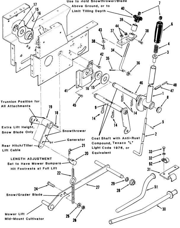

kto434 108 #1 Posted February 19, 2018 I use a 42-inch snow blade with my 312-8. Is there a lift assist spring or kit to help operator’s lift the blade (making it easier to lift)? Thanks. Share this post Link to post Share on other sites
gwest_ca-(File Mod) 12,533 #2 Posted February 19, 2018 No lift assist for the dozer blade but you may have an option to reduce the weight. There are 2 holes in the lift arm you can use. The one closest to the shaft reduces the strain but also reduces the distance it will lift. Rock shaft item 19 hole for all attachments. Garry 1 Share this post Link to post Share on other sites

kto434 108 #4 Posted February 19, 2018 Thanks, I will check the mounting hole and think about the front spring idea too. I had a Gravely rider at one point and Gravely made something called an auxillary lift assist kit which made lifting their heavy 48” blade very easy. I wondered if WH had a similar OEM kit. I have considered swapping manual to electric lift, but cannot seem to find much info on the WH electric lift kit, when it was offered, what models, etc. Thanks again! Share this post Link to post Share on other sites
