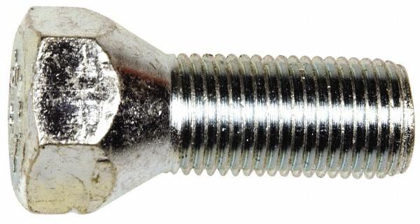

RedRider 120 #1 Posted February 19, 2018 I am trying to find some stainless steel lug bolts for the rear wheels of my Charger 10. According to the parts list the bolts are 7/16-20 thread. I am trying to find bolts that look as close to original as possible, but won't rust like the originals. I thought I remembered someone selling these at the big show last year, but of course I didn't buy any then. I've done some searching on the internet, but so far haven't found anything the right size. I was wondering if anyone has a source for these or has any part numbers I could use to expand my search. Thanks! Share this post Link to post Share on other sites

RedRider 120 #4 Posted February 19, 2018 Thanks for the replies so far. I have seen the conversion kits, but what I was remembering was someone who had sets of stainless lug bolts with the Wheel Horse logo engraved on them (and some without the logo) for a price of around $50 a set. I am looking for the actual lug bolts with the beveled shoulder like in the picture below, the only thing I could find on the McMaster site were the regular style bolts. Share this post Link to post Share on other sites

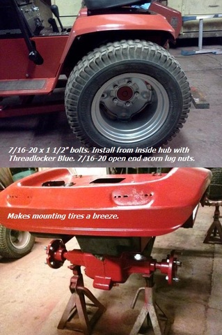

Tankman 3,526 #6 Posted February 19, 2018 Never used stainless lug bolts. I do use lots of stainless hardware, including bolts, nuts, washers, lock washers. Use Never-Seez on all hardware. All at Lowes, excellent hardware section, stainless steel. Always change lug bolts to lug nuts. All my happy working Horses have lug nuts, for years. Threadlocker Blue only on the threads that'll live in the hub, 7/16-20 x 1 1/2" long. Open ended acorn lug nuts on the shelf at most auto stores. Some might query the acorn angle, always used off the shelf lug nuts. Never looked or asked. Always worked great. 4 Share this post Link to post Share on other sites
