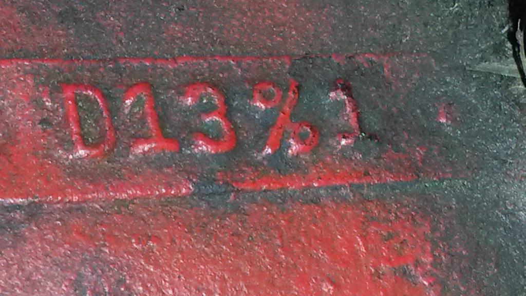

Chris G 3,369 #1 Posted February 17, 2018 (edited) I started tearing down my 401 today and was kinda curious about the serial tag on the transaxle. I never have seen one with a % sign in the serial number tag. Just wondering if anyone else has came across this and if so what's the breakdown of the tag numbers. Edited February 17, 2018 by Chris G 2 Share this post Link to post Share on other sites
953 nut 64,277 #2 Posted February 18, 2018 I don't know but bet @stevasaurus will know. 1 Share this post Link to post Share on other sites
stevasaurus 23,620 #3 Posted February 18, 2018 It is not a serial number...it is a casting date. D13%1 equates to D = 4th month = April. 13 is the day. the 1 after the % = the year 1961 So your transmission case halves were cast on April 13, 1961. Note they did not use the letter "I', they skipped it...so "J" would be September 2 2 1 Share this post Link to post Share on other sites

953 nut 64,277 #6 Posted February 18, 2018 3 hours ago, stevasaurus said: It is not a serial number...it is a casting date. D13%1 equates to D = 4th month = April. 13 is the day. the 1 after the % = the year 1961 So your transmission case halves were cast on April 13, 1961. Note they did not use the letter "I', they skipped it...so "J" would be September I knew Steve would have the answer! 2 Share this post Link to post Share on other sites
