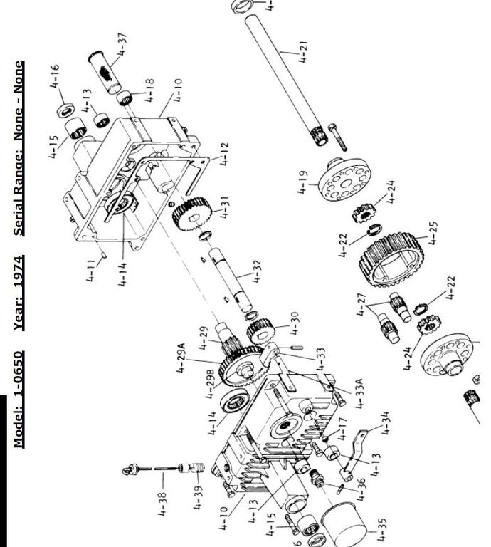

eddiebunyan 24 #1 Posted February 16, 2018 My auto-18 transaxle needed to be rebuilt and I bought a 1532 needle bearing off of e-bay because it was the only needle bearing that was bad in the half case.The one I pressed out was crushed on the inside of the bearing causing the needles to not turn.When I pressed in the new supposidly 1532 bearing i noticed that if I kept it flush to the outside(Pump side) it was about a 1/8 too far to the inside case??Odd!I put everything back together and found that I had a fluid leak!As I ran it I would tighten the four bolts that held the pump to the housing,but the leak got worse.I took it apart and found that the needle bearing had forced it's way motor side and thus i couldn't keep the pump from leaking.I suppose the guy just had a number that he thought was good!!But now The guy can't be reached????Just food for thought if your going this route!Does anybody know where I can get an authentic 1532 cap needle bearing?? Share this post Link to post Share on other sites
pfrederi 19,820 #2 Posted February 16, 2018 (edited) Need to clear a couple things up. You say pump to the housing...did you mean hydro motor?? You have a separated system. The motor attaches to the transaxle. Which bearing is messed up in the picture here? (I hope it isn't 4-18) Is it on the hydro motor end of 4-32 the "gear Shaft" EDIT: The broken bearing was it open or closed on one end????? Edited February 16, 2018 by pfrederi 2 Share this post Link to post Share on other sites
"D"- Man 827 #3 Posted February 16, 2018 (edited) There are a total of (3) 1532 needle bearings in the transaxle, these would be the ones in your diagram Item # 4-13 two on the oil filter side and 1 on the motor side. This is the bearing # that was on the transaxles that I have. #1532 is the middle bearing on this side. Edited February 16, 2018 by "D"- Man 1 Share this post Link to post Share on other sites
pfrederi 19,820 #4 Posted February 17, 2018 If it is the bearing to the left (towards the front of the Transaxle it is a 8049 bearing. That is a problem, the 1532 bearings are 3/4" thick...the 8049 only 5/8" thick (hence maybe the 1/8" mentioned in the original post. Stevasaurus found a 5/8 inch bearing but it was open.. i have never found a closed end bearing that thick. Took one to Motion industries they couldn't find a replacement.... If the gasket was perfect and maybe used some sealant do you think an open ended bearing could work??? The thought of sealant on a hydro worries me but if there is no other choice????? Share this post Link to post Share on other sites

groundhog47 446 #6 Posted February 17, 2018 (edited) Eddie, I have inquired to a supplier who claims in stock M-16101 Koyo bearing, is in China and online see the Torrington M-16101 for sale in Euros ?? pice that is 29 to 33 Euros. Hope to hear a good price on the Koyo. Know you want the 1532, other than M-16121, but it seems none avail WH or Torrington. Will post ya a message on reply if get one. The Koyo dimensions fit what Paul posted on the 8049 front motor side closed bearing. Last resort option: machine shop grind 1/8" off 4-32 shaft on motor side and minimal radius edges of shaft, unless gear face rides on bearing edge. Edited February 17, 2018 by groundhog47 clarification and last resort option Share this post Link to post Share on other sites
stevasaurus 23,581 #7 Posted February 17, 2018 It does seem like we went through this before. The #1532 bearing and the M-16121 bearing are one and the same...ie...a cap bearing that is 16/16" or 1" ID and 12/16" or 3/4" wide. I think we were looking for a bearing that is 1" ID and 5/8" wide. If there is such a thing, Gerry is right...it would be M-16101. didn't we wonder if we could go with a bearing that is 1/2" wide?? That would be M-16081. Torrington and KOYO numbers are the same. Eddie, measure that 1532 bearing you bought...it should be 3/4" wide. Here is that other thread:: http://www.wheelhorseforum.com/topic/72296-bearing-suggestions-needed/?tab=comments#comment-687558 2 Share this post Link to post Share on other sites

eddiebunyan 24 #9 Posted February 18, 2018 Sorry for the confusion,The cap bearingis4-13(1532) That holds the end(pump side) of 4-29 The upper right one in the picture above, showing the pump mounting face.I bought a half case off of e-bay and that bearing that I pressed out was crushed on the inside .I thought maybe the person had tried to press it out from the inside and just crushed the face of it but now I'm thinking perhaps he ran into the same problem on a previous rebuild.When he bolted everything together tight,perhaps it crushed the inside of the bearing which would cause the bearing to fail?I thought about machining the excess off but didn't want to go that route.I still have my old case and since the piece blew off in one piece,I had it welded back on for a "spare". the 1532 bearing's in that half still functioned,so I thought if I could't get one I would use one of those even though they were"used"and I know I'm making some of your shiver because "you would never use ,used parts!!"Thanks for all the responce! Does anyone know why they used a allen head bolt on the rear left of the manifold,as shown in fig.31(page 29) of the auto repair manual??I'm assuming for clearance? 1 Share this post Link to post Share on other sites
