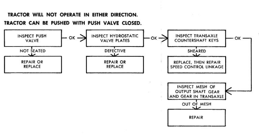

953 nut 67,654 #2 Posted February 13, 2018 Based on the conditions I would take a look at both wheel hubs on the axles. If the key has broken on either one it will bring you to an abrupt halt. The Sundstrand manual has a troubleshooting guide. If it isn't a hub the chart may help. Sunstrand Hydro (part 1).pdf Sunstrand Hydro (part 2).pdf Sunstrand Hydro (part 3).pdf Sunstrand Hydro (part 4).pdf 2 Share this post Link to post Share on other sites

Carts2Wheels 1 #4 Posted February 13, 2018 No Hydro Lift, all manual other than the transmission (which keeps my 10 year old from doing the plowing HAHAHA!) 20 minutes ago, 953 nut said: Based on the conditions I would take a look at both wheel hubs on the axles. If the key has broken on either one it will bring you to an abrupt halt. The Sundstrand manual has a troubleshooting guide. If it isn't a hub the chart may help. Sunstrand Hydro (part 1).pdf Sunstrand Hydro (part 2).pdf Sunstrand Hydro (part 3).pdf Sunstrand Hydro (part 4).pdf Thank you! 1 Share this post Link to post Share on other sites

pfrederi 20,924 #7 Posted February 13, 2018 I am afraid you may have to open her up. Check the hub and input shaft keys. To check hubs mark from the axle to the hub then try driving if the marks stay in line the hub keys are ok. Watch that the pump input shaft spins with the pulley. If they are OK next most likely from the Manual is transaxle cross shaft keys... Assuming she had been running OK right up to then argues against the valve plates failing. They get scratched and leak but the onset is fairly slow. 1 Share this post Link to post Share on other sites
