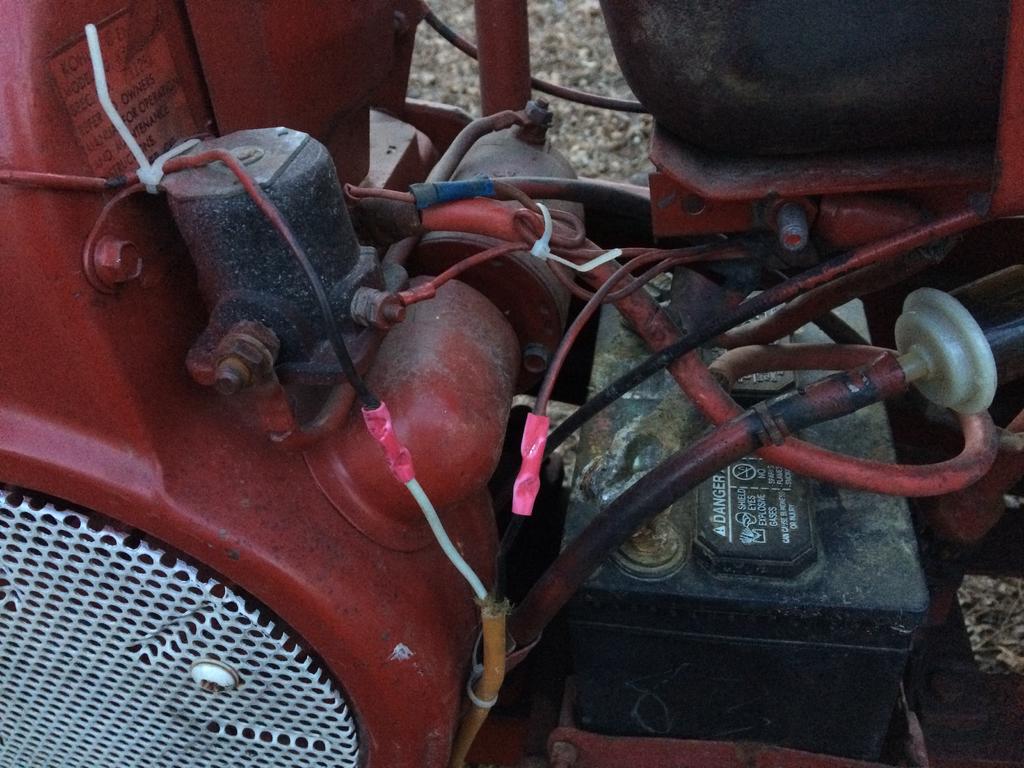

953 nut 63,986 #3 Posted February 12, 2018 (edited) Is this rant about the previous owner and the weather the one you are referring to? I have read it a couple of times and don't see an answerable question. On previous occasions you have asked questions and received answers, ask a direct question and we will continue to provide information. We are a very friendly, helpful group and welcome honest feedback if we go astray, but you seem to be having a bad day, hope it gets better. "well guys here i am again ;i was wondering if the safety pedal switch are the same on either a standard or automatic as i am rewiring this horse as it seems someone spliced an extension cord from the plus side of the coil than to the key switch ;than to the back where the seat switch is which there is no switch there ;what a mess really ;so during the rewiring i think having the switch working it might help to start this oldie 'it has been darn cold here and freezing rain so i can't get outside to work on it ;boy i wish for spring as the walls keep getting closer ; as you can see in the picture how is this going to start the motor or am i missing something here ; sad news as yesterday i hit the 68 mark but heck that is just a number in life ;have a great day everyone enjoy your toys as i do" Edited February 12, 2018 by 953 nut 2 Share this post Link to post Share on other sites
upstate yank 219 #4 Posted February 12, 2018 (edited) 5 hours ago, Sarge said: ....Huh ??? Not exactly sure what that's suppose to mean - far as I could tell the question was answered. The mess of the wiring in that post meant the thing really needed to be re-wired from scratch, far too many potential issues and the diagram provided would help with that. No reason to route the coil power through a safety switch or otherwise, the normal interrupt circuit is the starting relay trigger wire and safety switches on most small engine equipment. Not sure if that was intended as sarcasm or what - post counts mean nothing as not everyone knows electrical parts/systems. Sarge it didn't mean anything and thanks for the diagram ;i just wanted to ask one question about the switch as again the seller used an extension cord and the 2 wires that are tied in one comes for the plus side of the coil and the other goes to the key switch ;as you can see in the picture i thought if i had the pedal switch thinking that maybe one of those wires were for the switch as i have checked the evil bay and one seller told me the one he has will not work on the automatic so i did searching and found out it will work on either so to make sure yes i did post the question here to see if the seller was right or wrong ;really that is all i asked ;but again if some think i am rude sorry as i am not ; Edited February 13, 2018 by nylyon Language removed, please no personal attacks or colorful language. 1 Share this post Link to post Share on other sites

Sarge 3,470 #6 Posted February 13, 2018 Just tyi - being a '73 no-name model (16 Automatic) means nearly ever part is the same as '74 and later C models - if you didn't know it would be confusing. I have a 16 Auto here myself and love it - most of it was re-wired when I redid the tractor for a brother in law. It's back here now as he got a zero turn, understandable for his property and I'm glad the Horse came home - it's one of the highest sought models by our members here. Other than the hydro direction control handle there is almost no difference between this model and a '74 C-160 and I converted mine away from that handle being between your legs to the older/newer style - I hated it . When I redid this one I deleted the safety switches as every one of them was shot or rotted out from age/wear. It was a choice and that's up to you. Your coil needs power off the ignition terminal on the key switch directly first . The safety switches are wired between the start position on the key switch and the starter solenoid mounted on the engine tin. That's basically all there is to it . You would be well served to inspect the key switch and make sure it's the correct one for the tractor - can't ever assume that over the course of 45yrs it hasn't been changed or is bad. There are simple tests you can do to test one and almost all are labeled on the back of the switch. Folks here can identify them with one good clear picture and go from there. As I said , start with the manual or use Bob's colored diagrams for the C series and the basic system, then go from there and ask any questions you come across. If the safety switch you were asking about was for a non-automatic it's due to the way they are mounted, the contact arm or similar. Some are still available, look in the manual at the parts list and get the part number then search it out on the 'net - may or may not be available new. We also have several used parts vendors here as well that are very helpful and reasonable. Ebay can be a problem as many of these parts are either junk or they have no idea what the part is - so take their listings with a grain of salt. Sarge 1 Share this post Link to post Share on other sites
upstate yank 219 #7 Posted April 11, 2018 thanks so much for the advise from everyone; the thing is i was able to get it to run but only adding a wire from the plus side of the coil to the plus side of the battery and after a little bit of gas in the carb the old girl took off but due to linkage not being adjusted correctly boy did the motor race so i had to be fast and shut it down as i would had a motor in pieces but heck at least it ran even for a short term 'and then i did figure out the wiring that the previous owner did with that extension cord ' 'but due to all of the negative replies from other groups stating this horse is not a no name and others said it was ; or have a smart mouth from this group' state the problem then why didn't he explain it other then to be a smart ass know it all of nothing;so i sold it for double plus then what i gave ;so i will take the lost of a 100 bucks and find another one yes i will say i am not the best when it comes to electrical even though years have passed when i did this for a hobby but after time and age we seem to forget simple things .my worst mistake was selling the herd i had and going over the road for close to 40 years as i had a family that depended on me to have a roof over there heads and meals on the table where the 6 horses i had couldn't do it ;so now after retiring and at the age of 68 i would so much like to get back in to it 'as it is now really my favorite is my charger 10 automatic and the b-80 'again if i did sound rude that was not my intent ;and i am truly sorry as i did get quite upset of the one person from this group and a few other groups who had a smart remark 'again i am deeply sorry' i will continue to read the posts but will never again ask any questions 1 Share this post Link to post Share on other sites
