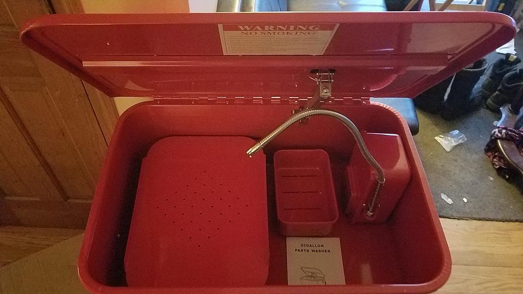

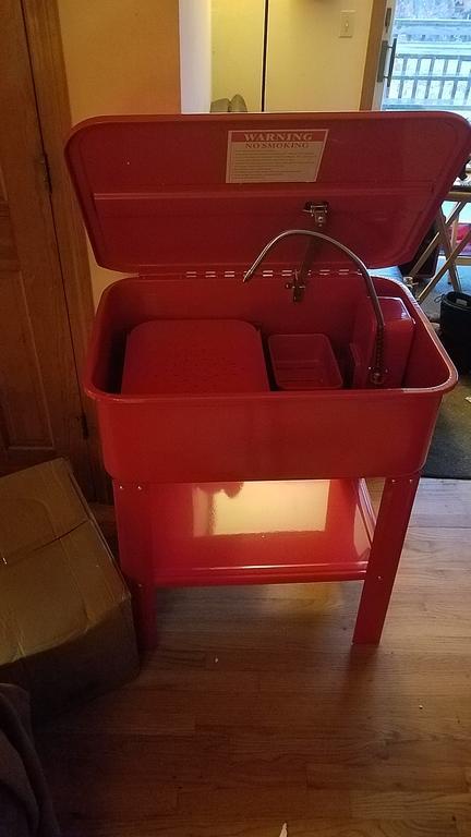

Docwheelhorse 2,983 #1 Posted February 11, 2018 Hello all, After nearly 35 years of using buckets and what not-- I invested... I finally picked up a parts washer. Yep its Chinese... yep the bolts only kinda line up... yep the lid closes but not squarely. BUT... it was $99 delivered to the house and is gonna be real nice to have around. So, do I fill it with Kerosene? Diesel? Simple Green---dont like idea it will freeze. Yes the wife let me bolt together in front of TV. Tony 7 1 Share this post Link to post Share on other sites

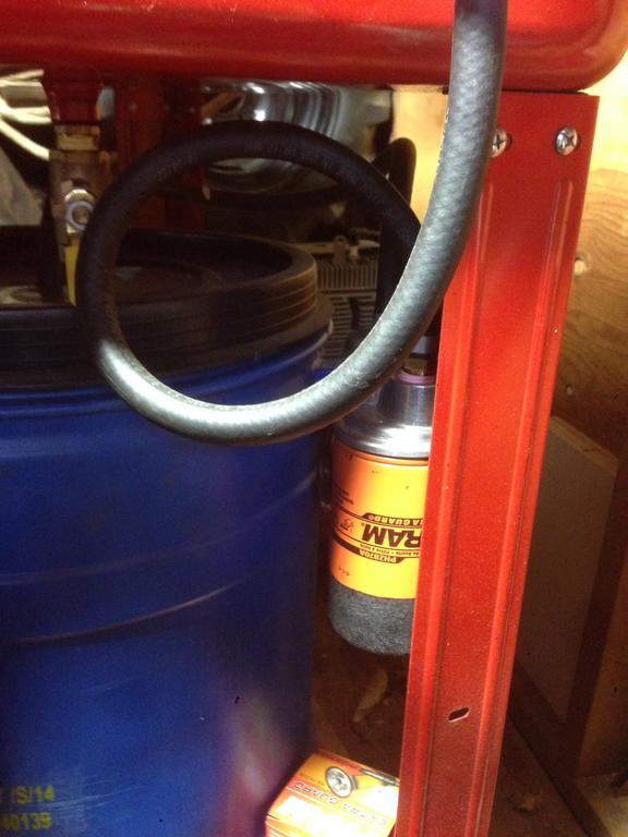

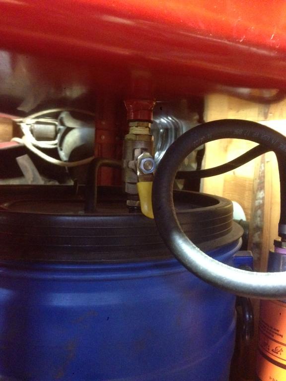

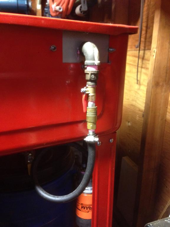

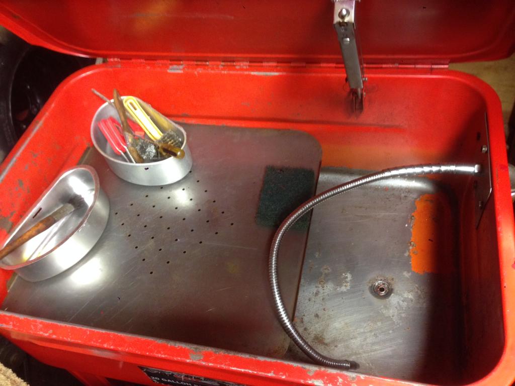

formariz 12,379 #21 Posted February 16, 2018 (edited) A few years back i bought an used one that pump was shot.Upon doing research on pumps and how to improve it, here is what I came up with, and it has worked flawlessly for years. I use Kerosene with a bit of water mixed in. I use a drum underneath it as the reservoir .Fluid drains to drum and its pumped back into it with a fuel submersible Little Giant pump. It is filtered on its way up to tank using an auto filter. When not in use after a while the heavier water helps push dirt and sediment to bottom where it stays. Pump is set above the water level in the kerosene. I can after a few days as needed shut the drain valve from the top tank and pump the clean kerosene into it. I then clean the bottom drum of the dirty water with all of the sludge, add another gallon of water and let the kerosene back down to normal re circulation. Drum has roughly 9 gallons of kerosene and one gallon of water. The fact that top container is continuously draining allows me to use entire tank for cleaning without item being submerged in fluid.Not having the pump in there also increases work space. I have now used the same kerosene for about 4 years with just a little replenishment once in a while. Pump was a bit expensive but it is nearly indestructible with plenty of pressure. I can also adjust pressure by partially closing valve into the tank. Edited February 16, 2018 by formariz 4 1 3 Share this post Link to post Share on other sites
pfrederi 20,756 #22 Posted February 16, 2018 Nice idea...how long does your filter last...I clean some nasty stuff.... Share this post Link to post Share on other sites
formariz 12,379 #23 Posted February 16, 2018 23 minutes ago, pfrederi said: Nice idea...how long does your filter last...I clean some nasty stuff.... Sometimes they last a while and other times they are done with one cleaning. I am always looking for stuff and when I first set it up there was a guy on eBay selling literally a ton of these filters for peanuts, so I took the opportunity and bought them all. I think I have enough to last for the next 20 years. Share this post Link to post Share on other sites
953 nut 66,861 #24 Posted February 16, 2018 38 minutes ago, pfrederi said: Nice idea...how long does your filter last...I clean some nasty stuff.... I just slip an old sock over the pump, incredible how much it will pick up. Share this post Link to post Share on other sites
formariz 12,379 #25 Posted February 16, 2018 Since my pump is inside drum it would clog frequently and it would be very inconvenient to remove it from drum to clear it. This way I just shut valves and spin filter out. Pump itself is always clear. Share this post Link to post Share on other sites
