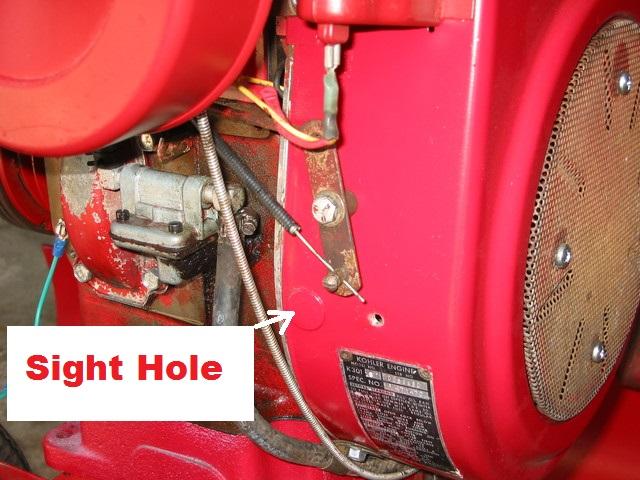

953 nut 67,509 #4 Posted February 11, 2018 If you don't have the little peep hole for timing the engine tins may need to be removed. On older engines the marks would probably need to be cleaned up to be seen. Kohler static_timing.pdf 5 Share this post Link to post Share on other sites

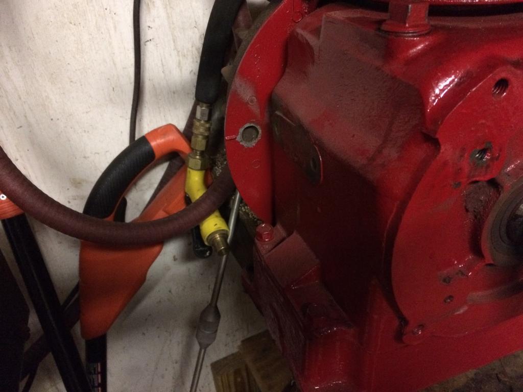

squonk 47,431 #5 Posted February 11, 2018 On the 60's K's at least on my old K301 the sight hole is on the back of the engine. 1 1 Share this post Link to post Share on other sites
