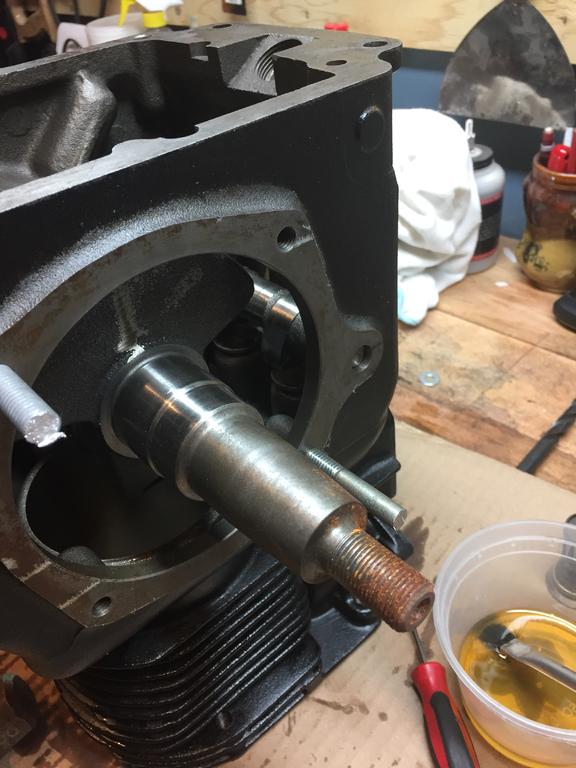

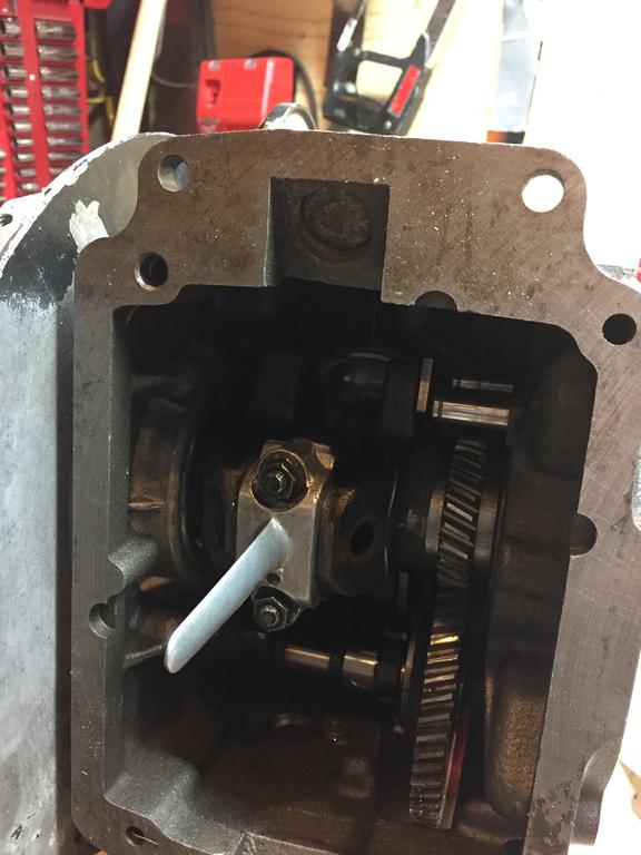

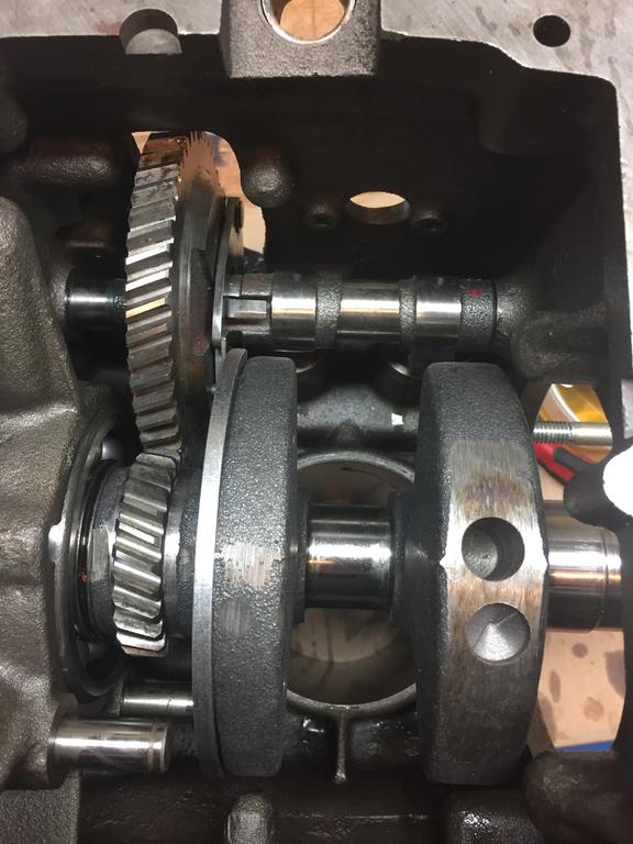

Forest Road 595 #1 Posted February 10, 2018 Finally! This block and parts have been lying around for over 2 years. I had it cut .010 and the valves cut. The crank was balanced w David Kirk's kit and I own his last cheater cam. I had planned to do a hot rod k341. Ordered all the necessary hardware, Bosch coil, pointsaver, electric fuel pump. After a little research I found out how easy it should be to turn it into a Magnum. So here we go. Started assembly last night w a new governor gear. Opted to install the original cam, Kirks will be up for sale, got to the bearing plate and found out I need Magnum seals and shims. So we're in a holding pattern until the seals arrive later this week. Any tips or suggestions gladly accepted. Also so this blocks dipstick was in bottom of the block. I have a cub cadet timing cover dip stick I plan on using. 5 1 Share this post Link to post Share on other sites

bigmarc66 29 #5 Posted February 16, 2018 i actually just finished this same process last month. I have a walker mower that popped the magnum 16. The magnums 16s are like a unicorn to find, so I got a K341, bored it from age, and swapped it all over. Using some advice via gardentractor pulling tips, i didnt use the balancer gears because like he said, they explode and this is what did my magnum 16 in. I also had to cut down the block where oil pan mounted to make it a narrow base. All in all, it worked out well. 1 2 Share this post Link to post Share on other sites

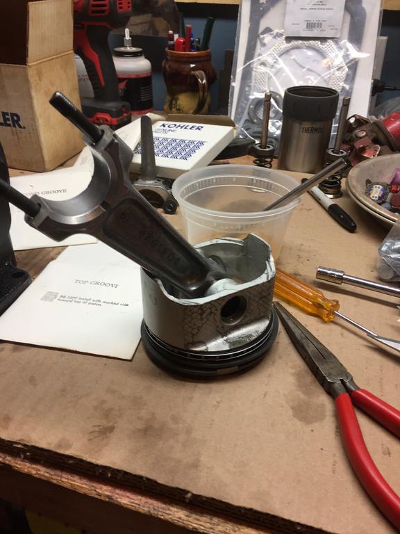

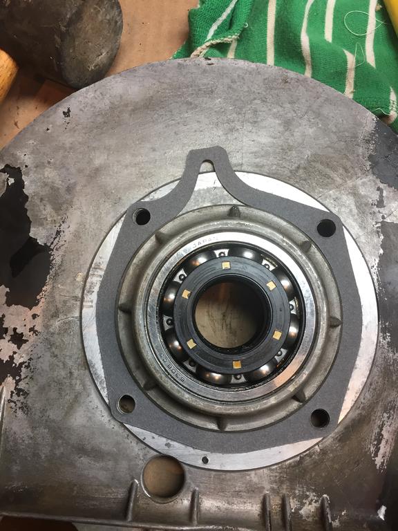

Forest Road 595 #6 Posted February 22, 2018 First and last time ordering from Parts tree! After a week I received an email stating they had part of my order. No thank you! Called I Save Tractors in Maine. I had factory Kohler Bearing Plate seals within 2 days. Guess where I’ll be ordering from now on? The crank, rod, and piston are all in. Decided to paint the oil pan so we’re in a holding pattern again. Amazing how 2 years of waiting hasn’t sped up my schedule in the least. 3 Share this post Link to post Share on other sites
