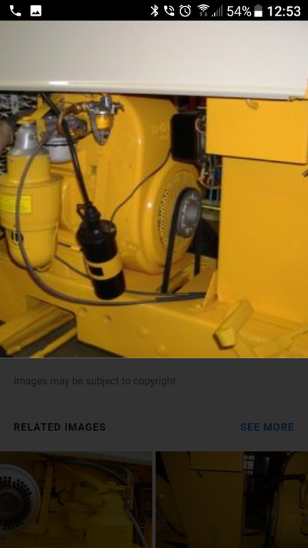

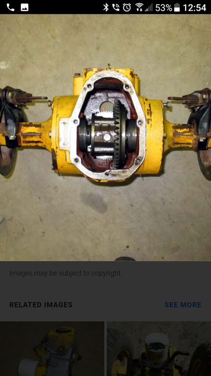

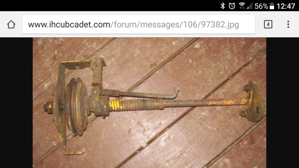

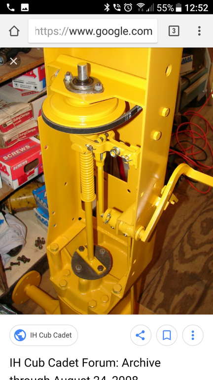

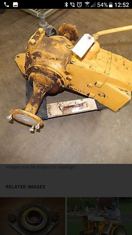

WVHillbilly520H 10,378 #14 Posted February 9, 2018 SewThe older (original cast iron) Cub Cadet transaxle is the very same one found in the IH Farmall CUB from the late 40s on just shortened axles/housings if it could handle the abuse of actual row cropping many acres with bigger tires and loads why wouldn't it work on a smaller scale sled puller, also another fun fact the CC ORIGINAL actually used a short belt from the crank pulley to the "clutch" that coupled to the drive shaft and our old 8hp Kolher belt did "slip" quite a bit pushing/pulling heavy loads in 2cd or 3rd gear take off about 40 years ago not that I was "hot rodding" it or anything way back when 2 1 1 Share this post Link to post Share on other sites
Michael Thompson 39 #15 Posted February 9, 2018 How does the WH transaxle compare with the others for strength? Share this post Link to post Share on other sites
