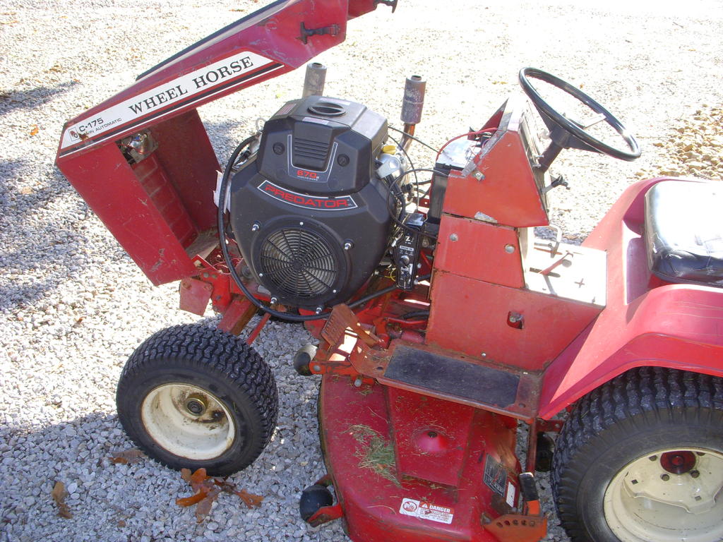

T-Mo-(Moderator) 5,005 #3 Posted February 8, 2018 @Bowtieguy, a member here repowered his C-175 with a 22 hp Predator engine from Harbor Freight. 6 1 Share this post Link to post Share on other sites

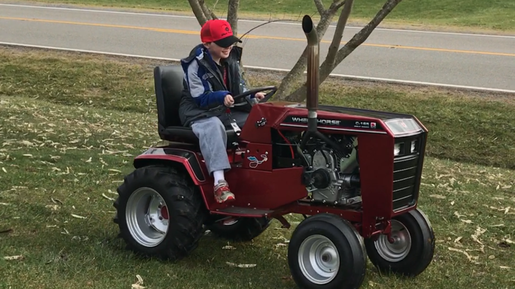

dells68 7,499 #5 Posted February 9, 2018 Those Harbor Freight 22's are nasty!!! Emory loves his and it sounds down right mean! 1 5 Share this post Link to post Share on other sites
